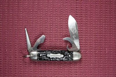

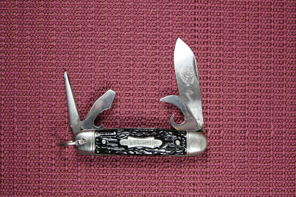

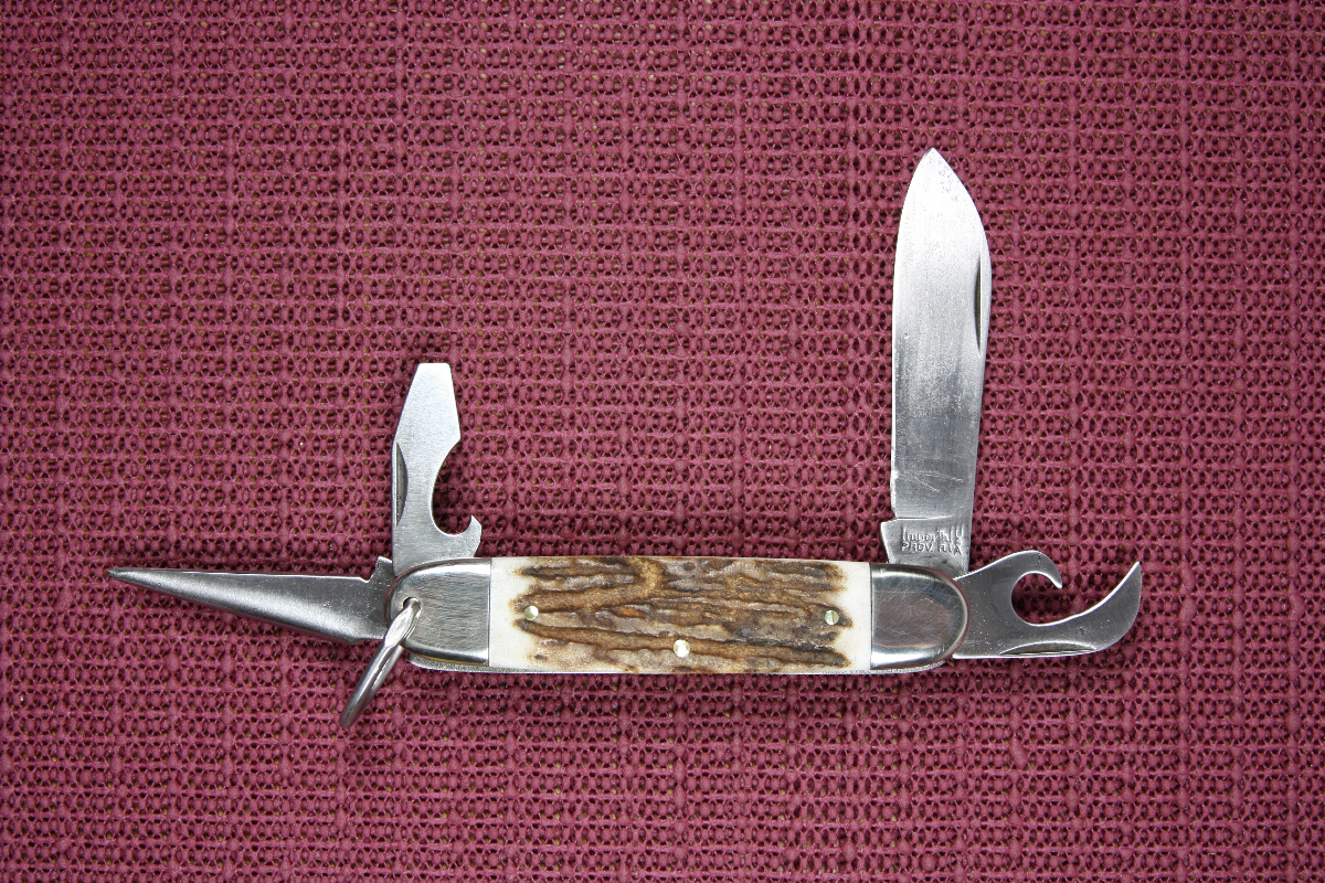

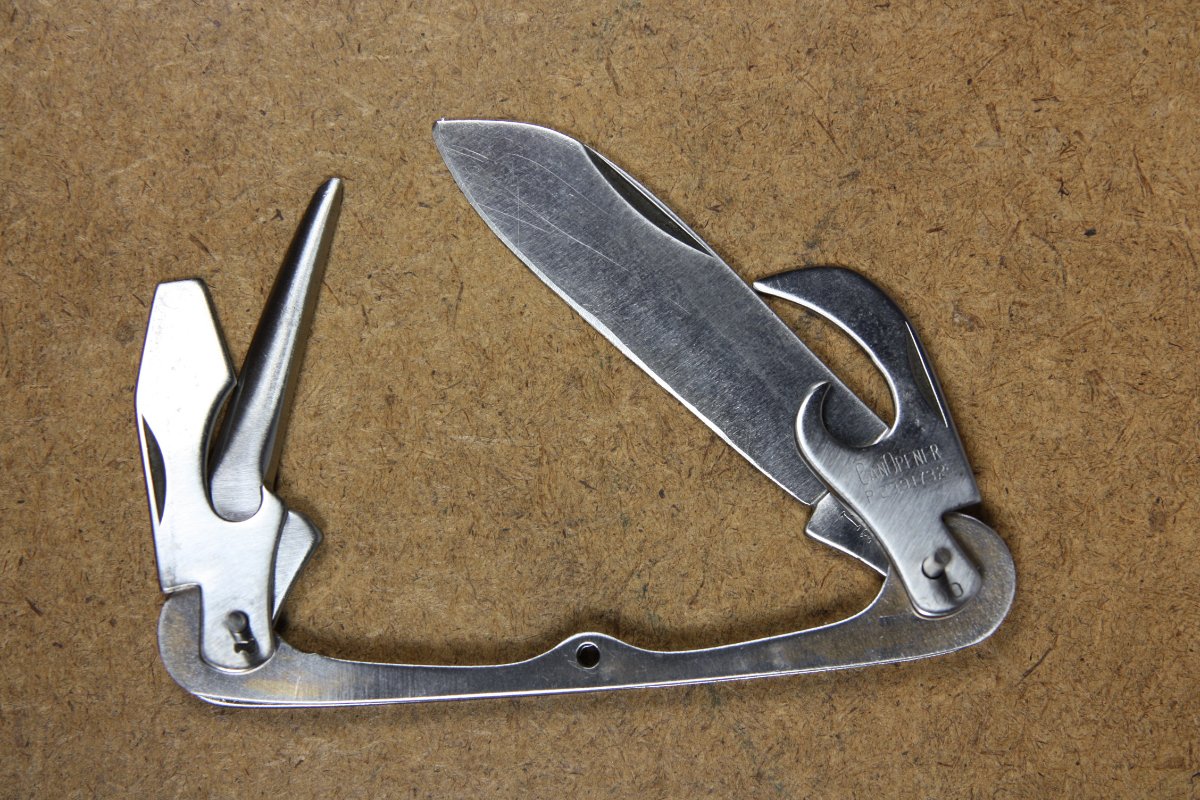

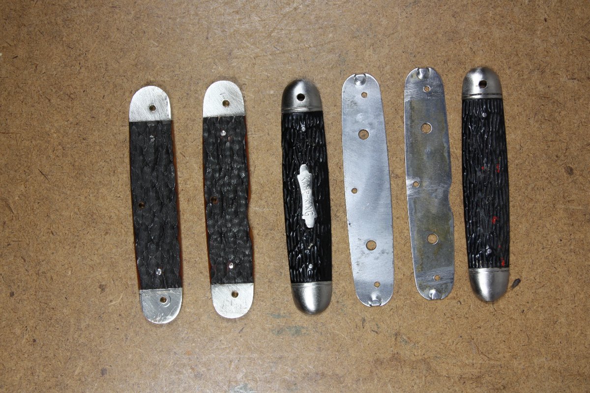

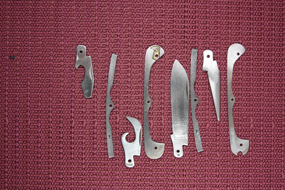

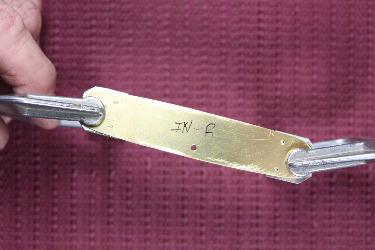

The first real knife mom would let me have was a Kamp King back in the day, so I have always had a soft spot in my heart (head) for them. I have customized a few and this is the latest conversion from the shell handled original. I used the original blades, springs, and inner divider and spacer. New brass liners, nickle silver bolsters, and handle material was added.

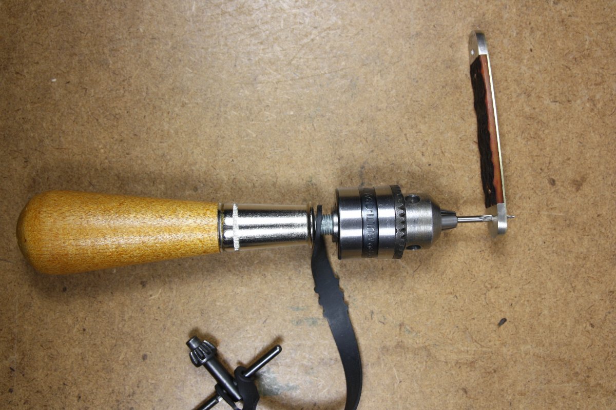

Drilling the new brass liners with the old steel one as a template.

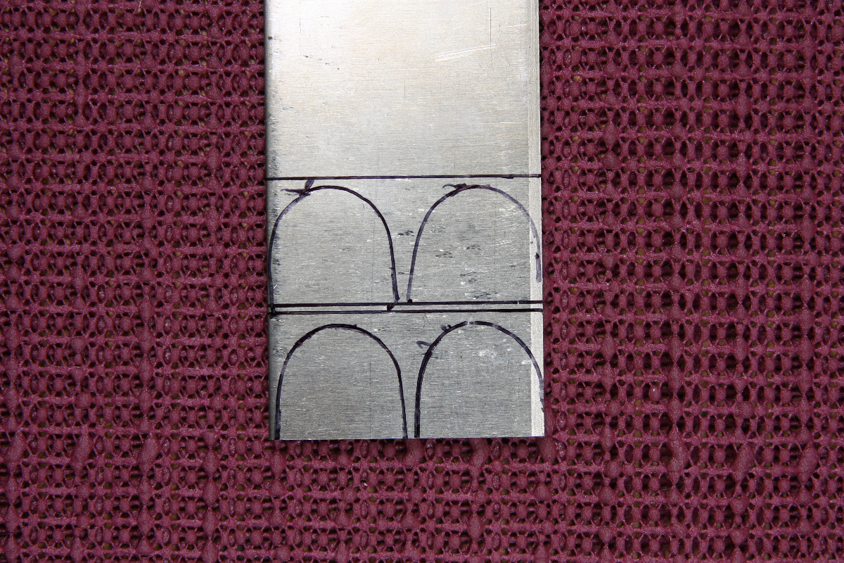

1/8" nickle silver for the bolsters

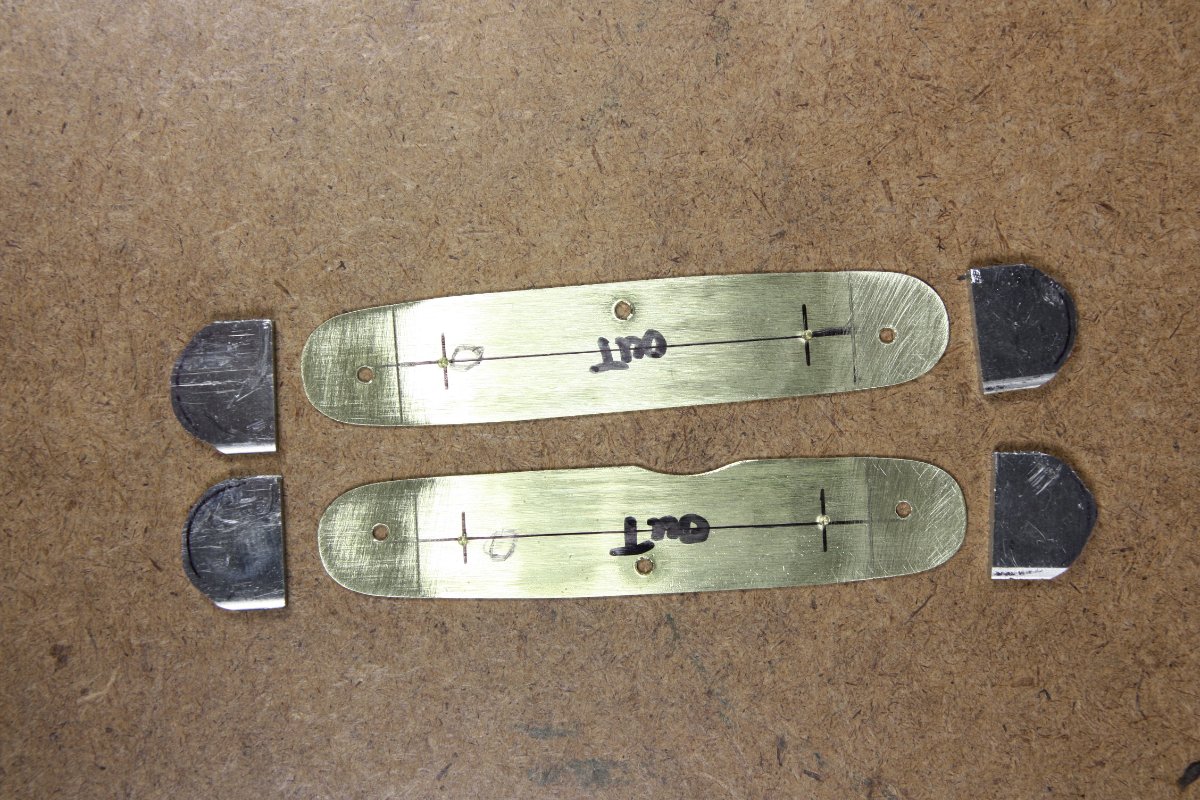

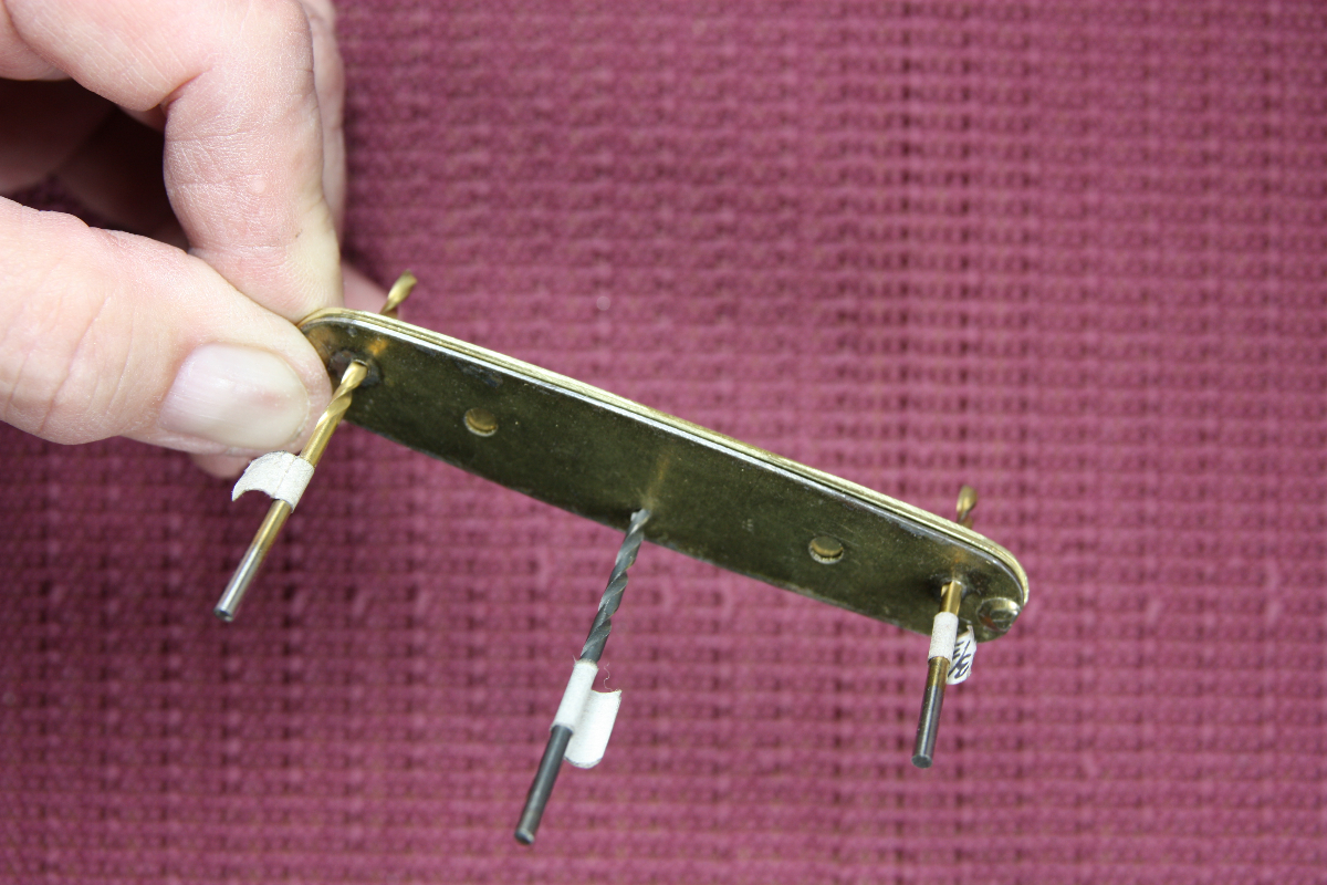

When I do these, I silver solder the bolsters onto the new brass liners after first drilling two 1/16" holes from inside the liner half way through the bolster to make two "posts" of silver solder. I have done some wood handled ones and a Kirinite Patriot one with brass bolsters, but I wanted to do this one in stag.
Before Finished I know what you are saying, even if you put a tuxedo on a pig, it is still just a pig. LOL

In the 4th picture you can see that when I solder the bolsters on, at that point they are a little oversize. I put a center line with a fine point sharpie on the outside of the liner and mark a square line from that centerline to square up the bolsters. I clamp the bolsters to the liners and drill the two 1/16" holes for the silver solder "posts". Then to solder them on, with the inside of the liner facing up, and the pieces still clamped together, just wave the propane torch underneath carefully until you can touch the solder to the metal and have it melt and flow into the holes. After soldering, the bolsters can be taken down to match the liners with the disc or belt sander, and the pin holes drilled. I also use this "post" method to repair bolsters that have come apart from the liners. I am working on an old Boker that had nickle silver bolsters spot welded to nickle silver liners. One of the spot welds failed and the bolster came off. After taking the knife apart for a rebuild, I fixed it with the soldered post method. It seems to be very solid, especially after the pins are re riveted.just bob wrote:That is great work. When you get time why not make a soldering tutorial. It would be greatly appreciated. That is a great idea to make soldering posts. Getting those bolsters on and getting them straight is not as easy as you make it seem.
Make sure to degrease the metal parts with acetone or similar before soldering.

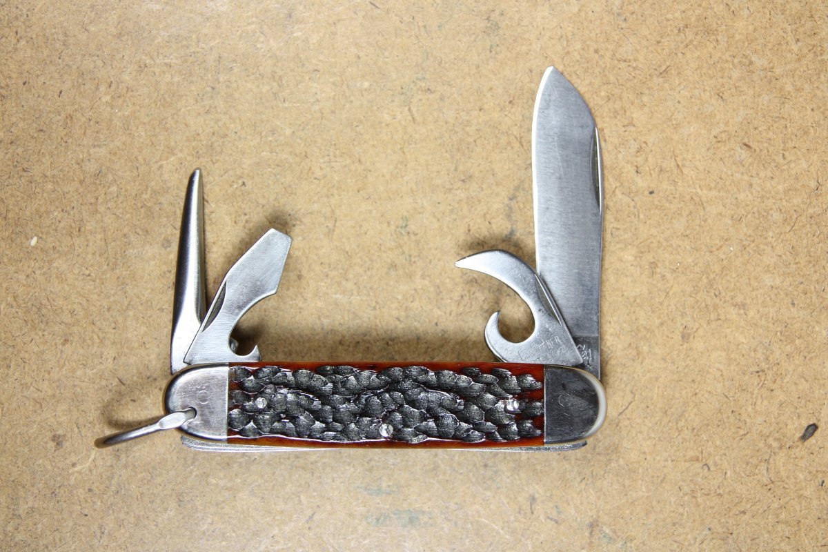

Yet another Kamp King conversion I have done recently. This one has Culpepper Amber Richmond bone handles. As usual, the shell handles and steel liners are removed and discarded after using one of the liners as a drill template. Bolsters soldered on using the post method shown above.
New .032" brass liners and 1/8" nickel silver bolsters
Taper reaming the pin holes
New parts to replace old parts

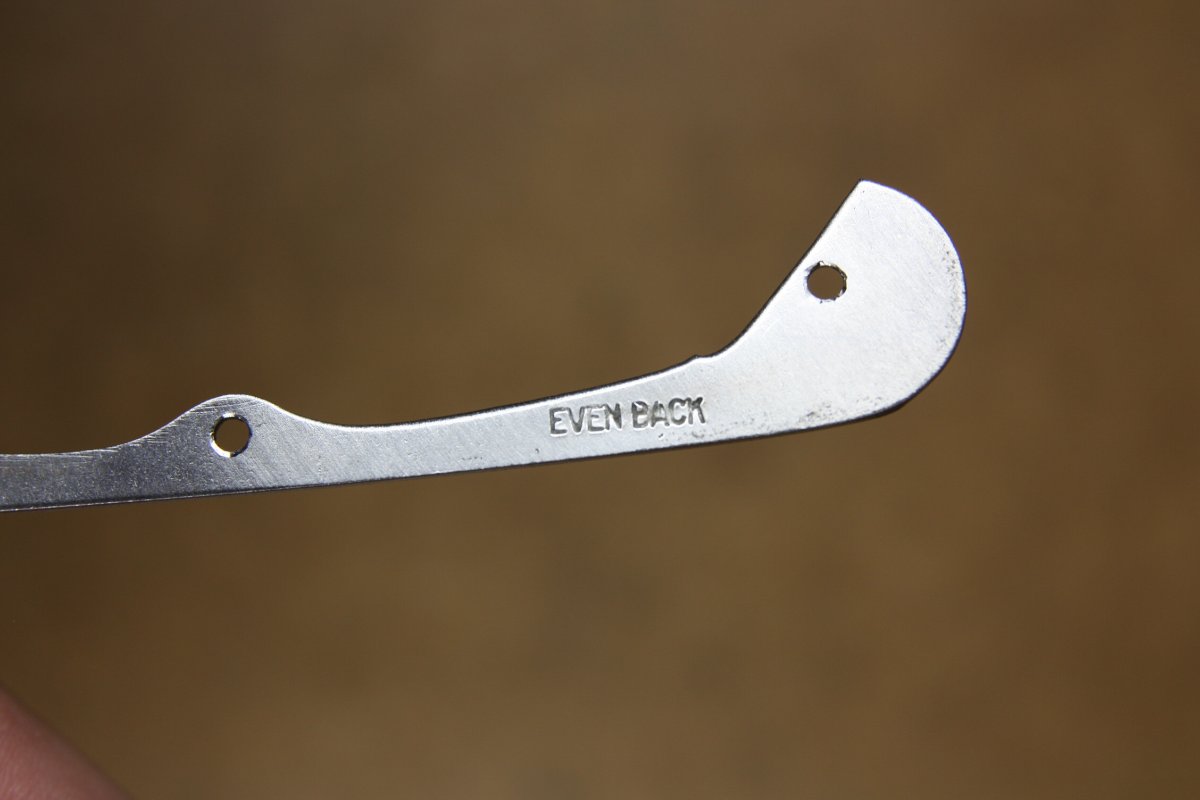

Those of you who have had Kamp Kings apart, what does "evenback" mean as stamped inside the spacers?
Finished
