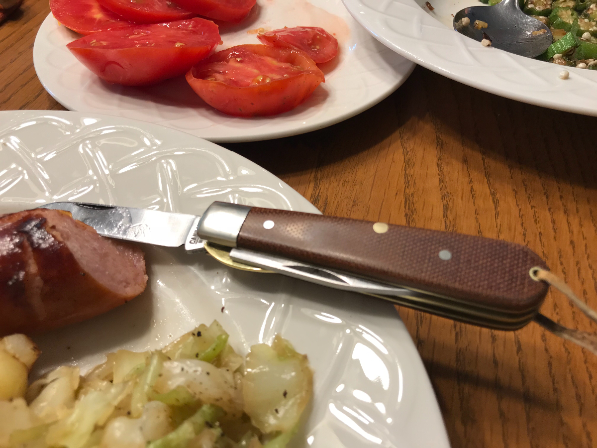

Fantastic Tony!! That blade looks really good and the rest of the knife is on par with what we've come to expect from your work. Very nice. The food doesn't look bad either!! Now I'm hungry...

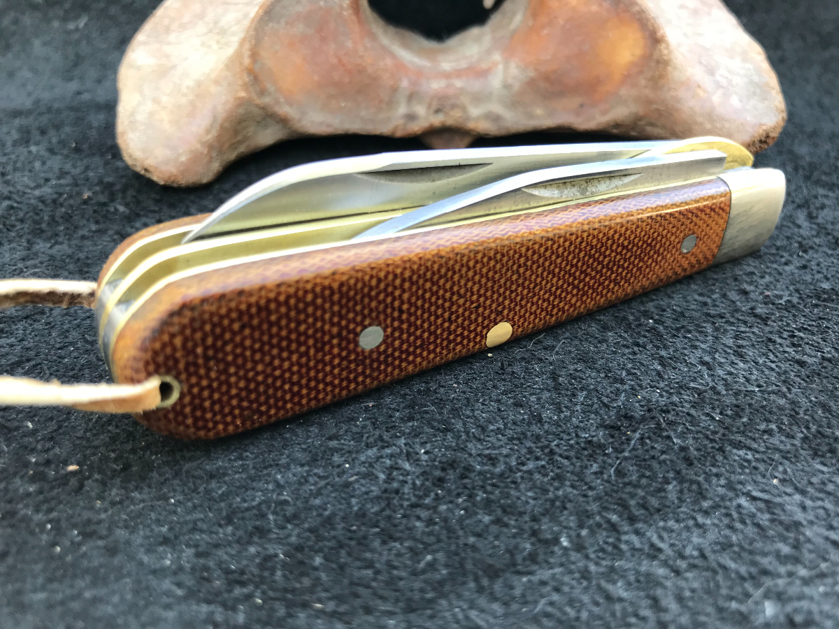

Tony, Fantastic job. I really like the new handles, big improvement.Tony_Wood wrote:Non pocket knife folks might not ever see the Conversion. You guys will notice right away!

Super job Tony. That conversion of screw driver to Wharncliffe is one I like and you did great on that one. Excellent work.

Nice Tony , Looks like the "Supreme Model" If there ever was one , Very Stylish

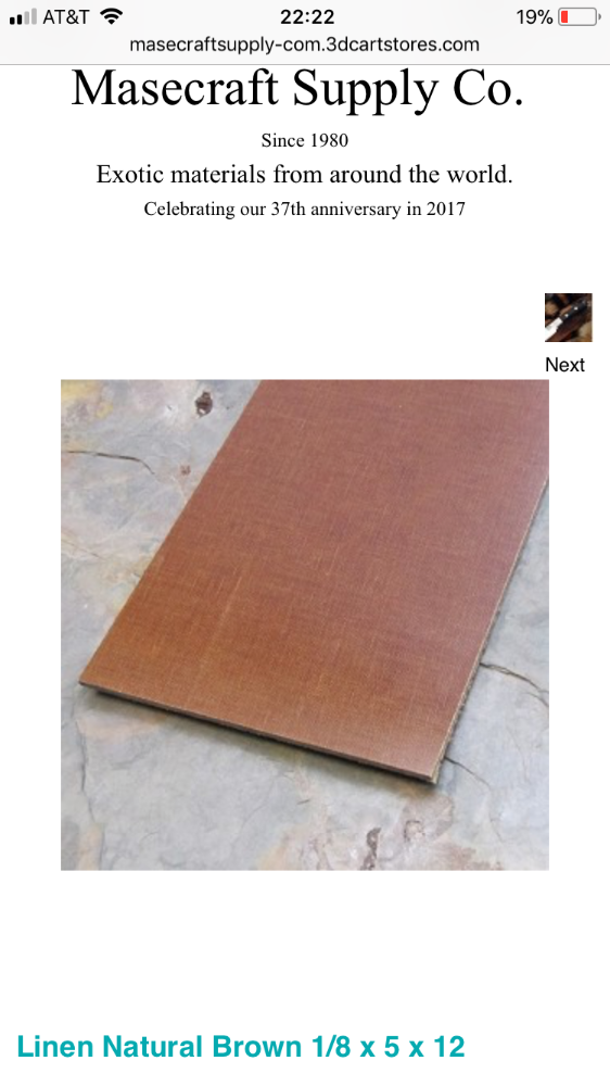

Yes, definitely does look great. What exactly is the handle material?

Thanks all. She sure is snappy.
http://masecraftsupply-com.3dcartstores ... _2733.html
What I have is actually .250 thick.OLDE CUTLER wrote:Yes, definitely does look great. What exactly is the handle material?

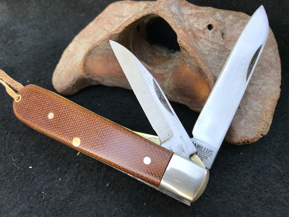

To parrot everyone else, good job! I see you retained the blade lock. Since I'm not fond of them, if I had your skills it would have gone bye-bye but that's just me. Excellent choice on the handles.

Options. I left it for options. The main blade is free of locks. Also have the option to remove it via a dremel as it is. Honestly, I thought of making a new liner. Choices and options.jerryd6818 wrote:To parrot everyone else, good job! I see you retained the blade lock. Since I'm not fond of them, if I had your skills it would have gone bye-bye but that's just me. Excellent choice on the handles.

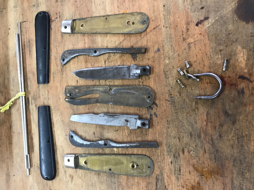

Jim, both blades are original to this frame. The wharncliffe was a screwdriver that was reshaped and reground. The only thing new to this knife are the scales. Everything is just cleaned, sanded, or reshaped.Doc B wrote:Gorgeous work! So forgive my ignorance...I'm in the early stages of pulling apart knives...and trying to get them back together Still trying to understand; I have 3 questions:

Interchangeable blades are certainly possible. I have mostly used blades from the same maker and style. This forum is a great place to provide/find both donor blades, and frame/scale materials. Having tried to mix/match blades and backsprings mostly does not work. Usually the holes do not line up, or the thickness varies too much. Both remedied with proper tooling, but with the same tooling it is often easier to make a new blade/ backspring.
Hope this helps. Please post up pics of your work. I, like many others, receive inspiration from such.
