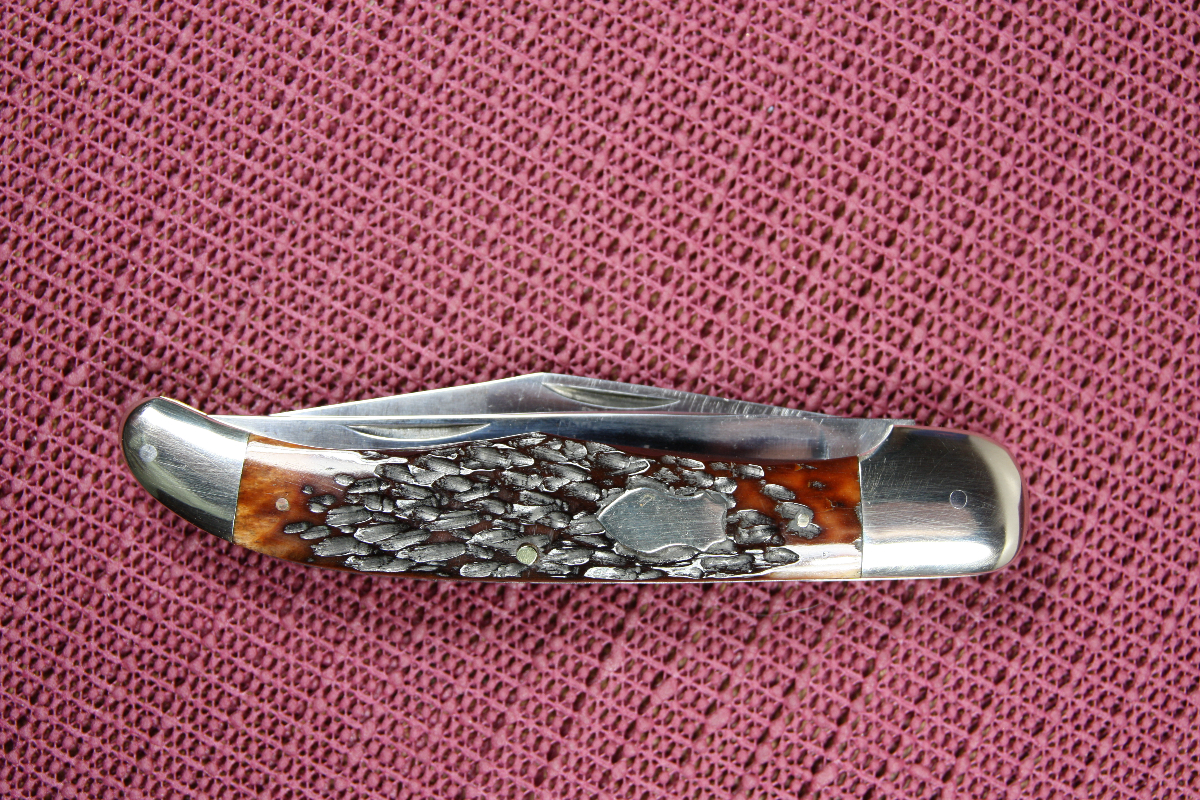

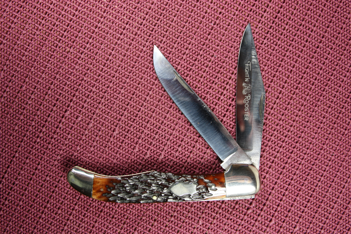

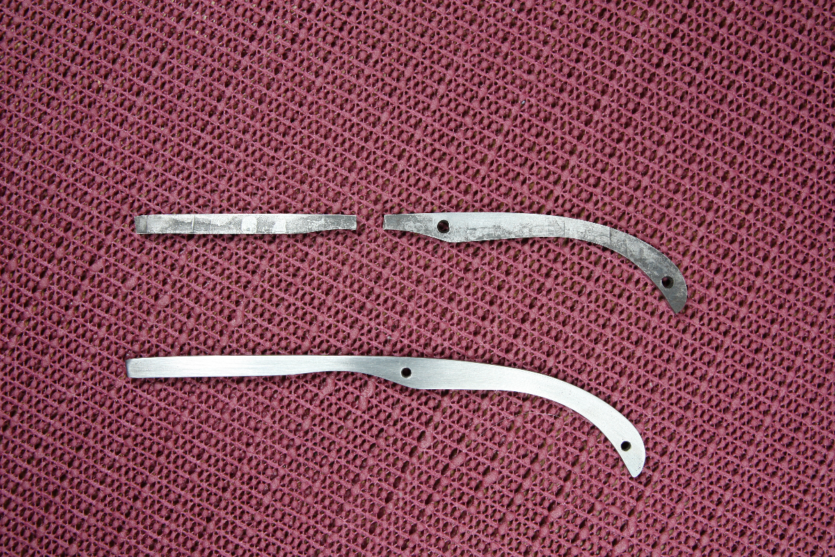

A local fellow I know that has a large collection of folding hunters by any and all manufacturers asked me to take a look at fixing one of his collection. It is a Fight'N Rooster folding hunter of the usual configuration of two blades, bone handled, 5 1/4" overall closed length. This one is only marked with the Fight'N Rooster tang stamp and Frank Buster Cutlery on the back of the master blade. No country of origin is marked on it. It is a new knife, never carried or sharpened, but had a broken spring on the master blade. For whatever reason they used steel pins on both ends and a brass rocker pin. After making a replacement spring from 1095 steel and installing it, I hammered and hammered on the replacement steel pins trying to get them to at least not be so visible against the nickle silver bolsters. I was wondering if any other of you knife mechanics have any experience with this type of situation? I have repaired knives that used steel pins thru steel bolsters, which makes sense. But why use steel pins thru nickle silver bolsters in the first place?
