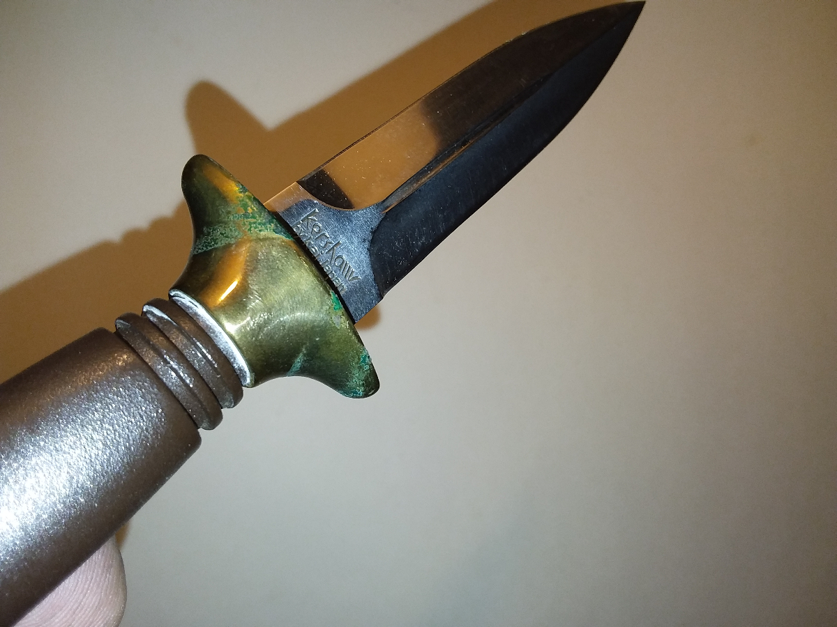

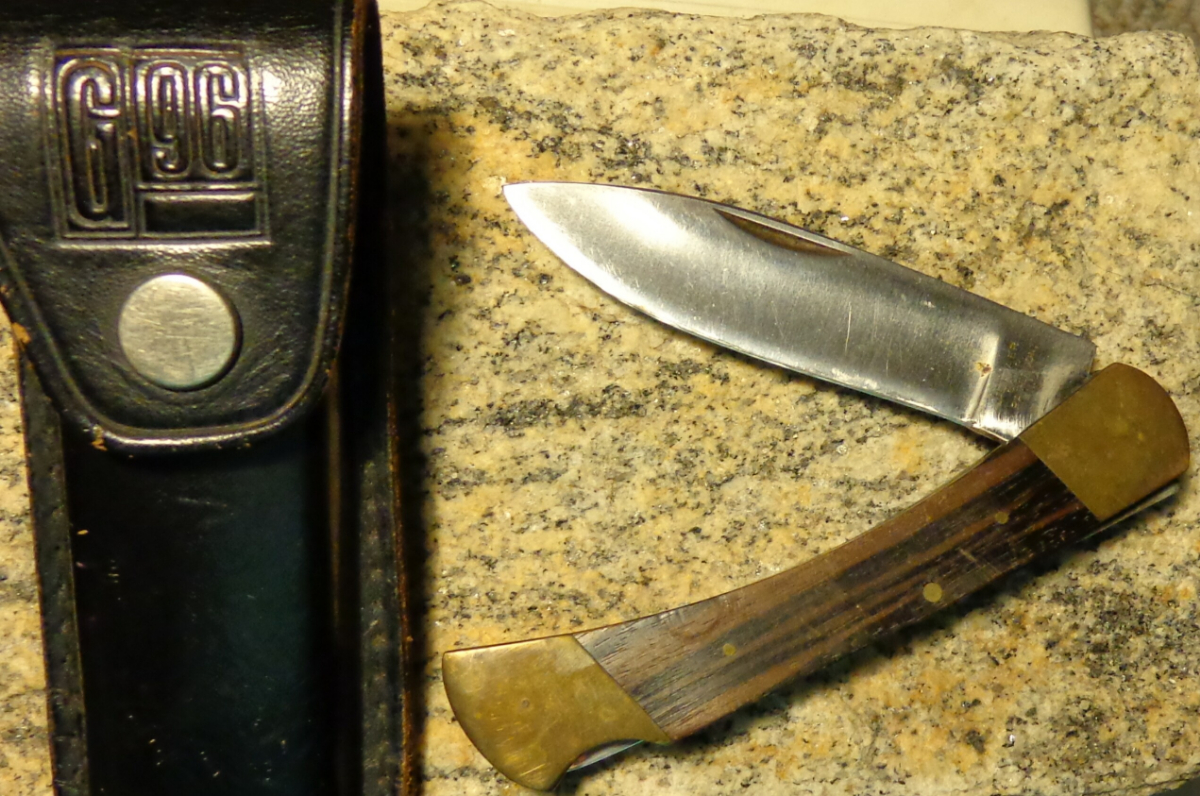

Well, I've seen it and dealt with it before. Brass turning green. I was just going through a bunch of knives wiping them down and doing a little oiling and found a few that were really bad. My Randall model 18 had chunks of green corrosion on it as did one of my Silver Stags. I also just found a Kershaw Special Agent turning green. I cleaned up the others already and the Randall appears okay, but the Silver stag has some damage. All were stupidly stored in the sheath. I have some folders that are the same way. Seems that the old Schrades are very susceptible to this. Sometimes even when stored out of the sheath. The question is, how do I stop it. I have so many knives that routine maintenance could take a year if I go through them one day a week for a few hours. I haven't looked at the Randall in years, it was in the back of the safe. It was purchased about 1970-71. I'm cleaning them by hand with flitz . It's doing a good job. Should I wax them afterward? None of them are going back in the sheath. Now I have to dig out all the others and look.
How not to store your knife

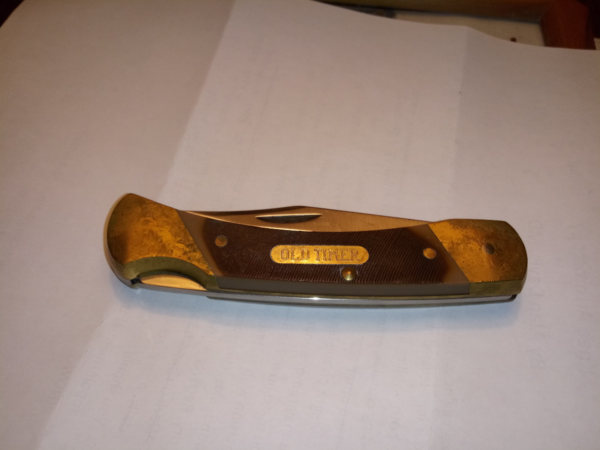

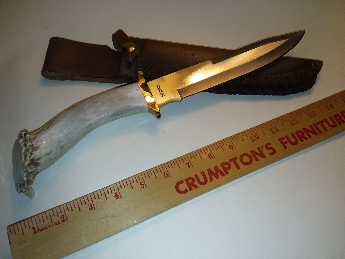

kenb wrote: I don't think I'll be strapping on that Silver Stag Pacific Coast Bowie and getting out to use it anytime soon. It's huge.
Is it anything like this Silver Stag? I had never heard the name until I came across this one a friend of mine had. He traded it for something and then I wound up with it.Nicely made knife.

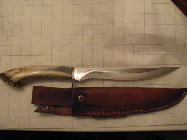

Silver Stag Pacific Bowie

kenb wrote:Silver Stag Pacific Bowie
Nice one Ken! Thanks for posting it.

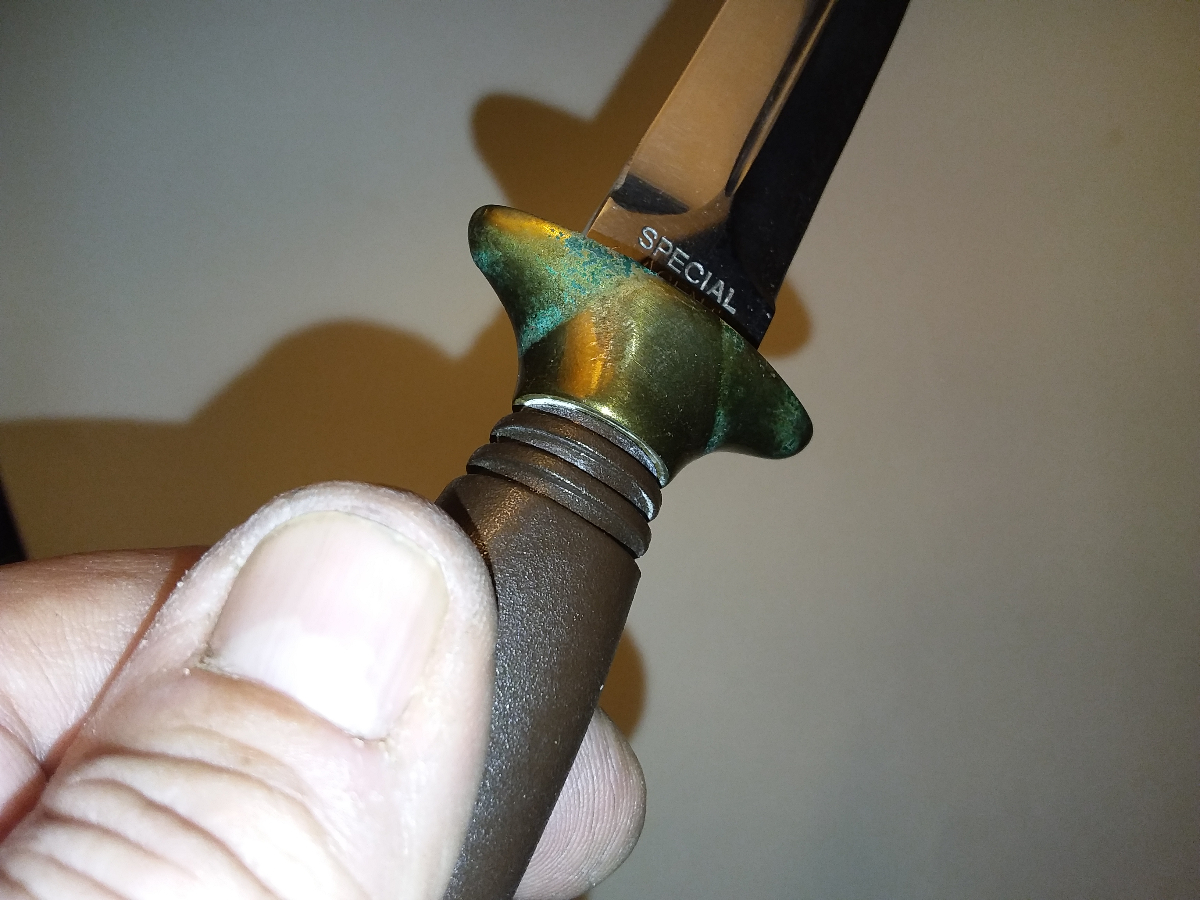

Mel, I'm not talking about tarnish here. I'm talking about the brass actually pitting and degrading. If. You dont clean off that heavy green gunk it starts to eat into the brass. If you get to it early it will clean up. Wait a little too long and it will stain the brass. Wait too too long and it will pit the brass. Just go online and look at some vintage Shrade LB7's or Buck 110's for sale and you're bound to see it. If you're lucky you can buff it out, but most of the time it's a lost cause.
kenb
Posts: 118
Joined: Mon Jan 28, 2013 12:24 pm
Location: Fayetteville Ga
Re: Brass corrosion
Post by kenb »
Here's a perfect example. I acquired this knife in this condition many years ago.
Posts: 5106
Location: Indiana
Re: Brass corrosion
Post by Sharpnshinyknives »
Ken, I had knives that looked exactly like that in that first collection I bought. That staining will not come out. You are absolutely correct about that.
Mark
SSk Mark “Freedom is never more than one generation away from extinction. We didn't pass it to our children in the bloodstream. It must be fought for, protected, and handed on for them to do the same.” Ronald Reagan

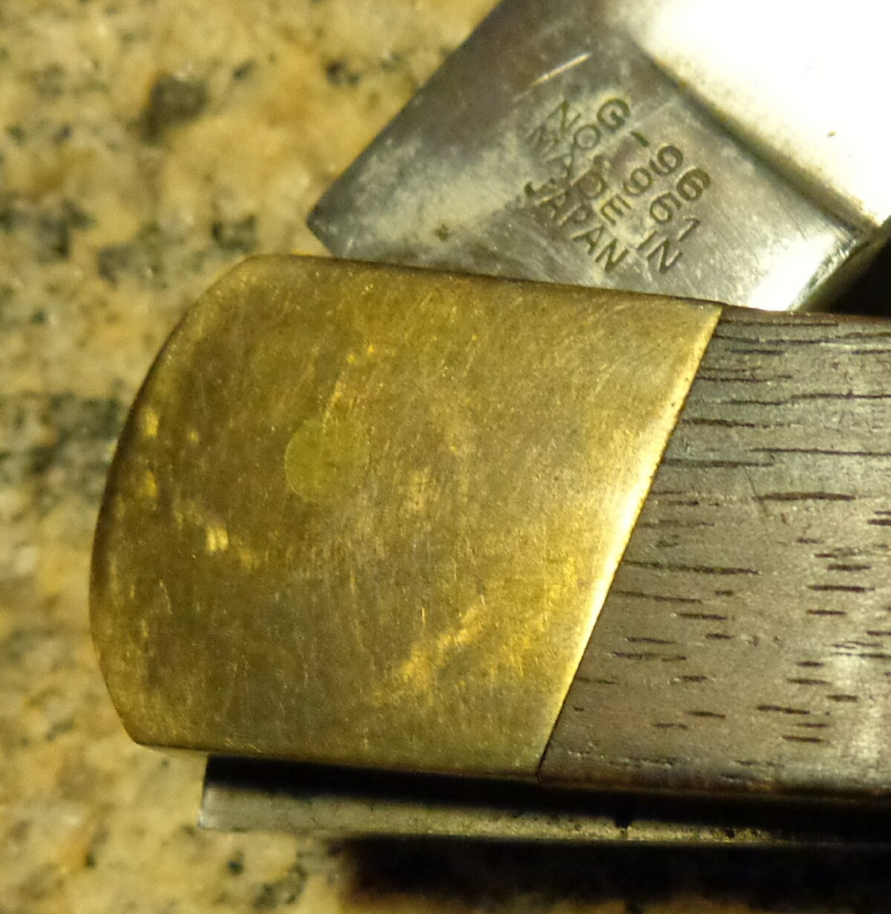

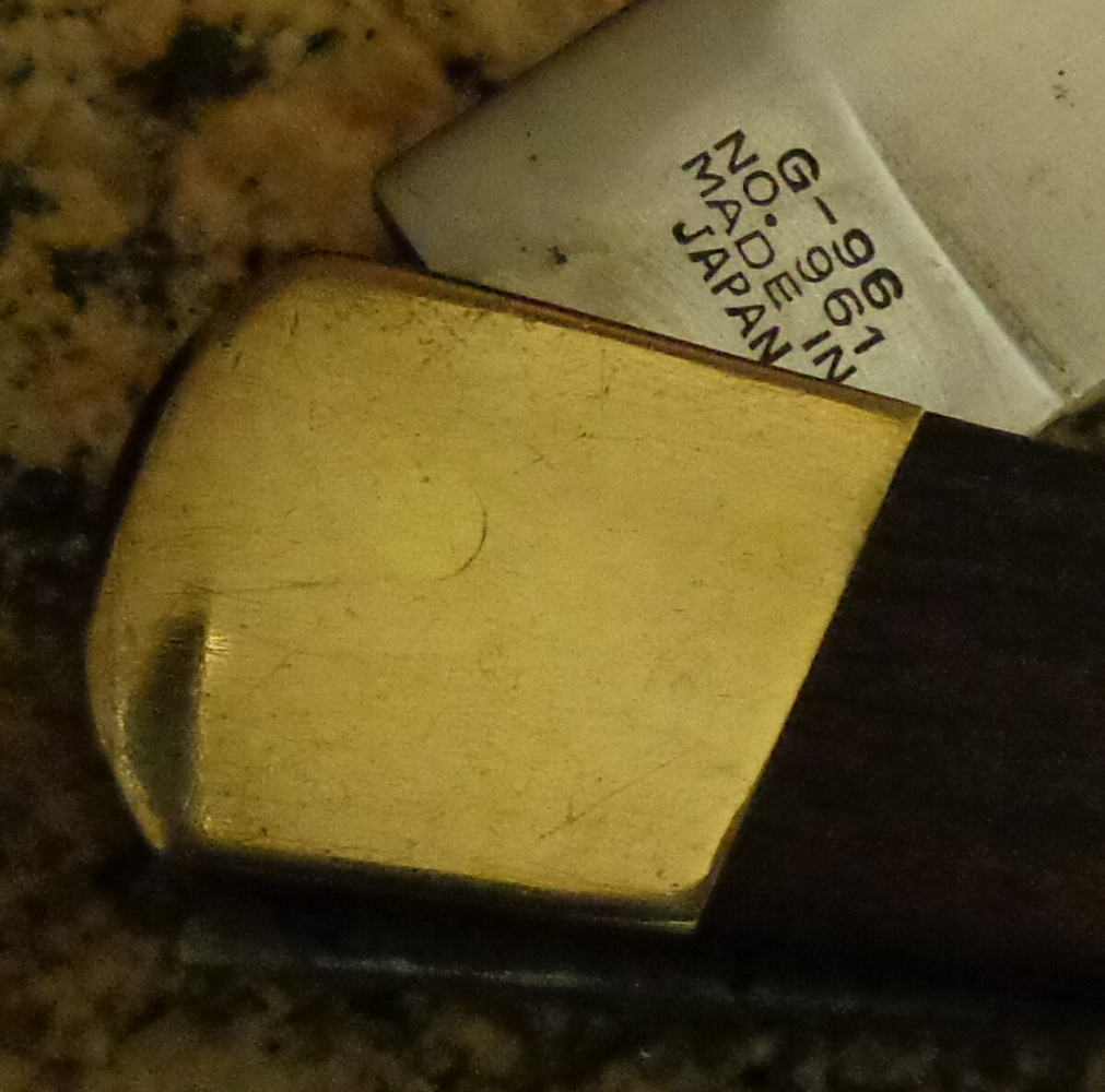

Ken - I am not saying that you are wrong. Just that I have not experienced pitting that I was aware of.
There are different formulas for brass, and I expect that some might corrode worse than others. Here are a couple of photos of a Jet-Aer that I bought in 1977. It has been stored in its sheath since about 1980. I dropped it on concrete and pavement back when I used it, so there are plenty of dings, but when I cleaned the tarnish off one of the bolsters I do not see anything that I think is pitting. It is hard to say what is what, for me at least, and I cannot tell with your knife either.

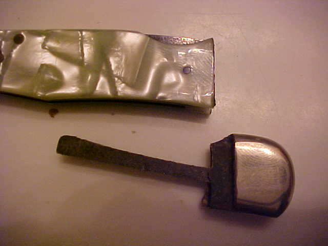

Dinadan wrote: It does tarnish, but I have not seen brass actually corrode. .
If you have never seen an outgassed celluloid handled knife that has had the liners eaten completely away by nitric acid fumes you haven't lived! :mrgreen:
