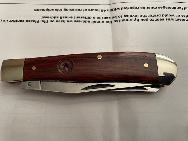

Glad I saw this thread. I just purchased 4 Boker Treebrand knives, on one of them the shield fell out as I turned the knife over after pulling it out of the paper, it is lost in the garage going to try to exchange it since it came that way out of the box. I don't think I should have to repair a new knife, or wait for a shield to come in.

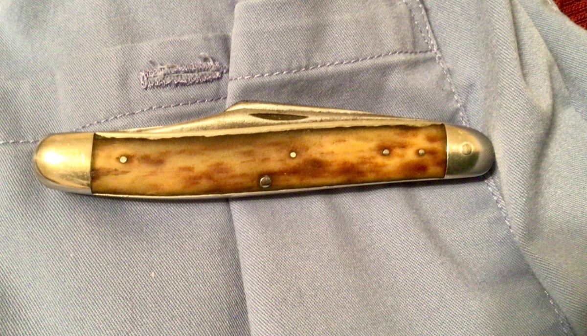

XX Case XX wrote: Wed Aug 15, 2018 2:46 pm I think this is one of those times when the old saying of "They don't make' em like they used to" applies. As the previous post stated, the days of pinned shields is probably gone forever. There might be some that still pin shields but I doubt it unless it's custom made.
I'm sure even pinned shields have come off a time or two although I've never heard of it. Maybe the adhesives used for this type of thing act differently with different types of handle materials as well. I know they make glues for specific uses so perhaps the glue used on your knife was not a good choice for the handle material on that specific knife.
_________
This is the only knife I own that has a missing pinned shield. I did not even notice it
until I posted it as a Robeson knife I recently bought and a member pointed it out.
I guess the pinning was not deep enough?
633594 ,4 inch, 63 gm, 1939??

rea1eye wrote: Thu Feb 12, 2026 2:39 pm
_________
Bob
It could also be that the shield was slightly proud and caught a thread in a pocket and got yanked off...it doesn't look like that shield was inset much (if at all)

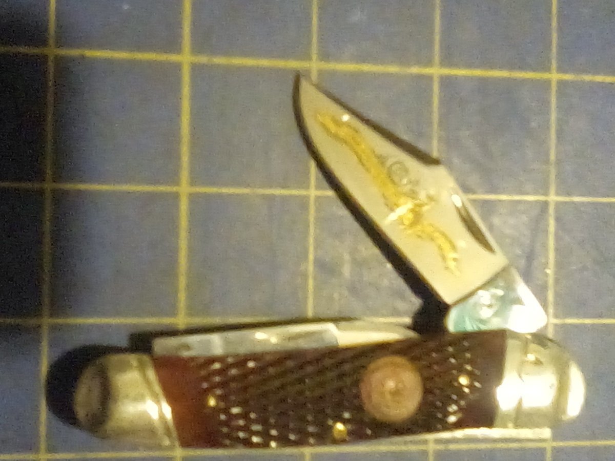

Here is one l picked up the other day sans shield. Colt( Chinese but well made)with a 175th anniversary etch. Checkered bone handles and all blades stamped with the Colt logo. Think l might use a shell casing end cap for a shield.

zktk01
Posts: 12
Joined: Mon Feb 09, 2026 10:36 am
Re: What is up with so many NEWER knives losing shields?
Post by zktk01 »
I ended up getting Boker to send me a shield, for free was alot less hassle than exchanging the knife. I cleaned it with alcohol and used Gorilla Glue Gel is what i had, seems to be holding fine.
