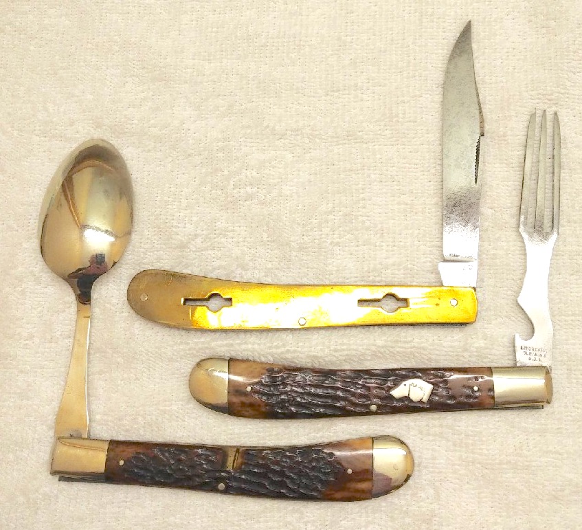

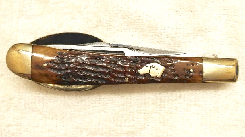

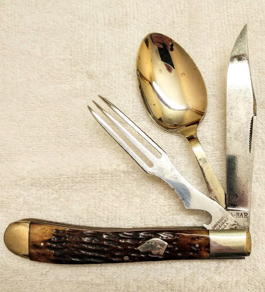

Looking for information about this KA-BAR dog-head slot hobo. It's stamped KA-BAR on the knife blade, the fork is stamped UNION CUT. CO. over OLEAN, N.Y., over U.S.A. on the mark side and PAT. on the pile side. The dogs head shield has KA-BAR on it. I understand dates of KA-BAR stampings are somewhat vague, but from what I've read this one dates to the 1930s-40s range.
Any of you KA-BAR experts that can confirm or refute the age of this knife, or any other tidbits about it, please share your knowledge.

Ken, that’s a super nice old Ka-Bar / Union hobo.
Did you find it during your travels in New England?
Here is a link to a post that describes the old Union blade marks. It looks like the knife could date starting from 1923 through the 1940’s.
viewtopic.php?f=4&t=39799&p=478928

Thanks Jerry. I got it at the NCCA show in Portland, ME.
That Tang Stamps thread is where I got what little info I have, but I've seen posts from others questioning the accuracy of the information so I'm hoping someone (Gunsil maybe?) has some insight.

Well you sure found yourself a rare one! Pretty nice shape too!! I would have to say mid 20s-1942 but it is more likely mid 20s-1940. Tang stamp changed to KA-BAR over Olean, NY in 1943 with the switchover to military knives, They never made another dog head after the war (don't get me going about the newer dog heads which weren't made by KA-BAR). It is my opinion that these large size dog head slot knives are among the three hardest to find dog head KA-BARs. Glad to see you made it to an NCCA show, hope you had a great time there. Which one of my friends did you get it from, or did it come from a visiting seller? Did you get to meet any other AAPK members there? I wish I had had the gumption to get up and drive the five hours to get there.
