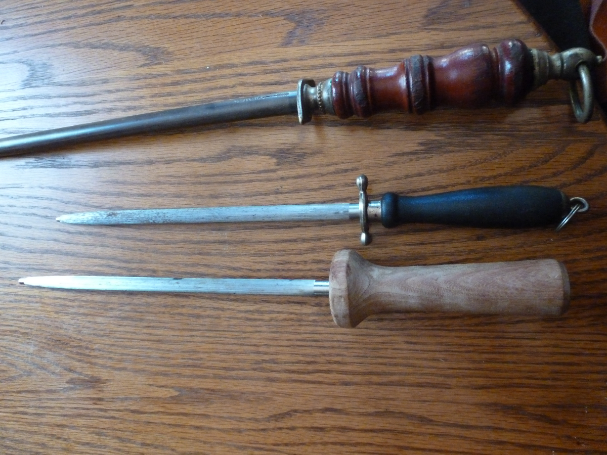

I use a bench stone for most all sharpening. That and a couple of old F. Dick steels. So my advice is to get a couple bench stones of whatever coarseness you prefer and just give your blades a touch up ever so often and then strop the on leather or a good steel.

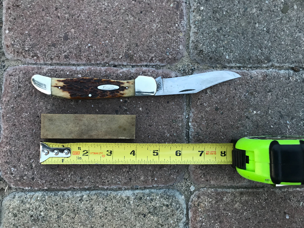

Here is Dad’s old stone. As I said only thing I use. Measures 1” x 3 7/8” x 7/16” thick. Hand held moving knife not stone. Sharpen large knives like the big Hunter pictured. Based on thickness need to have your head screwed on to not shave off the fingertips. No idea on what type of stone it is but is definitely fine in grit.
Good luck. Keep us posted on your progress.

Am curious as to what your reactions might be to the following. I make it a practice to keep a honing steel or chef's steel anywhere I have my knives. In the kitchen obviously, but also in my office and another room that holds most of my knives. Although I often use knives, normally it is for fairly light duties. Perhaps with a blade that gets a lot of challenging work this would not be applicable. But whenever I find a blade that is losing the sharpness I want I give it a few passes with the steel and the improvement is immediate. I realize this is not "sharpening" as such; just a realignment of the micro-teeth of the blade edge. When the day comes when steel has to be removed I use a Speyderco or AG Russell V sharpener.

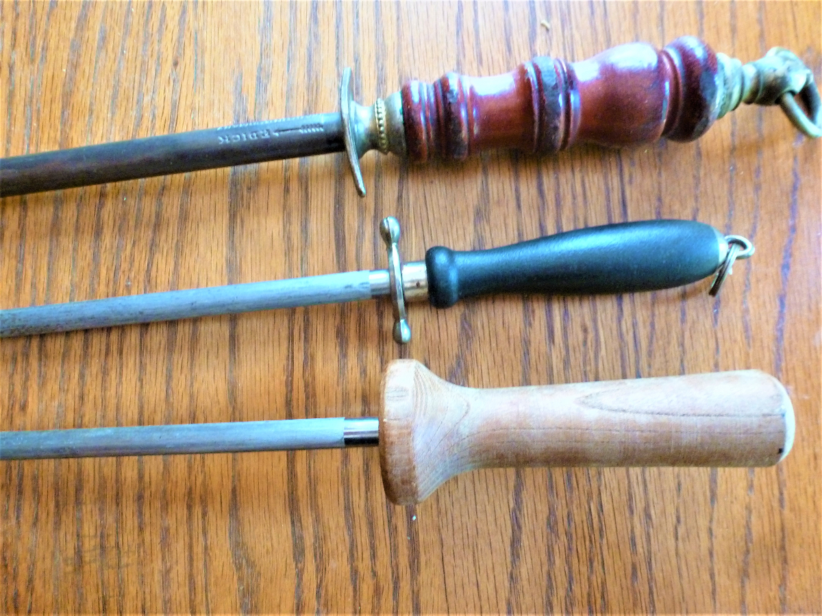

Quick Steel brings up a good point about steels.
A few passes on a steel using thoughtful strokes and angles will bring back an edge very quickly.

FRJ you are spot on about not imitating the chefs.Also, In the last couple of years I have seen "steels" being sold with diamond coated rods. This means that the uninformed are going to be quickly diminishing their cutlery if they imitate the rapid fire techniques they see on TV. Coating the steels with abrasives entirely ruins the intended purpose of steels.
Please don't follow the ridicules moves by some professional chefs when they hurriedly strike the steel with their knives.
That is nonsense.
I use steels some, mainly to line up the edge after sharpening. But I agree, those fast wild strokes are counter productive.
