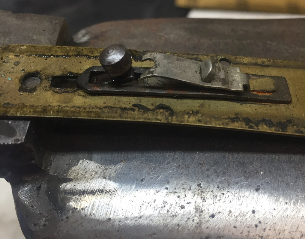

I have had this old Colonial "Pronto" knife in my box of dead knives for a while. When I was on my way down to my shop yesterday, I heard it calling my name. It was time to see what this Pronto needed to get him operational again.
There was no spring action at all so I figured I would find a broken spring when I opened it up. Actually, when I got inside, there was no spring at all.
That crunched up roll pin is where the spring used to attach.
SO.... onward to the clean-up...
The knife was originally put together with brass roll pins. LOL..... plastic scales, roll pins, I don't figure that Colonial wanted this knife to last too long.

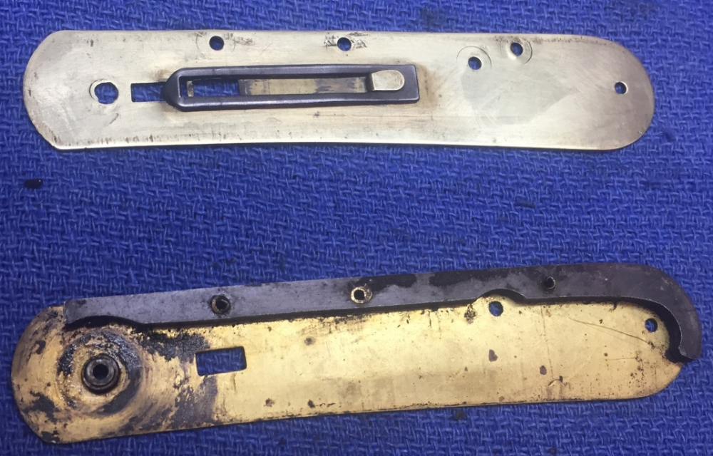

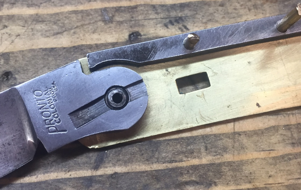

After clean-up you can see that the spine is nothing but a spacer really. It doesn't serve the same function as a spring in a folder.
Here is the push-button mechanism...... really simple.

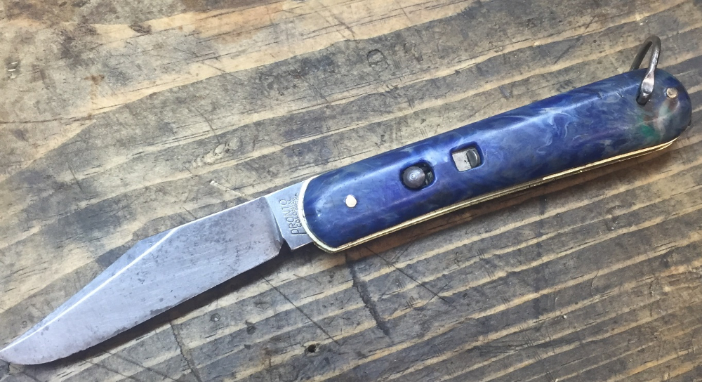

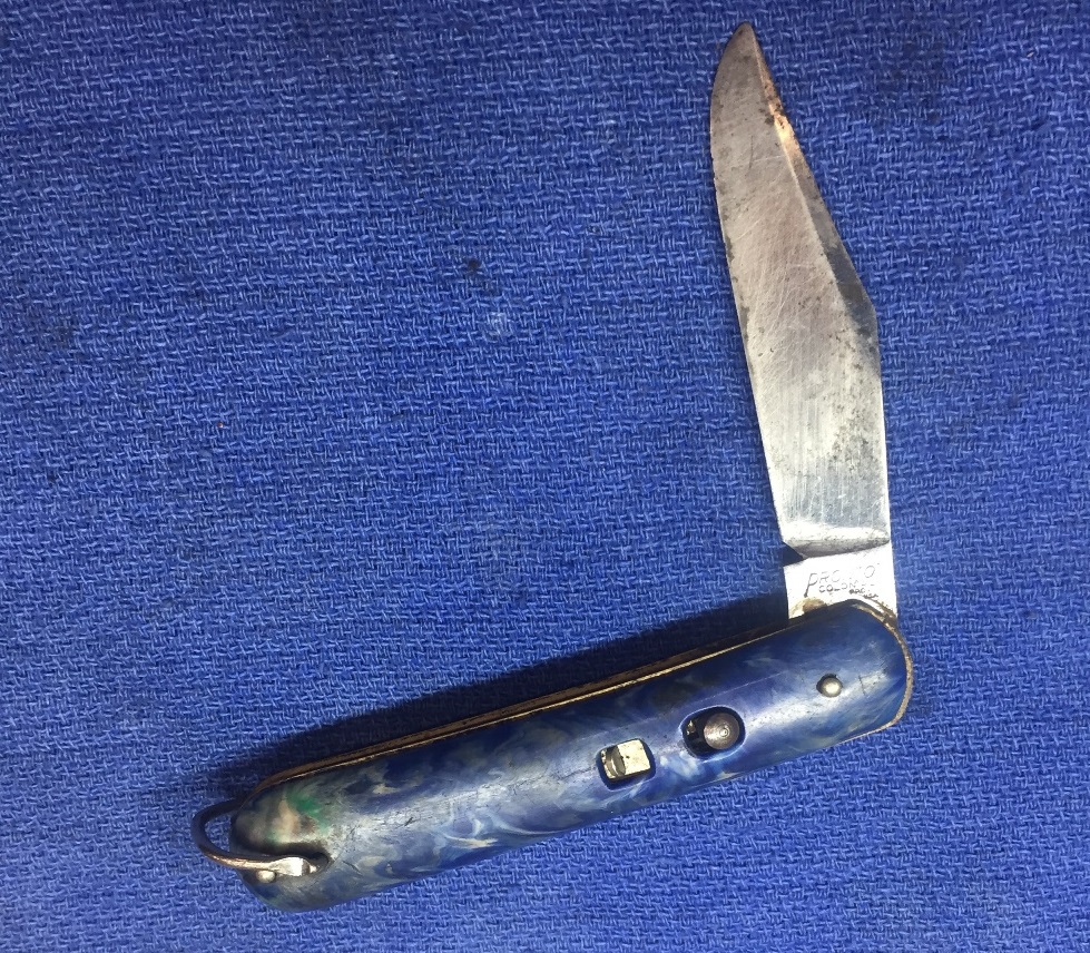

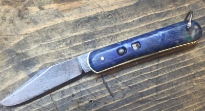

SO here she is, out of the ER and in my collection of American auto-openers.
Thanks for looking everyone.

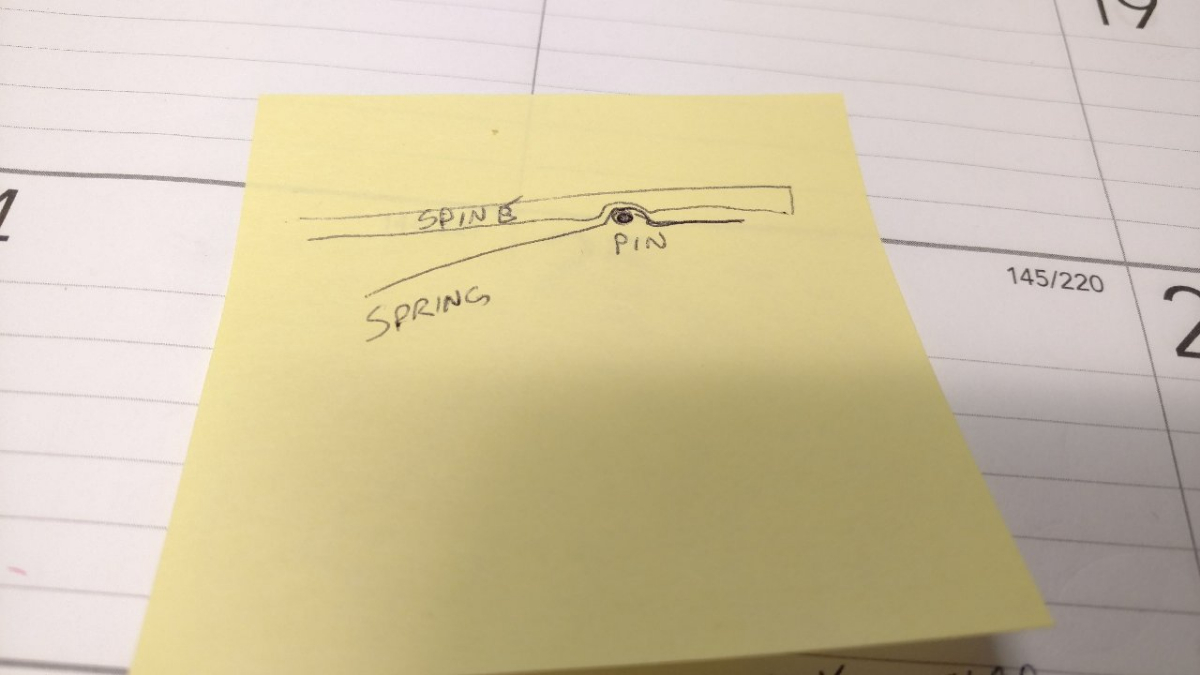

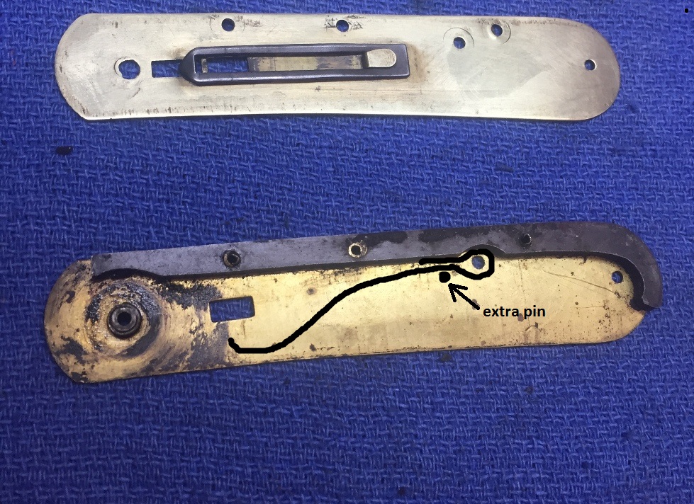

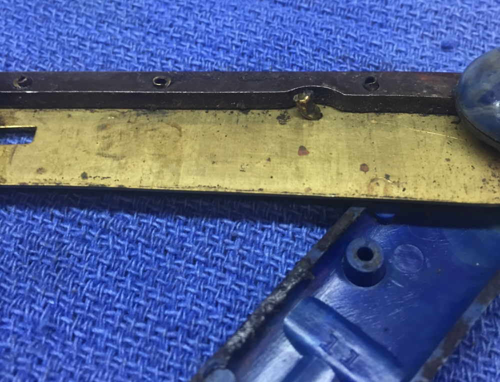

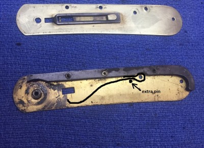

Here is a very rough diagram of how I made the spring. I used the "cut-out" in the spine as an anchor point for the spring. I bent it to this basic shape.......and I put in an extra pin to capture the spring against the spine.

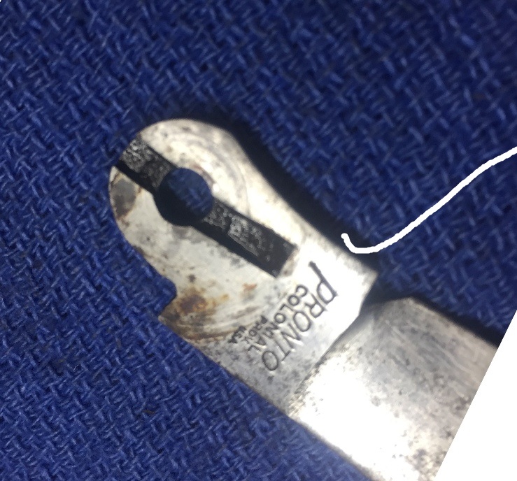

The length I show in the diagram is not necessarily correct. I had to make a second spring to get my length right. I made it so it engaged the blade at concave spot on the blade where it is shown in the second picture. Then as you close the blade, the spring rides up the concave part of the blade.
Sorry for the crummy pics....LOL. I should have taken pics before I put the liners back together....
Anyway Glenn, I hope this helps you with your Pronto.

I'm not in my shop, or I would be able to take a pic for you. The normal spring that would go there looks something like this awesome artist rendering.
By having the spring made and installed this way, you don't have to put the extra catch pin to hold it in place.

Ah ha!! Thanks for showing that spring design Glenn.... I will have to remember that. And after seeing your very nice sketch, I can see why I found no remnant of the original spring when I opened mine up. It must have broke right in the bend where the pin had it captured against the spine.glennbad wrote:I'm not in my shop, or I would be able to take a pic for you. The normal spring that would go there looks something like this awesome artist rendering.
