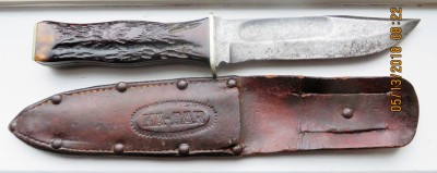

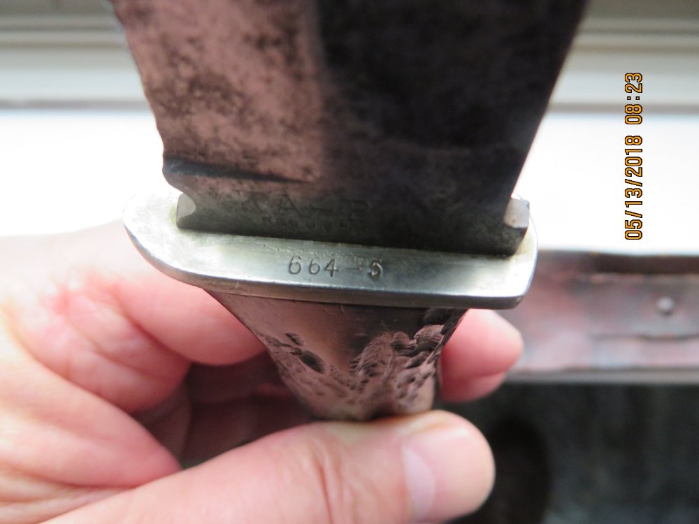

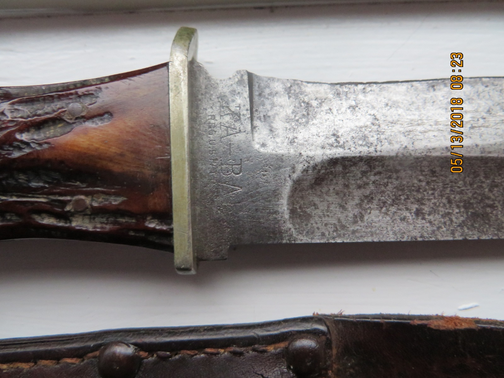

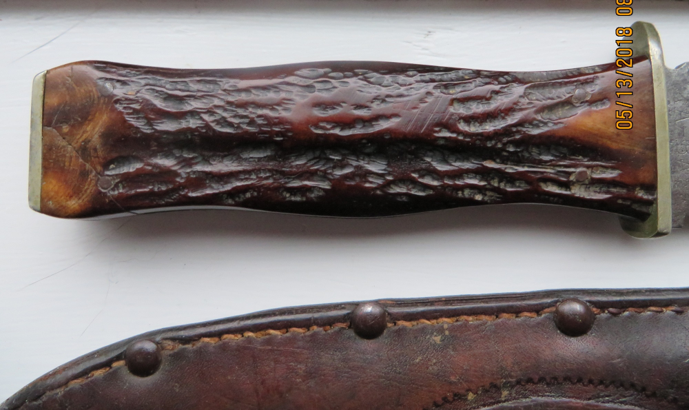

Picked this up at a local show yesterday. The handle shape and jigged bone with the blade grind, just couldn't leave it on the table. Feels great in the hand. I suspect it is a pre war knife from what I could find out nosing around this forum but any other info would be appreciated.

What did you wish to know Steve? The model name was "Explorer", it is a model 64, the first number 6 is for the jigged bone handle scales, the -5 for a five inch blade. If it were stag handled it would be a 264-5, 2 being the code for stag. They were available in 5", 6", and 7" blades, the 7" ones being quite scarce. They were available with several styles of bone jigging over the years. I have never seen a post-war marked one, yours is definitely pre-war. The model is shown in the first KA-BAR hunting knife brochure circa 1923. They are definitely handsome knives. Your sheath looks to be the proper one, and an early one, probably pre-1930 although it is missing the keeper strap as I'm sure you know. There are also very similar knives in stag marked CASE and others as well as myself believe they were made on contract for Case by Union Cut.

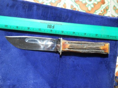

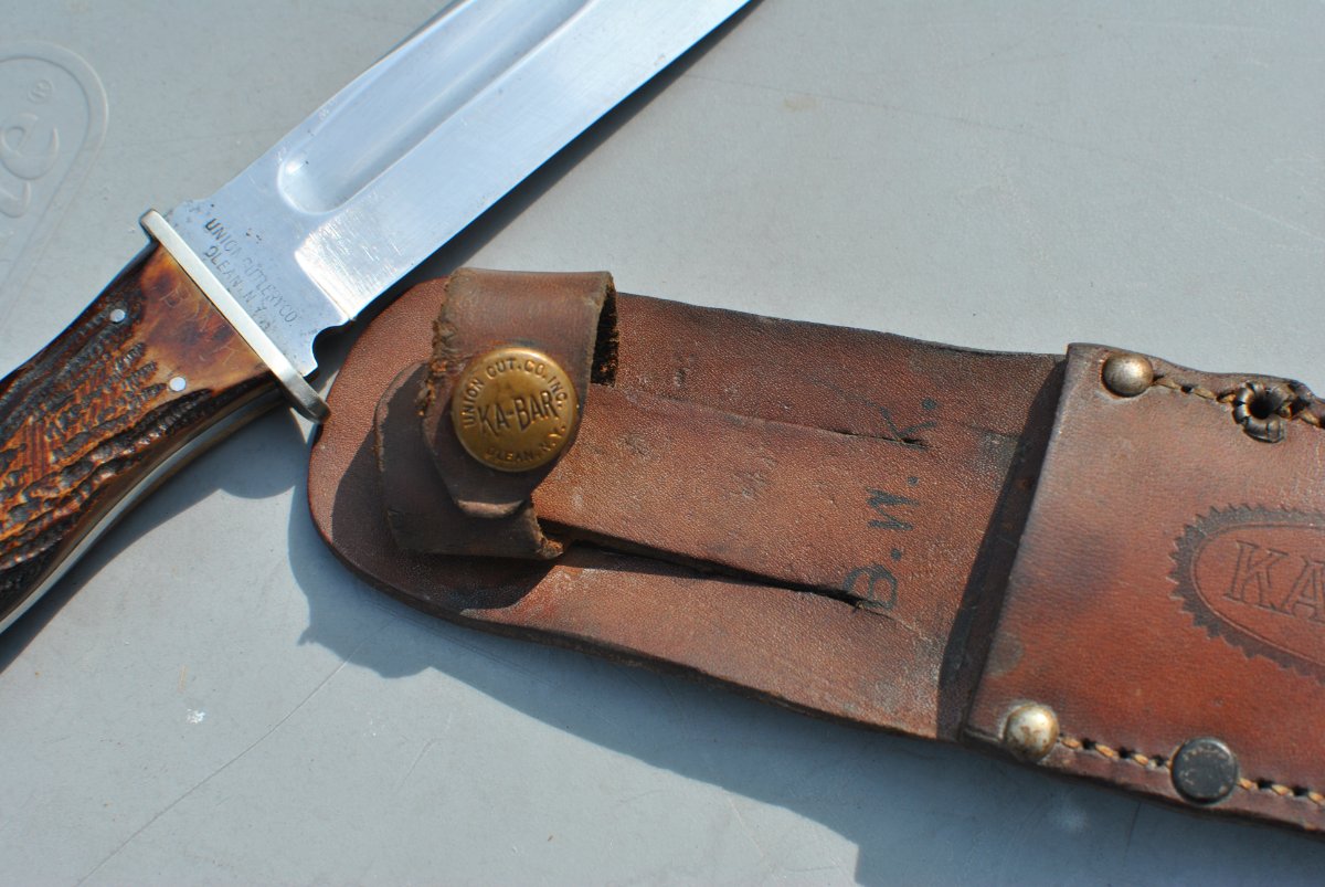

Here's a mint 5" 264-5. By the way, only the earlier knives will have the model number on the guard.

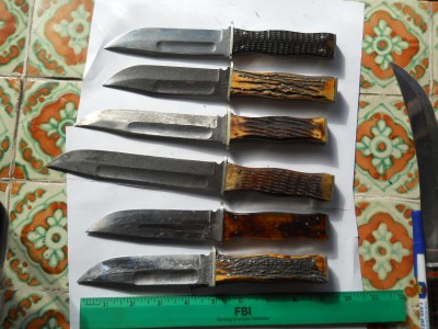

Here's a few more 64 models, 5, 6, and 7" blades. Steve, I don't believe this model was made after the war. The tortoise cell handles one here is the only war time one I have seen and the only celluloid one I have seen. The 7" one is the only one I have seen. Always looking for mint condition pre-war KA-BAR hunters. If anybody knows of any for sale please contact me.

Look closely at the ricassos on the 64 models I show. You will see a little curved depression in the bottom of the ricasso between the guard and the blade. The 71 series did not have this little feature otherwise the blades are very similar. I'll look for some 71s tomorrow, I have them in 4,5,6,and 7" blades, the 4" being as rare as the 7" ones. Pretty sure I will dig out a 7" one but surely have a bunch of 5" and 6" ones lying around.

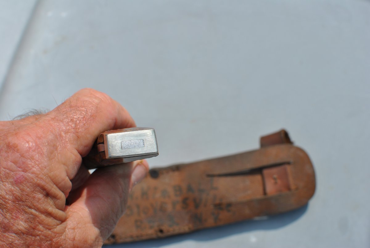

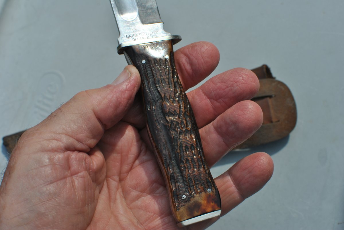

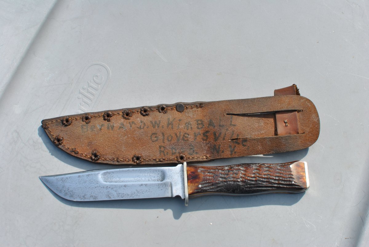

Steve, didn't mean to hijack your thread, Wayne, here are some model 71s, 4,5, and 7" blades, don't know why I didn't turn up any 6" ones. I just realized when I dug them out that the 7" does have the little cut out in the ricasso like the 64 series did but the other 71s don't have it, I have another 7" someplace, will have to find it to see if it too has that feature. Anyways it was the 7" model 71 which with a few minor changes became the 1219 C2 knives.

This wonderful knife was sitting on a gun show table today, in its original sheath. A 664 5 marked on the inside of the guard. The jigged bone looks like it's on fire. The sheath, for an over 100-year-old knife, is perfect; sewn, riveted and braded. Perfect keeper strap.
