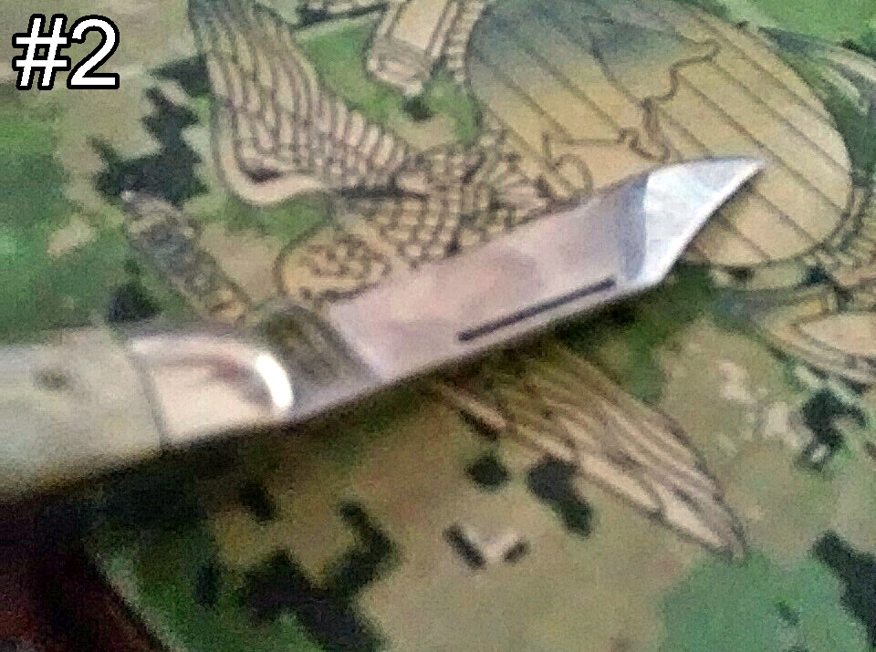

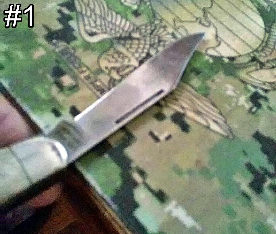

Post by jerryd6818 »
Couple of questions. Am I correct in assuming you mean lay the blade flat on the mouse pad / desk blotter / leather belt / etc (picture #1) and not up on the bolster (picture #2)
And does this work on Schrades using the Swinden system assembly?
And is a wooden mallet / lead mallet / leather mallet preferable over a steel hammer or does it even matter?

jerryd6818 wrote:Couple of questions. Am I correct in assuming you mean lay the blade flat on the mouse pad / desk blotter / leather belt / etc (picture #1) and not up on the bolster (picture #2)
I thought about it and then concluded that you hold the raised knife by the 'closed' bolster and tap the open blade on the choosen surface, like you're swatting a fly with the blade. Smacking the front of the blade at an angle to the surface will put some sideways pressure on the bolster.
Those who know will answer your second question. :? MY Schrades don't need adjustment. ::huff:: :D
ea42
Posts: 3194
Location: Wallkill, NY
Re: Too tight
Post by ea42 »
Edgewise, yes that's correct. You don't necessarily have to hold the bolster, just the knife handle. An alternate method is to lay the blade flat on the edge of a table, and tap the bolster with a non marring hammer. One or two taps is usually good. You need to use a bit of force, don't be too light or nothing will happen. What you're doing with both methods is to give the pin a bit of a jolt, lightly prying it without using tools to spread the bolsters apart.
Jerry it'll work on swinden construction too, but be careful since what your doing there is pulling on the keyhole rather than the pin.
