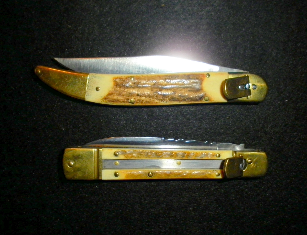

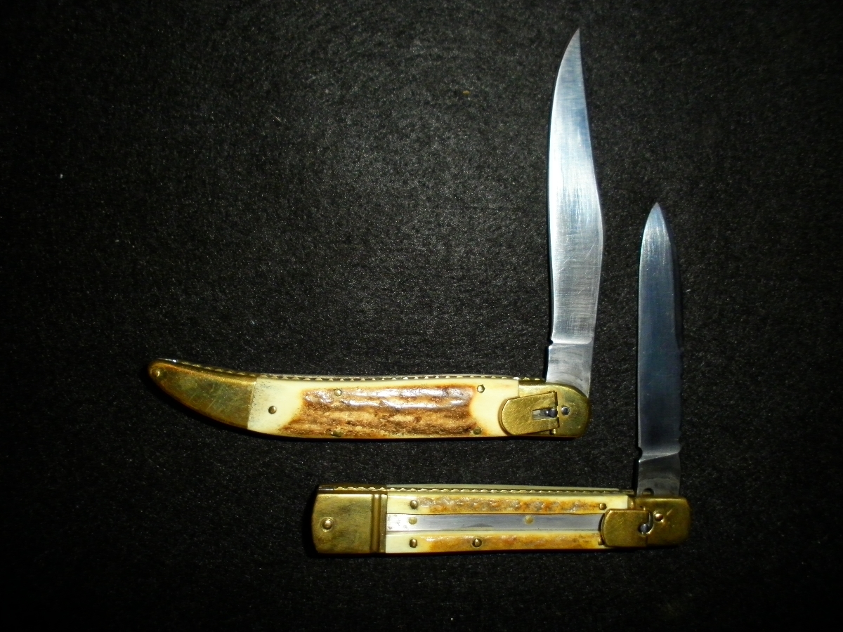

As an avid toothpick collector, it just had to be my first attempt at a custom leverlock auto. The second attempt was more along the lines of a classic design leverlock. Now I'm thinking I should have gone the other way around.
These two are looking pretty good here.
But... ::facepalm::
Aaaarrgghhh blade peek!! Son of a.......................................................biscuit eater!!!
This is gonna take a full blown redo! It's headed back to the shop and I will not be defeated...hopefully? ::undecided::

normally a little tweaking can correct peek unless something is way off. I think that will be an awesome little knife when you get her tuned in

Hey Kaleb, the fly in the soup on this one, is that it fires and locks perfectly fine in the open position. I'm afraid if I tweak it to the closed position, it will have an ill effect when open. Oddly enough, before I peened the last pin, it seemed to be working great and I'm wondering if it might be something as simple as a bent main pivot. I won't know until I get it opened up, but my biggest worry is losing the stag slabs. I thought I was being clever hiding the spring underneath, but if I have to build and install a whole new spring assembly, it means having to remove the handles.

Sear hole diameter/placement, is usually the culprint, altering the closed sear hole will not affect the knife in the open position. a bent pivot is a possibility, also a pin that is too small in diameter will cause this. make sure it is pretty snug in the hole. of both the blade and the bolsters
