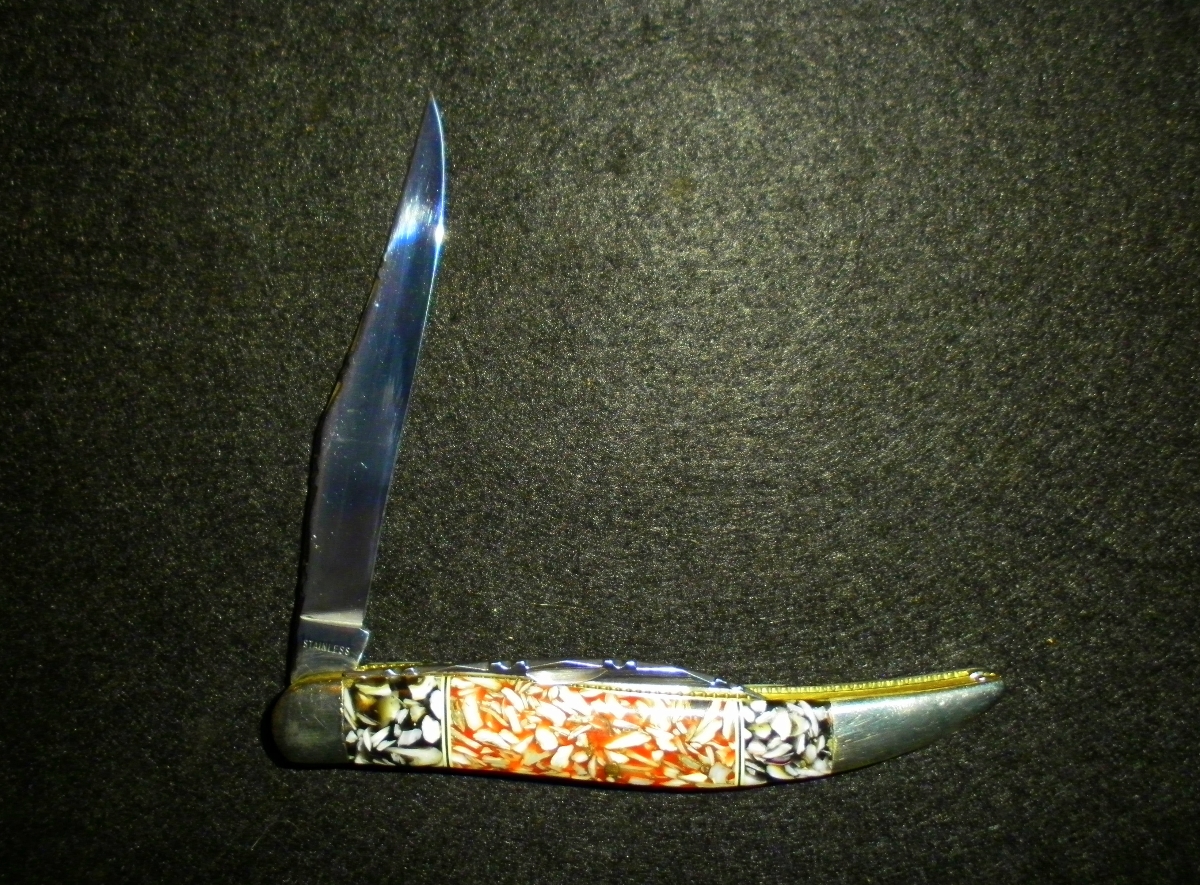

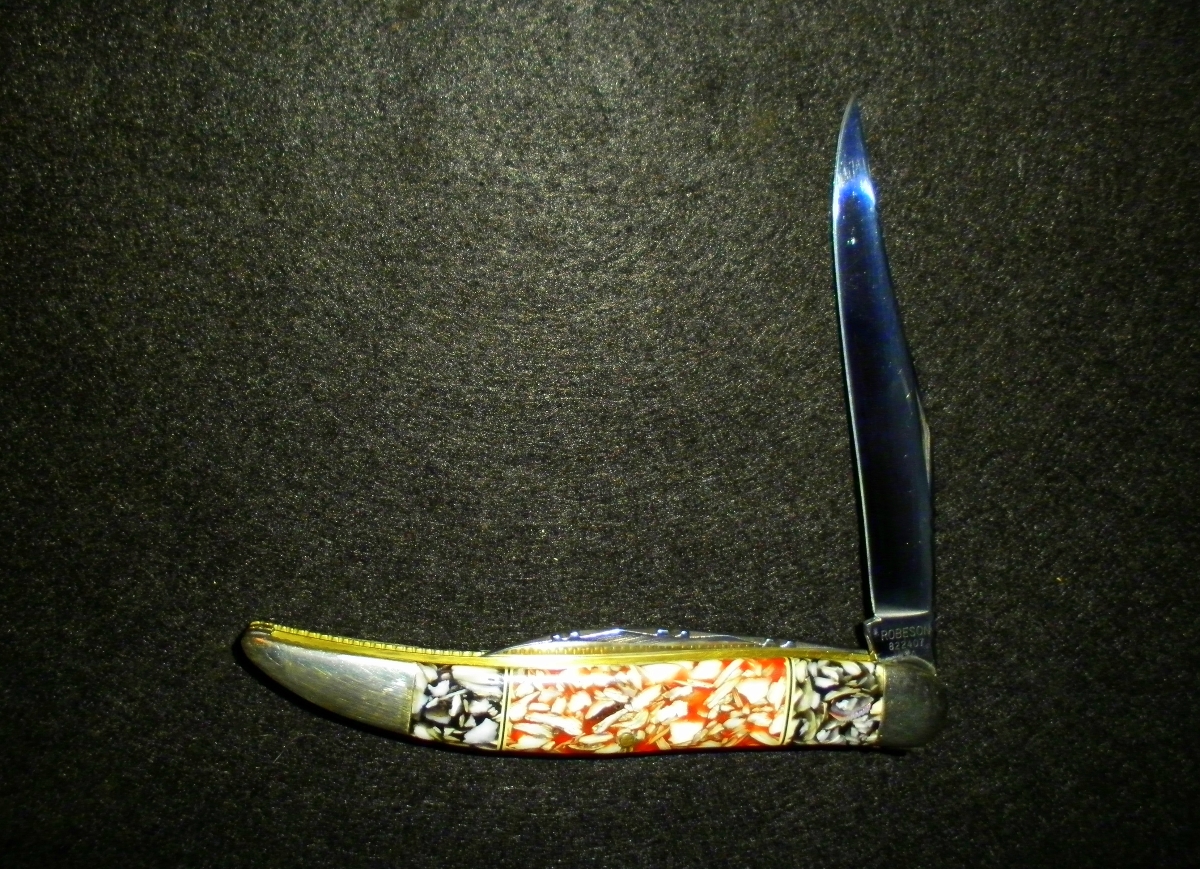

Part of what we do is work with solid surface countertop materials. As a result, over time, we end up with several varying colored tubes of adhesive. While cleaning out the shop awhile back, I came across several tubes that were outdated. These adhesives are a 2-part epoxy on steroids, in that they heat while curing to the point of creating a molecular bond between pieces. It dispenses through a special "caulking" style gun that delivers both parts down an auger tip that premixes it at the end. Rather then throw them out, I decided to line a loaf pan with wax paper and fill it as full as possible. I ended up with a full loaf. After filling, I poked and swirled until it was just about to start flashing off. Since this stuff is meant to cure in a micro-thin layer, or at most, a bead of squeeze out, it took several weeks to fully cure to the center. Most colors lean toward the pastel side, so aren't real dramatic. After semi-working them down on this first knife, I filled the air bubbles with clear epoxy and finished it off.
On a scale of 1-10, I'd give it around a 7 as an effective handle material.
WB

That turned out to be a really interesting experiment. I have made some pens and several sets of pistol grips from a solid surface material, Corian. I am sure you know what a wide variety of colors it comes in. I made a couple of sets of pistol grips from white Corian for single action pistols and they look great. Have not tried any yet for knife handles, but it should work. The only thing that could be a problem is some small knives have very thin handles, some just over 1/16". The pens I have made look good too, it polishes up nice after a final sanding of 1500 grit on the mini turning lathe.whitebuffalo58 wrote:Part of what we do is work with solid surface countertop materials. As a result, over time, we end up with several varying colored tubes of adhesive. While cleaning out the shop awhile back, I came across several tubes that were outdated. These adhesives are a 2-part epoxy on steroids, in that they heat while curing to the point of creating a molecular bond between pieces. It dispenses through a special "caulking" style gun that delivers both parts down an auger tip that premixes it at the end. Rather then throw them out, I decided to line a loaf pan with wax paper and fill it as full as possible. I ended up with a full loaf. After filling, I poked and swirled until it was just about to start flashing off. Since this stuff is meant to cure in a micro-thin layer, or at most, a bead of squeeze out, it took several weeks to fully cure to the center. Most colors lean toward the pastel side, so aren't real dramatic. After semi-working them down on this first knife, I filled the air bubbles with clear epoxy and finished it off.

OC, I too have found the ss material too brittle for smaller knives, even more so then MOP. I have used it successfully on larger knives like Buck 110's/112's and Schrade LB7's and 6OT's.

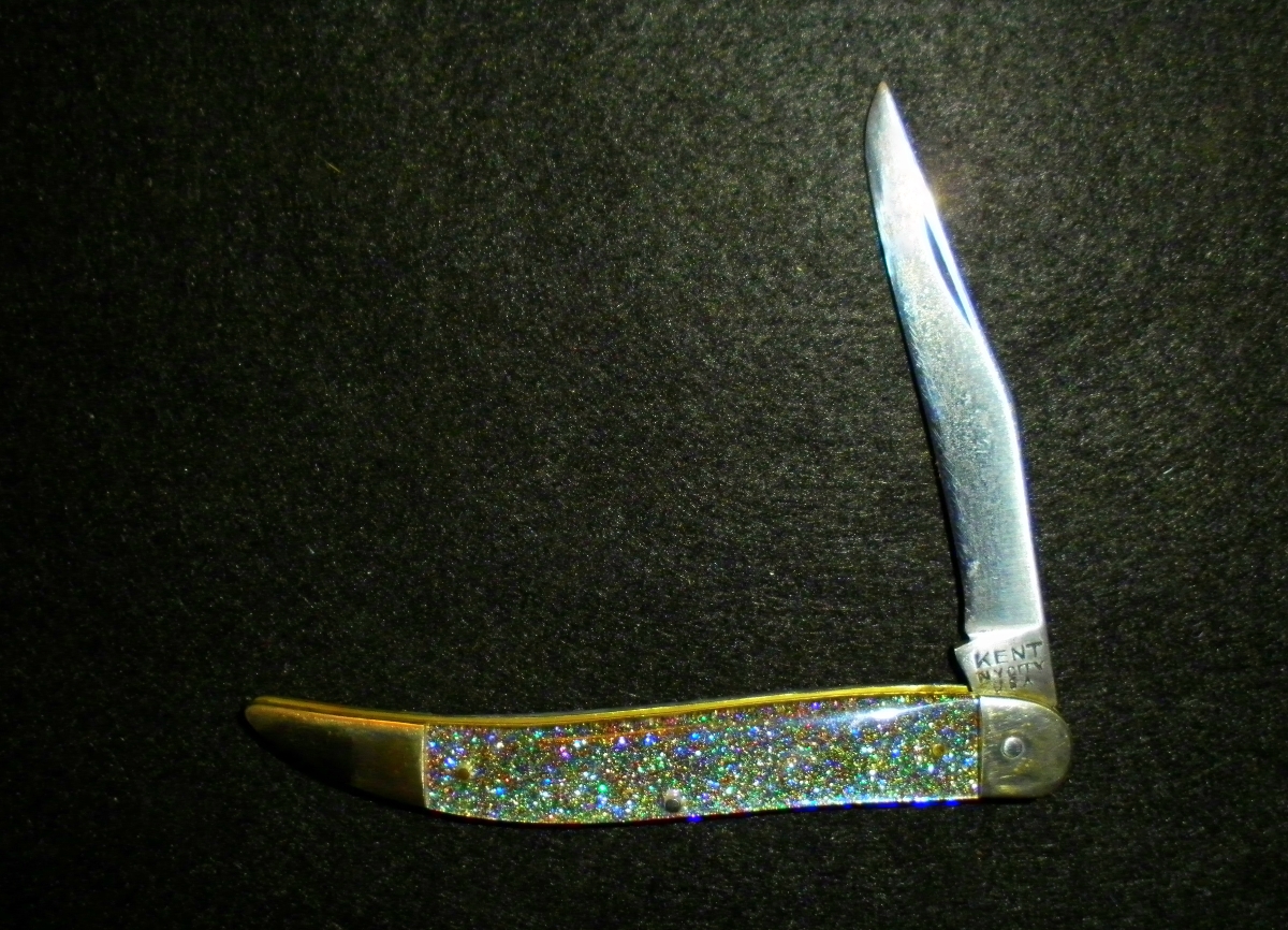

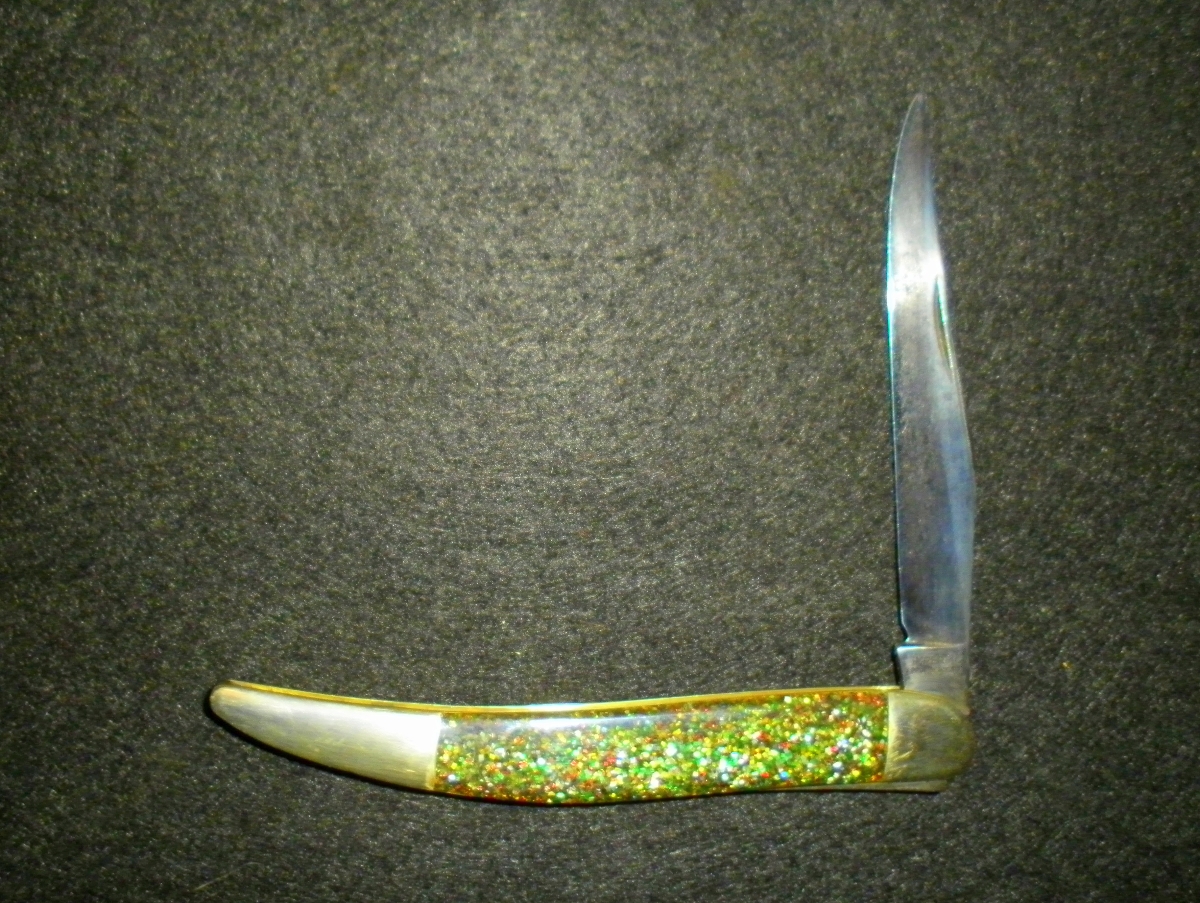

Here's one I did using fiberglass resin and just regular craft glitter.
WB
Thanks Joe, I hadn't thought of it like that.
WB

Rob I really like the glitter effect. Makes a nice looking set of handles.

That is a spectacular looking knife the way you did that! Really nice material for when you are looking for something different.whitebuffalo58 wrote:OC, I too have found the ss material too brittle for smaller knives, even more so then MOP. I have used it successfully on larger knives like Buck 110's/112's and Schrade LB7's and 6OT's.
WB

Thanks Phil and OC! I haven't field tested it, but it should be durable and it won't off-gas like celluloid.

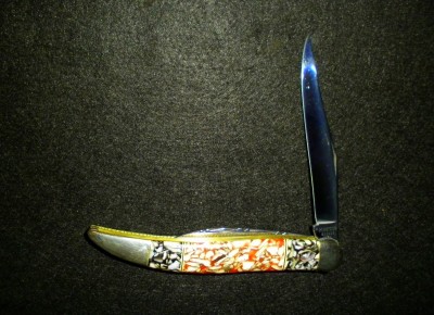

Here's a knife I did with a colored resin base and chips of fresh water mussel shell that I picked up down at the lake. It's basically the same thing as terrazzo.
WB
WB

Dang Rob! I had no idea that you're such a talented "arteest". Good job buddy.

Cool experimenting!

Rob does excellent work.

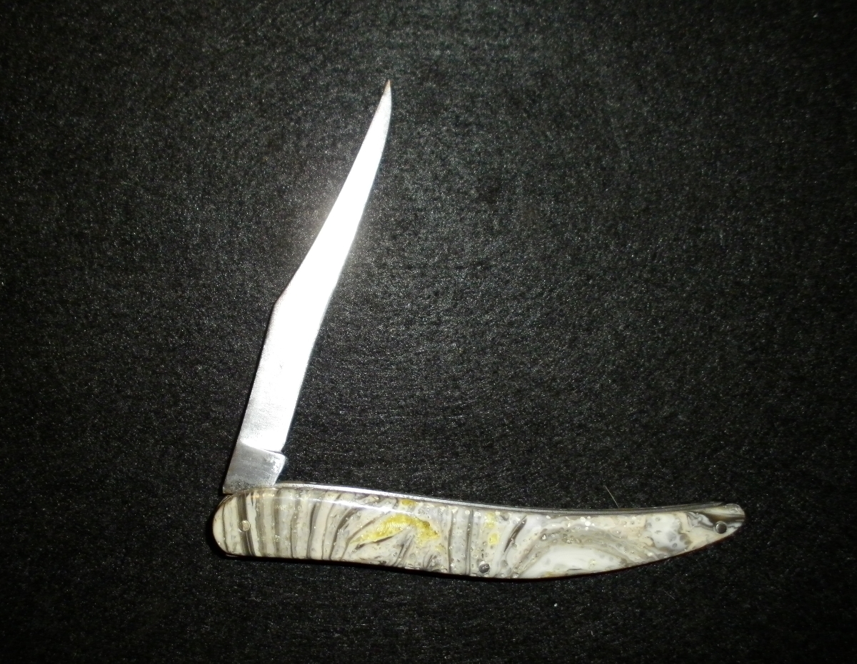

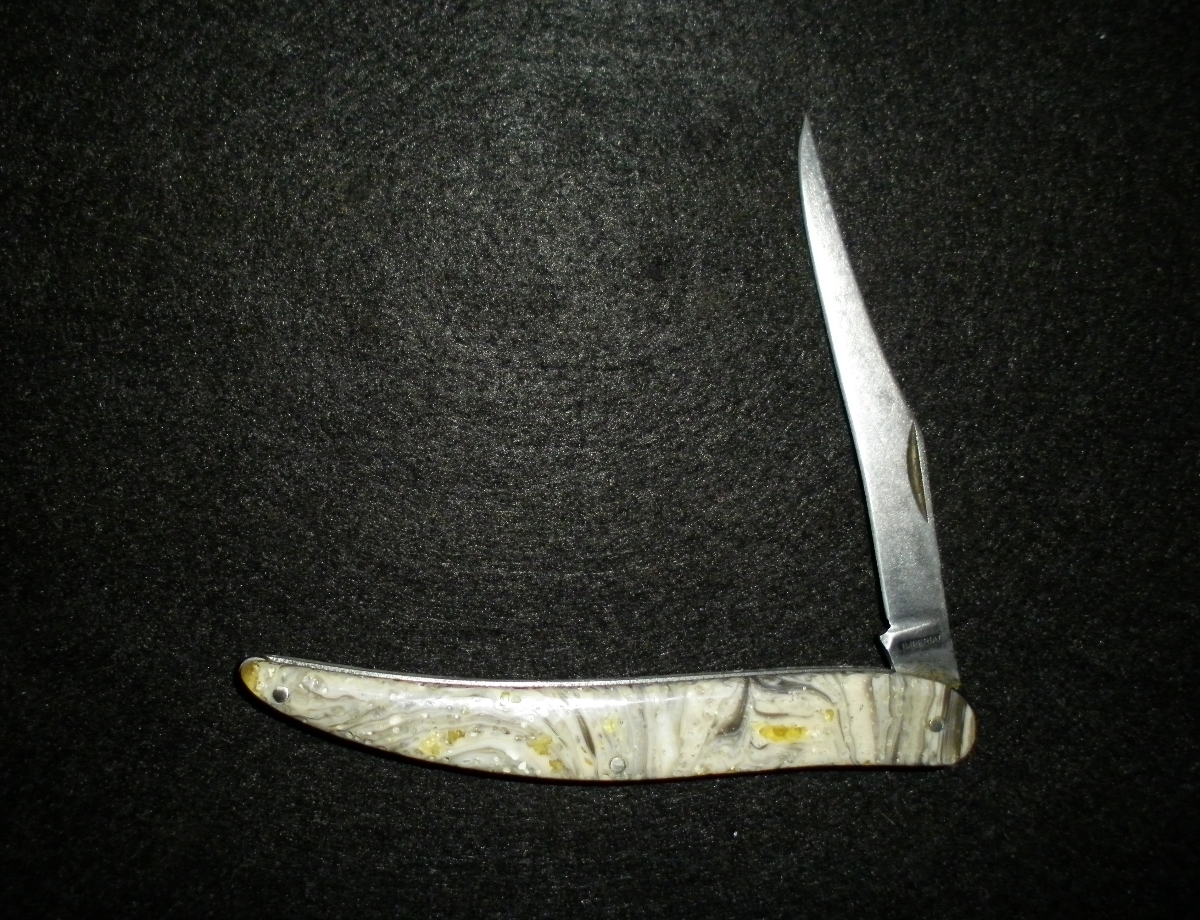

The first knife is done with Formica(it used to be known as Surrell) brand solid surface adhesives, they're color matched to the specific materials you're using. The glitter set is just Bondo brand fiberglass resin, available almost anywhere they sell that sort of thing. It's green when you first mix it, but turns an amber color over time. The Terrazzo style is Key brand epoxy resin, it's available in several colors and seems to hold that color forever. You can get different aggregates from them also, but I had a bunch of mussel shells I had picked up, so I made my own. You could use virtually anything.

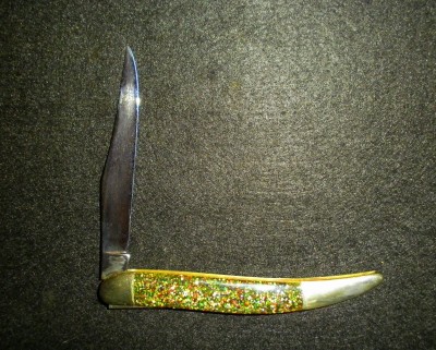

Here's another shop made material and a different take on Christmas tree handles.
3/32" Lexan. Spray on a wet coat of clear gloss acrylic paint, sprinkle on glitter of choice, clamp under wax paper and a block of wood to press it in. After it dries, tap off excess glitter and apply a final wet coat of acrylic to seal it in. Pretty much works like any other acrylic from there.

I like it! You could retire if you made a real christmas tree substitute.
