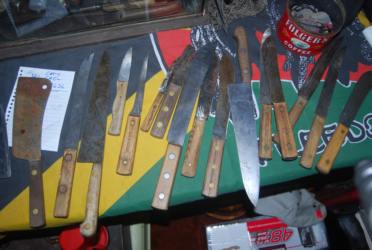

Hi; I'm gonna be laid up for a while in the near future, and I'm trying to get some projects lined up so I don't have to watch "Days of Our Lives". One thing I was going to try is re-handling some old carbon steel kitchen knives. I read somewhere that I could just epoxy the scales on, but I think they look better with rivets or screws in them. I'm looking for suggestions; what to use and where to get them. Keep in mind I'm a rank beginner so easy is a definite consideration but not required. Thanks for your time.

Barry, those knives look like they have a lot of potential. The handles on a few of them look pretty good.
What will you haft them with and how will you process the blades?

I was gonna try pecan with brass rivets. I was given a couple of 3"x 4" x 4' pecan planks a while ago. It seems like a dense fine grained wood and should polish up pretty nice. Thanks for the responses and the good thoughts.
