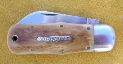

I just won a single blade GEC that i cannot find in the GEC website in "Production Totals" or "Collect By Pattern".
https://www.ebay.com/itm/GEC-USA-Tidiou ... true&rt=nc
The listing title calls it "Lumber Jack" which is pattern #45, and "Whaler" which is pattern #46.
The only single blade barehead in either of these patterns is in 2012, in which there were 3 different handles but none in this type of bone. In 2012 there are two, 2 blade #45's, in Pioneer Bone & Frontier bone.
Note seller calls this "Frontier Bone" but on the GEC website it resembles "Pioneer Bone".
After winning i emailed the seller ("knifegirl", former part owner of GEC):
"Hi, is this a #45, Lumberjack ? or a #46 Whaler ?
I just looked at GEC website 'Archives'. They do not show a Primitive bone Barehead in either a 45 or a 46.
Was only this one made, not a run ?
Is the pattern # & year marked on the knife ? "
And received this reply:
"It's not primitive bone its frontier bone"
Why did she not answer about pattern # & year ?
Could this been one of the 2 blade 2012 #45's with the saw blade(useless) removed ?
On a 2 blade #45 is the pattern # on the secondary ?
I should have thought about this before bidding, but i didn't.
What do you think this knife is ?
kj

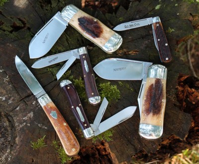

Kj, there is a Rendezvous every year, usually around the first week of August. I like your knife and i think you got a pretty good deal considering how much these monsters are bringing. Funny thing when these knives were first produced they sat around the dealers for quite some time. Here is a pic of part of my haul from the 2016 Rendezvous, lots of great knives trading hands but what makes it really great is the people you meet, a lot are members of the forums.

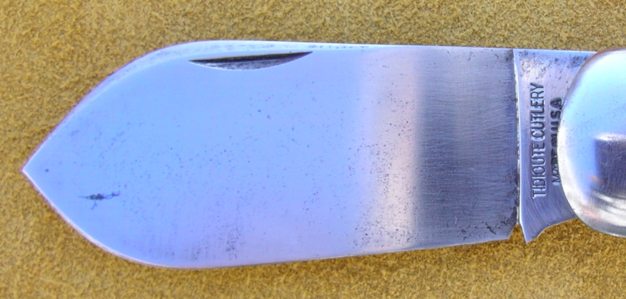

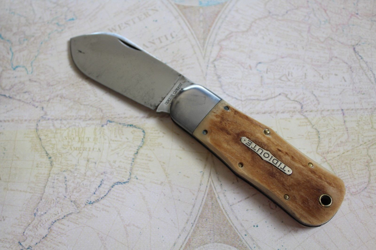

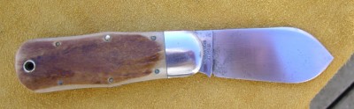

O.K. i picked up this "Whaler/Lumberjack" yesterday.
I like it ! The handles of "Frontier Bone" are more attractive than listing pics showed. Being a single blade & barehead keeps the weight down a little and makes for an actual comfortable fit in hand. I can only see "45" of the pattern number, rest is hidden by the bolster. Length is 4 3/8". Depth of blade, spine to edge at max is 34mm. (easier here to use metric to be exact).
If you have a #45 pattern is this the same 'depth' as on your knife ?
It is supposed to be new but the blade has fine scratches running length of blade, both sides. Close to tang and blade edge there is black 'staining' still present. Not sure if this was patina or early rust ?
Do Rendezvous knives come with 're-worked' blades ?
kj
