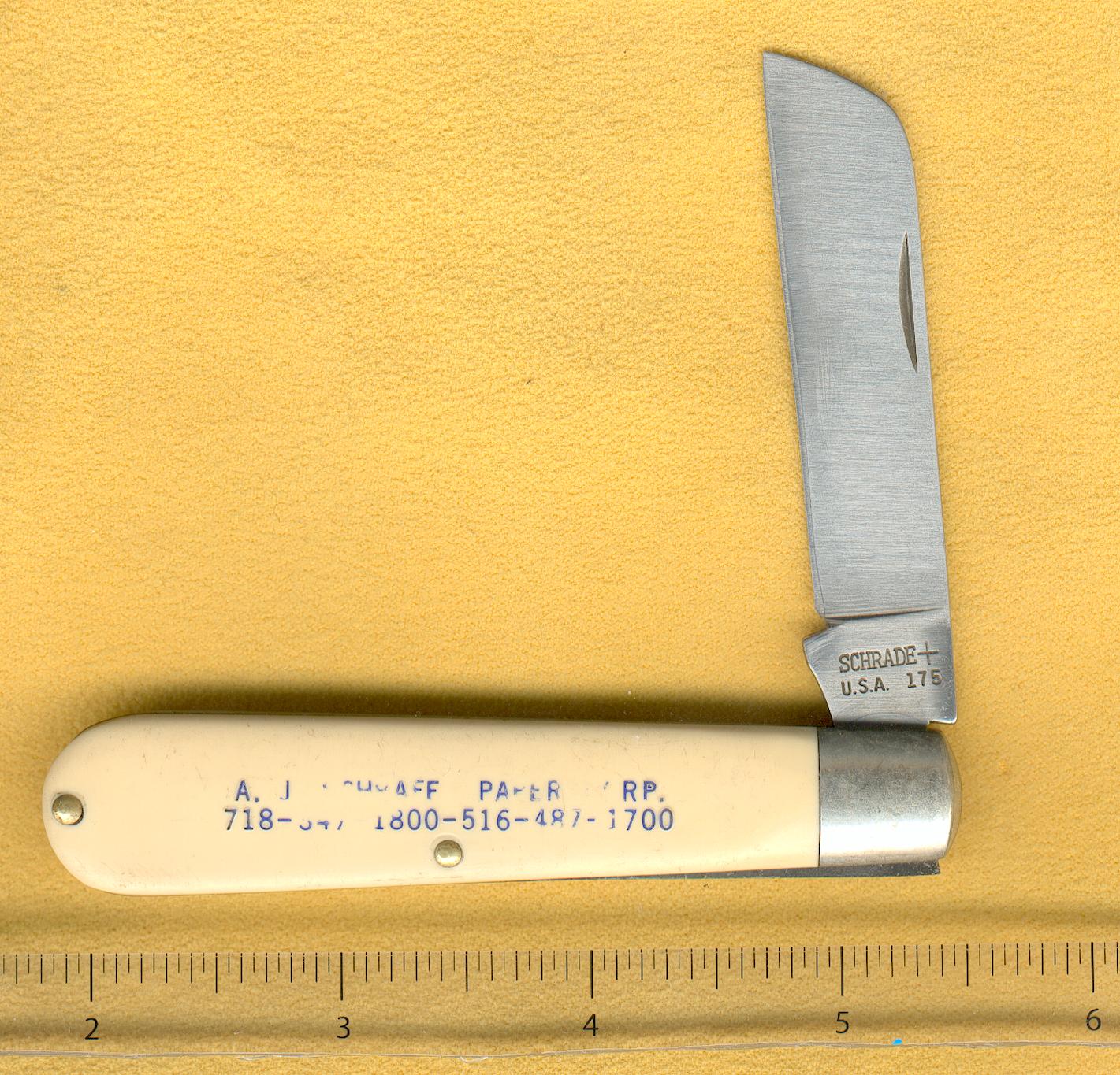

Having taken a few knives apart, I am familiar with cutting the pins with a slim tough blade tapped through, but I don't know what to make of a Swinden key!!
So I have two questions. I thought I would attempt to rehandle a knife, and thought this simple barehead jack would be a good candidate. Is it a standard pinned knife?? I can't find any sign of a rivet in the bolsters.
If it is a "keyed" knife, how do I take it apart without ruining it??

I would just grind down the pins to pull the covers off and take out the two pins. Then either way you will know how the pivot is made.

It's swinden I recently rebuilt a couple of those florist knives. I would take a dremel and carefully remove the heads of both rocker and butt pins on one side and tap out the other side with a pin punch, then slide a thin bladed knife underneath and pop the handles loose v(the will still be one handle pin holding them on) and if done correctly you will have a set of surplus scales that you can use in the future and a knife with no damage ready to be rehandled. Good luck

aye, now looking at the picture I see it doesn't have a scale pin like I had first assumed (the third pin I spoke of doesn't actually exist on this particular knife) The handle is probably molded into the liner, camillus done this alot on thier knifes as well. Just slide a thin bladed knife under it and pry the handle off. It should bust away fairly easy, if not shear through it like you would a pin.
