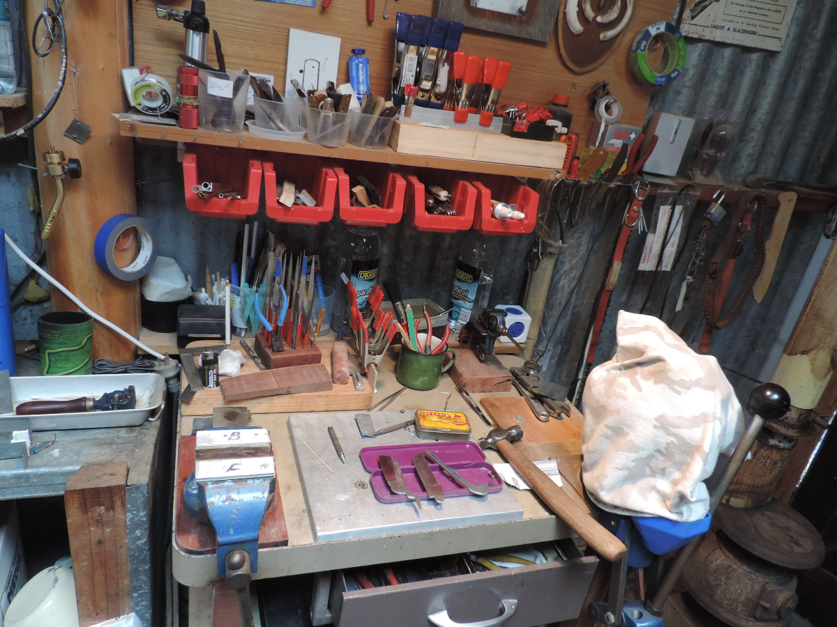

For anyone starting out at this caper I'd suggest get yourself some clamps all sorts & sizes ... and when you think you have enough ... get some more.
Also storage ... tins, tubs, boxes, whatever you can lay your hands on and label the outside - other wise you'll spend half your time looking for stuff.
This is my main work area...
Also if you don't have it ... have a go at making it.... under all this is my Home made stiddy. Made from a small gauge railway track.

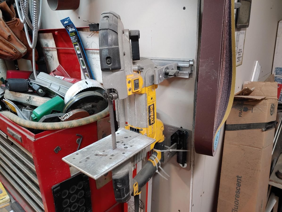

At some point your going to have to cut steel and a metal cutting band saw imo is a must. I looked all over and couldnt find one for what I needed at a price I could live with. Last fall I got a set up from swag thats perfect for what I need. GOODBYE HACKSAW

It would be wonderful to have a band saw just for cutting metal, but I don't have the room for two band saws! I cut most thicker metal with a fiber cutting disc on a Dremel or a larger on a bench grinder.

I saw them using these on Forged in Fire. I intend on selling my band saw and table saw and buying one of these. They wouldn't take up much room and would be handy for other things as well.

@orvet, the swag bandsaw is small. The table is maybe 1 foot square and the handheld bandsaw is also small if you had to make room it comes apart as easy as removing one bolt. They make a table that goes in a vise. They also make a table that goes on a truck bumper. Fits on the ball.

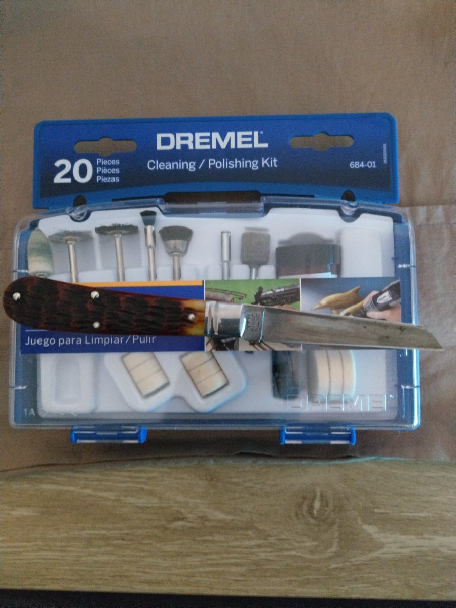

A good tool box with easy access to tools is a must, in my opinion the first thing you need and often under estimated. Having everything in one place and together and knowing where everything is was taught to me by my father and oldest brother, he was a builder.
I bought this polishing and grinding kit as it was just so cheap[ $14US ] and useful, it has a polishing compound and is invaluable not just for knives but many other things around the house. ::tu::
