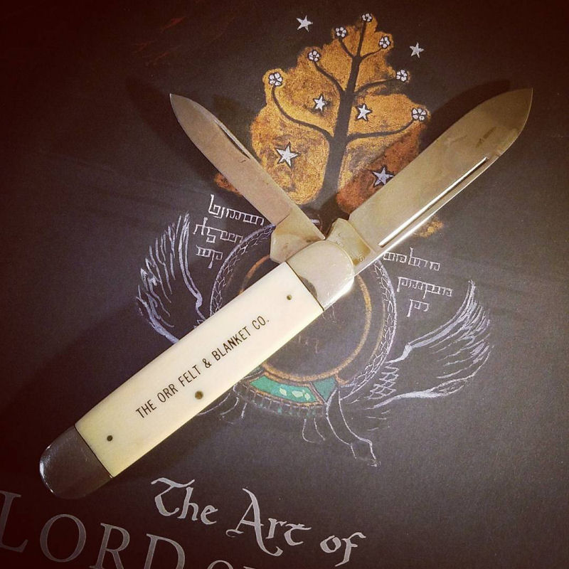

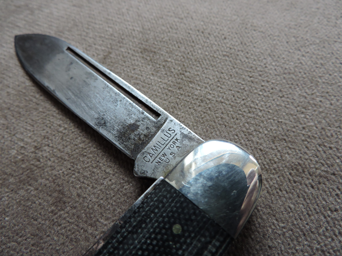

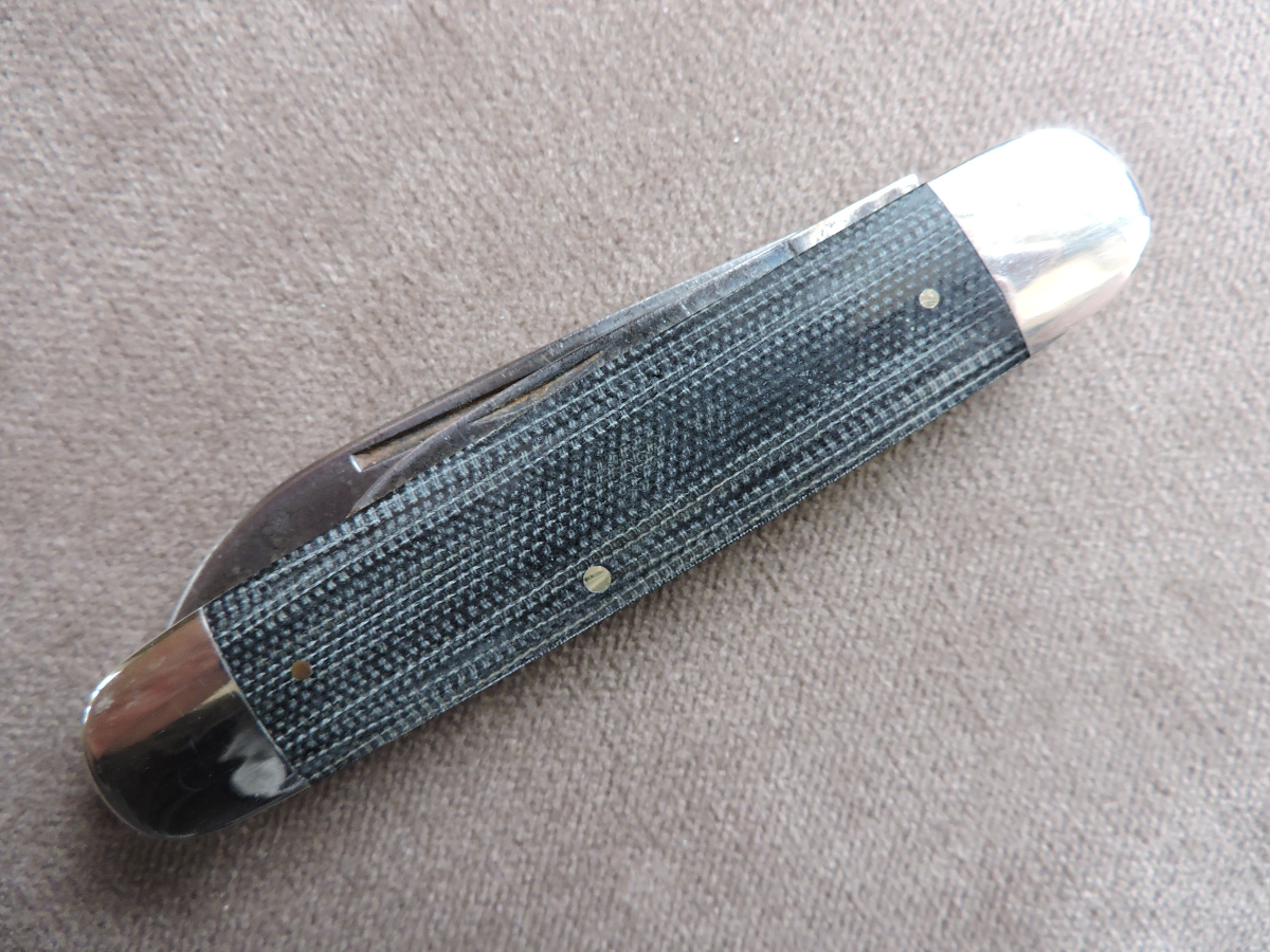

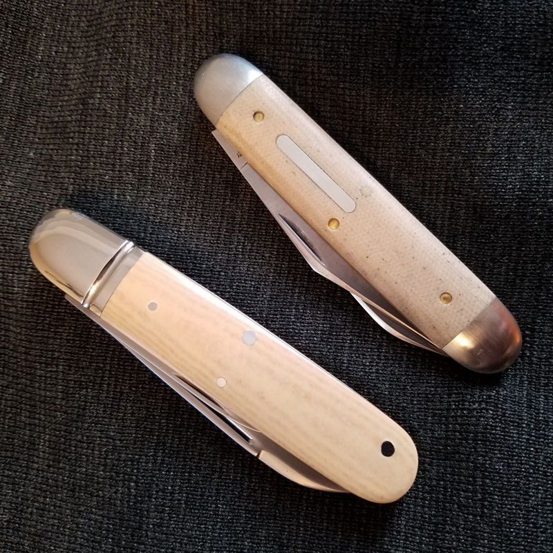

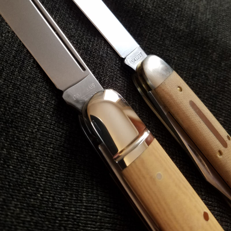

Sometimes bigger is better, right? I've been carrying around a GEC #54 for a couple weeks, then I remembered I had this half finished short line Camillus #23 down in my project bin. I picked it up a year ago on the cheap at a flea-market with the intent to do something with it. Those old "French Ivory" scales were never really built to last, and the blades were just starting to show signs of neglect, despite being almost full
Anyways, last year I took everything apart and build some new liners for it (.04 nickel silver, so a bit thicker) with some long bolsters (double pinned and soldered), then cleaned up the blades (very fine stonewash with porcelain media - left the blades kind of a cloudy grey matte finish. I liked it) but then it sorta just sat in a box.
Anyway, this past weekend I felt a bit ambitious, so I went down and put everything together with some antique ivory paper micarta and Nickel pins. The new frame is about 1/16" longer than the old one on the front end, so it clocks in around 4 1/4" long. Blades behave exactly like a good slipjoint should (7/8 on the pull, super smooth with half stops, awesome snap open/closed) and it's just a hair heavier than the 54 while being pretty much the same thickness.
I'm gonna call it a "Cigar-low"

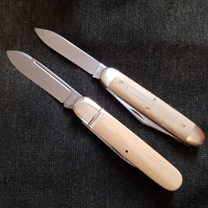

Here it is compared with a Great Eastern #54 (muslin micarta from KSF)

Those look great!

Adam, the #23 is a great canvas for modifications and you did that one proud.

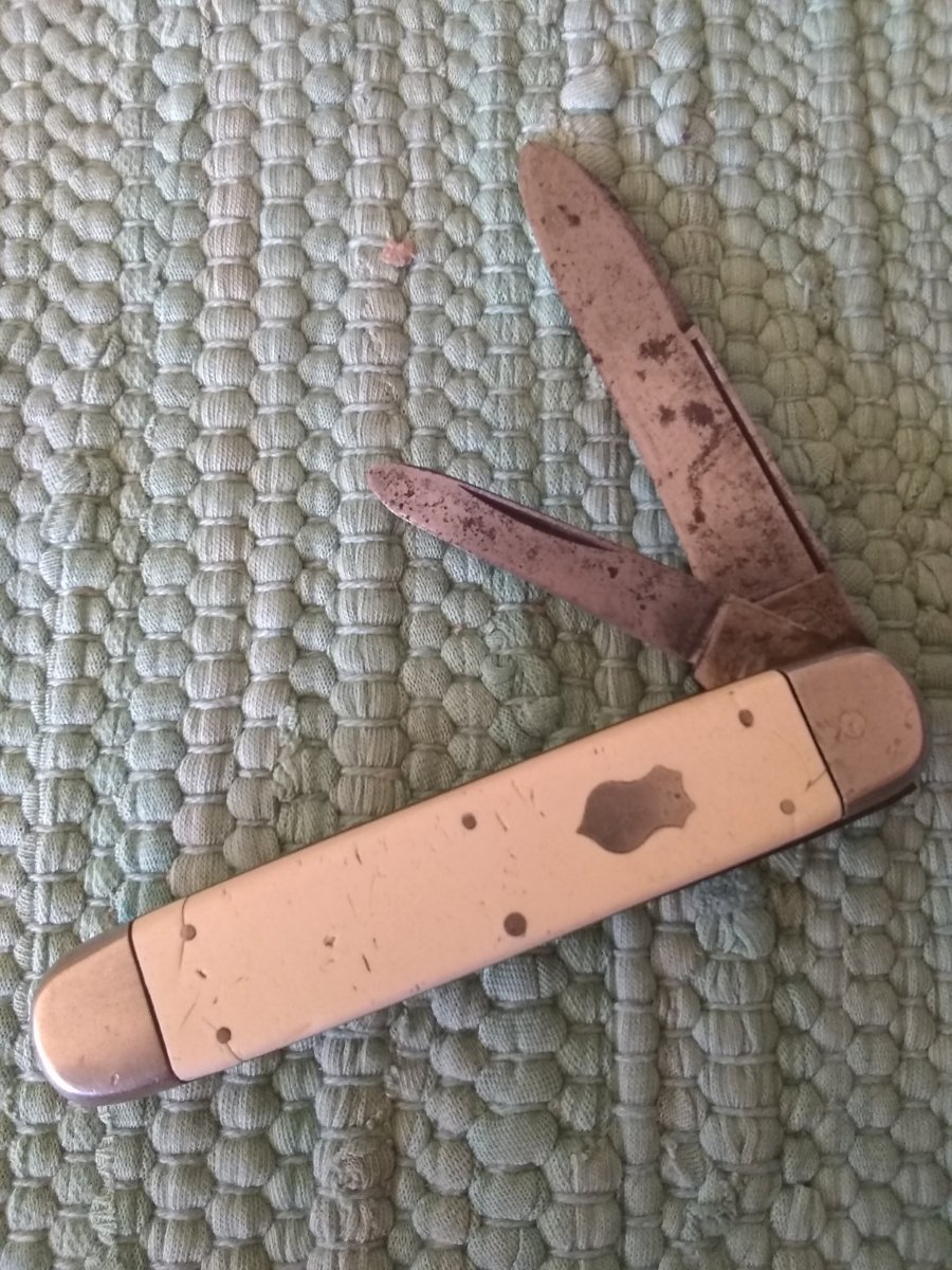

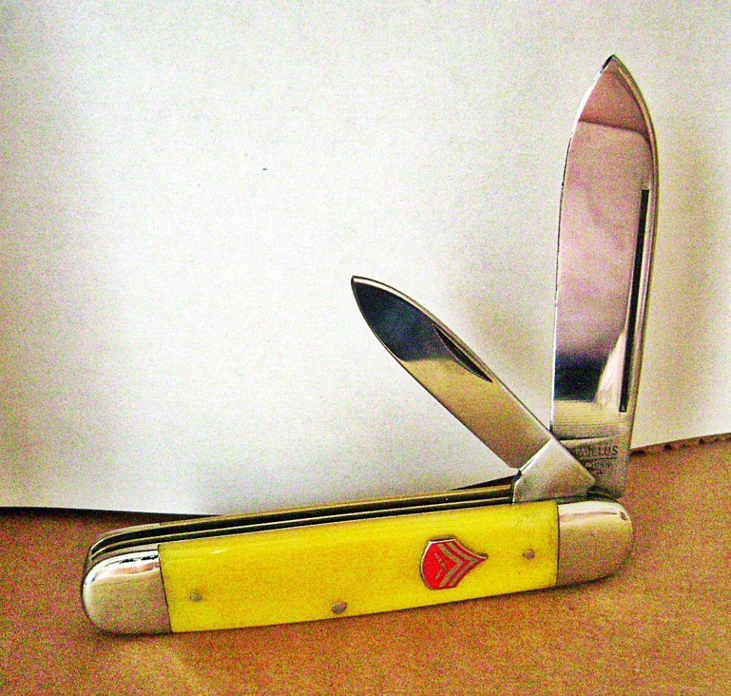

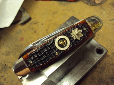

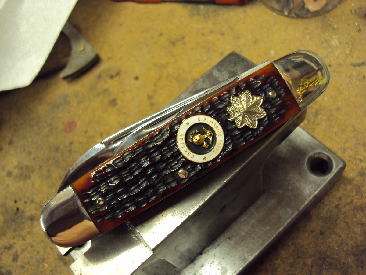

They may be even better than the Electrician's knives. I've been involved (maybe semi-involved is a better term for one of them) with the modification of three. Glenn did all three and for me, all are "OMG".
The one he did for me. The one we did for Tommy (Carrmilus) The one he did for his B-I-L's retirement from the Corps.

The 23 is an under-appreciated pattern. I love what you did with yours, Adam, even taking things further by new bolsters and liners. The micarta has a great looking grain to it. Sweet!
Jerry, thanks for posting those. That Thunderbird will always be a favorite build of mine!

Adam you did a killer job!

Wow, did that turn out great. The only way that knife would look any better is if it was in my pocket now! I have done a rehandle with the white paper micarta and have some black on hand for a future project. The paper micarta's are a great option for rehandles.Darksev wrote:Sometimes bigger is better, right? I've been carrying around a GEC #54 for a couple weeks, then I remembered I had this half finished short line Camillus #23 down in my project bin. I picked it up a year ago on the cheap at a flea-market with the intent to do something with it. Those old "French Ivory" scales were never really built to last, and the blades were just starting to show signs of neglect, despite being almost full

Nice inventive work on that 23, Darksev.

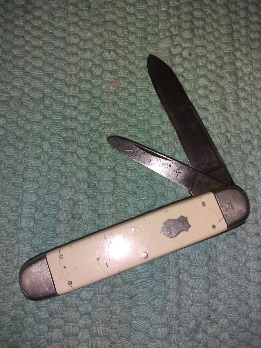

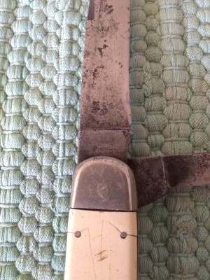

Joe, what is your issue with the handles? Other than they are just plain Jane, blah.
- FRJ
- Posts: 17133
- Location: Ct.
- jerryd6818
- Posts: 39458
Re: Camillus #23
Ahh. I've never seen that on a 23 but then I don't have a ton of experience with them and what little experience I have had has been positive.
- FRJ
- Posts: 17133
- Location: Ct.
Re: Camillus #23

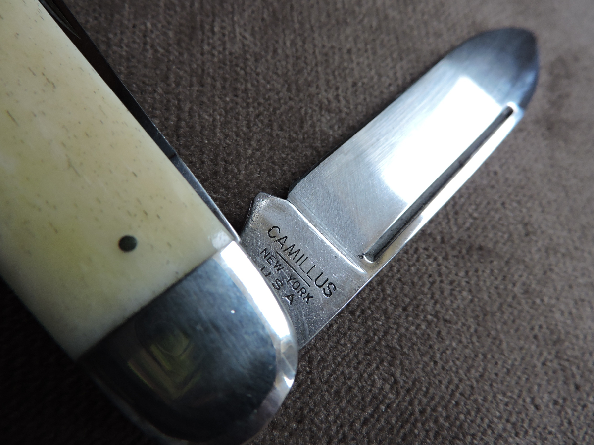

I've only had these two and in spite of the bad covers I thought the knife was worth having. For me, there is a lot to like about the knife build. It is a Camillus after all.
Each knife had a different material on the handles. French Ivory on one. Some other kind of toilet seat material on the other.
Both going south.
Both going south.

When I picked this up, it was because I remembered seeing that Yellow one Glenn did, and thought "oh, I could totally carry that".
Honestly, if I ever found one with the handles in good shape, I'd probably leave it as is - but that plastic they used, at that thickness, just never holds up on anything (scratches easily, shrinks, cracks, etc). That's part of the reason I'm not really a big fan of acrylic handles on knives. I think it eventually looks bad on just about anything but safe queens, and I'm still not convinced of it's longevity. Micarta on the other hand, I know lasts damn near until the end of time.

That is an awesome remake! I do like that micarta handle and the cigar-low is pure genius! Keep up the awesome work!

Incredible job on that jack, looks like a custom! Those bolsters are amazing, especially the rat-tail

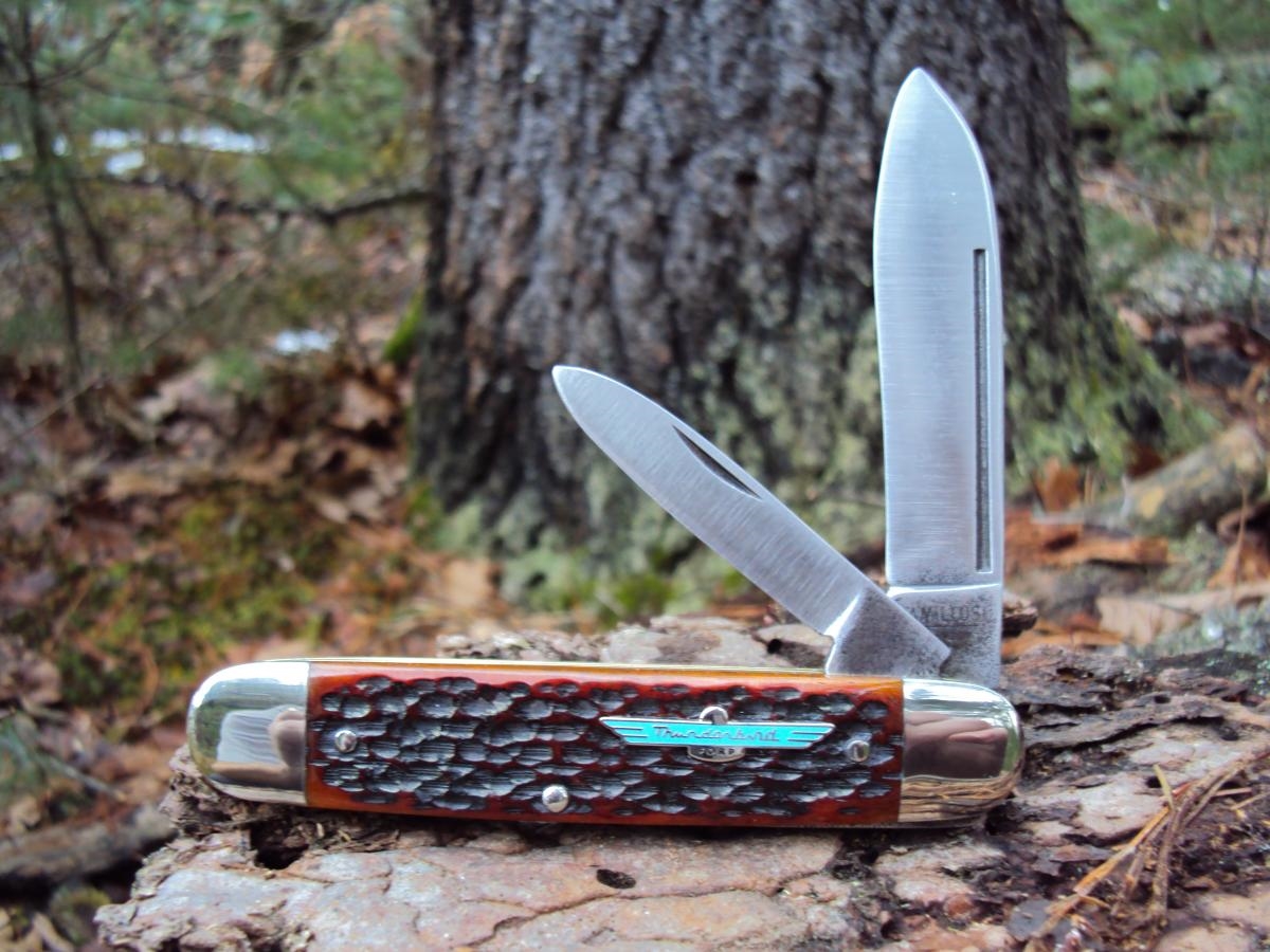

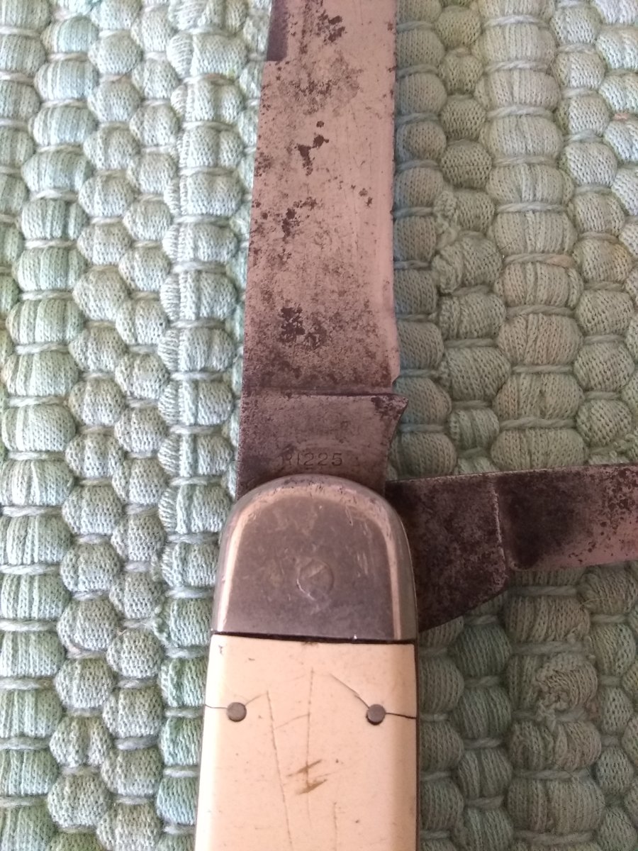

On the large side at 4 3/16" but I'd carry it.
They remind me of this Remington R1225 (4 1/4") I have that I might get re-scaled. Thanks for the link, herbva!
