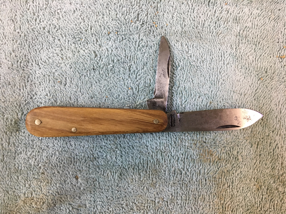

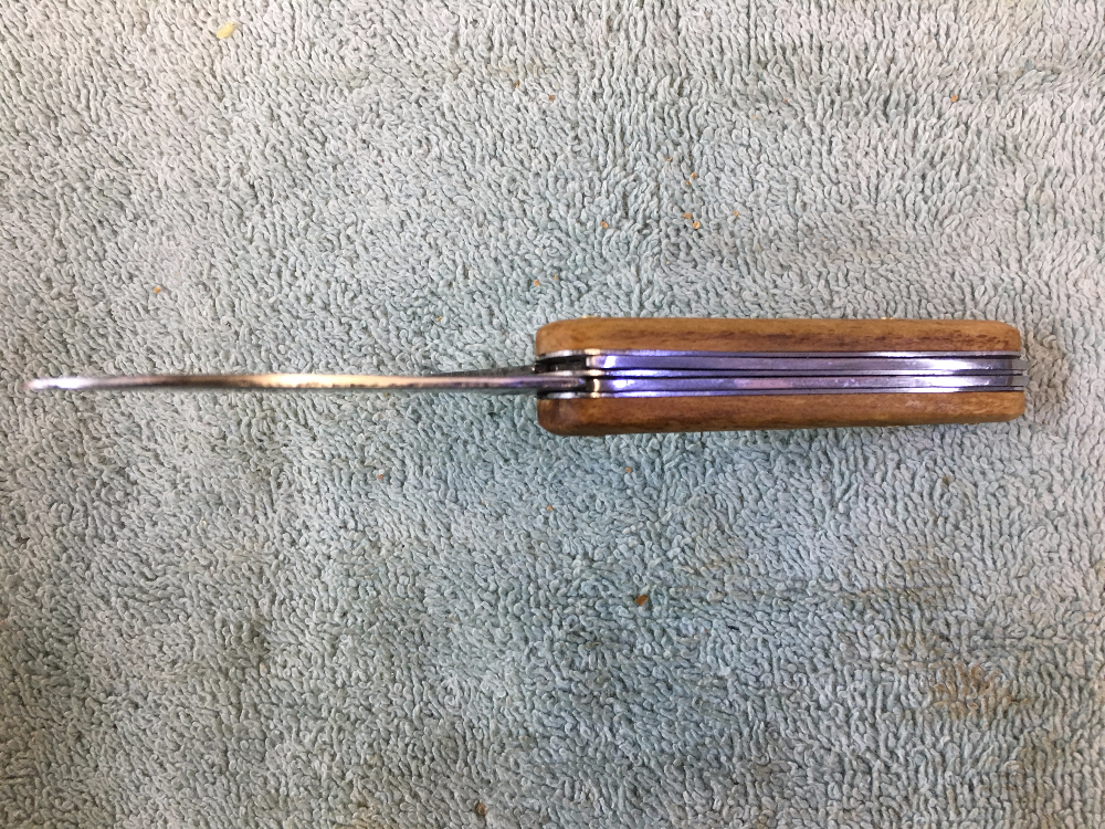

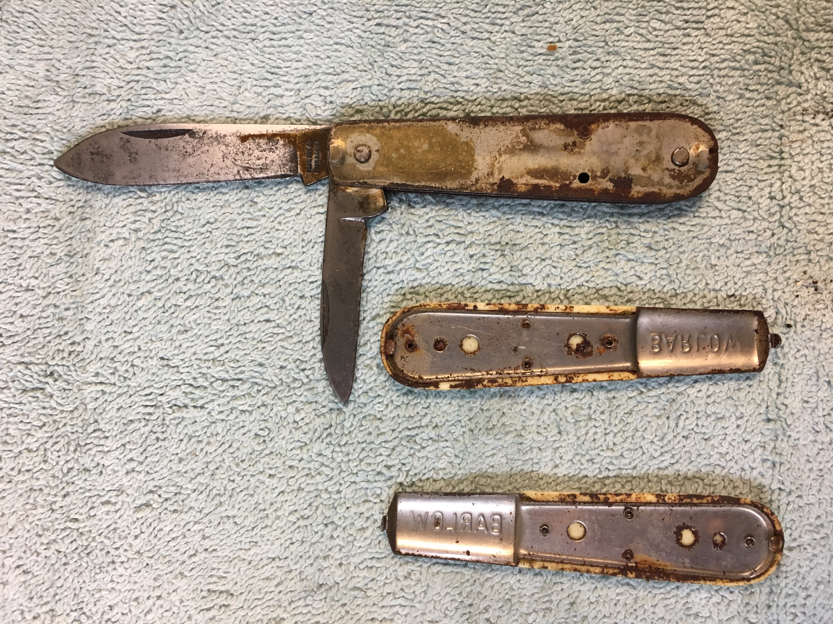

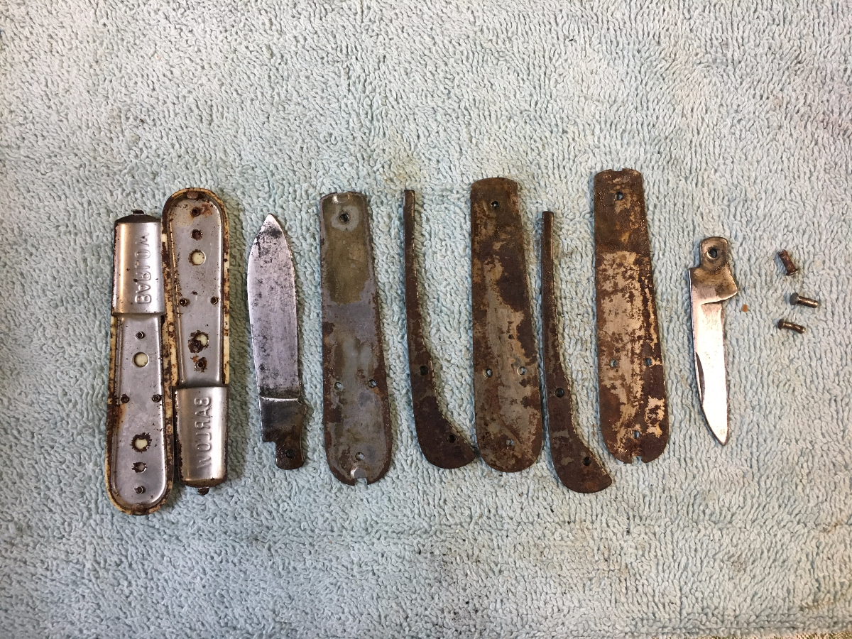

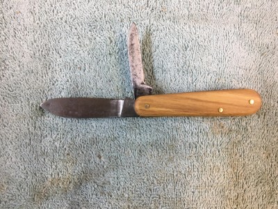

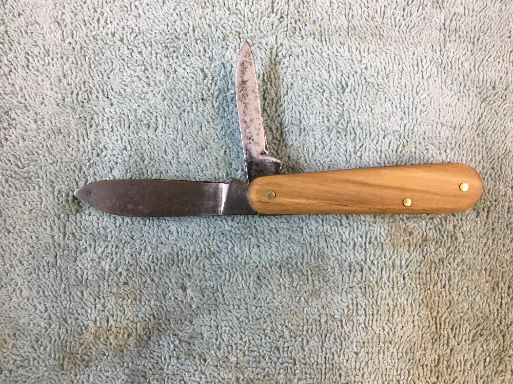

I disassembled another one of the Barlow style knives that I received in that last E-Bay lot. The blade is marked but I cant make it out even under magnification. This was another one with the shell handle and hollow bolsters. It was rusty and dirty but there was some blade life left so I decided to try and breath some new life into it.
Initial teardown showed some rust but nothing too extensive; I opted for olive wood handles. It was the first time I had worked with olive wood, its extremely hard and exhibits some nice grain patterns. This time around I just rubbed some oil into the scales as opposed to sealing them with polyurethane; It turned out okay. I'm having trouble figuring out how to finish polish the pin heads after assembly without getting black residue rubbed into the wood grain. A pin spinner is one solution I guess but I haven't had alot of luck with that approach yet.
I'm sure I'll figure it out by the time I get to the 5th or 6th knife!
Thanks for looking.
Jeff
Thanks for looking.
Jeff
