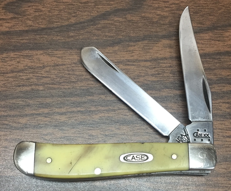

I worked on restoring this Case Mini Trapper last weekend but when I got to the scales.... well, I got stumped. This STAIN on the scales looks like somebody with oily hands has using it and didn't wipe it off. Well, no matter what I tried,,,, I couldn't get this stain to BUDGE.
Anybody know of something I could try to get this stain off?
I wouldn't worry about it too much but the scale on the other side is CLEAN. It wasn't stained like this one.

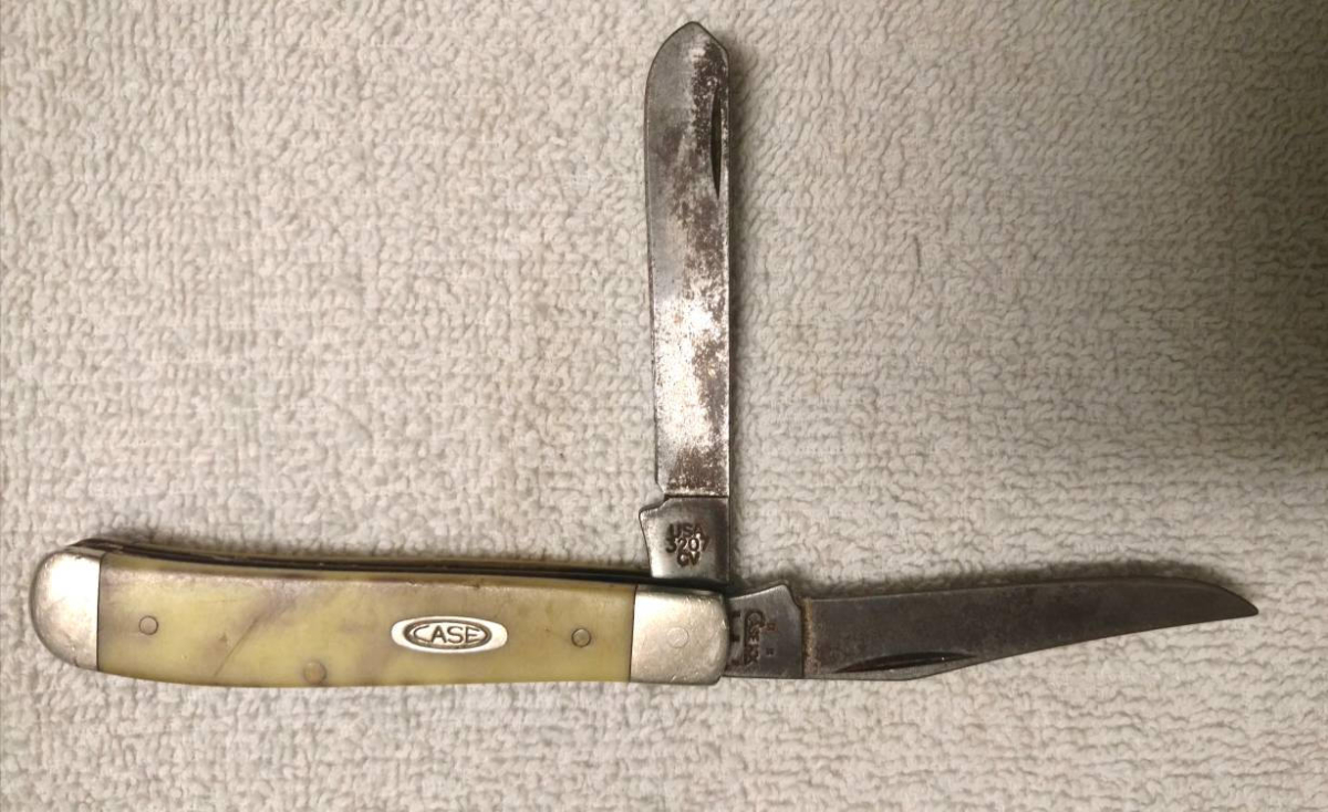

Before....
Up to now.....

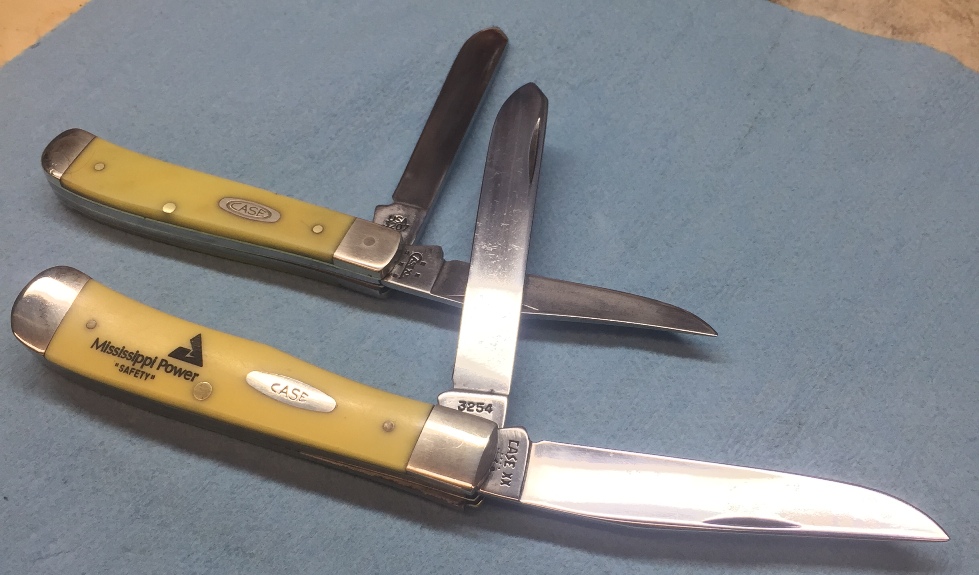

Well, yesterday I got a chance to get in my shop and work on this nasty scale again. I thought about all that was said and I decided to get some more Gojo and put it on a piece of 1000 grit sandpaper. The sandpaper seemed to hold the Gojo better than a rag. I worked on this side for about 30 to 45 minutes and I suppose the results are acceptable. I am sure the stain is in really deep in some areas and will never come out. You can still see some stain at the bolsters and around the shield.
Here she is.....

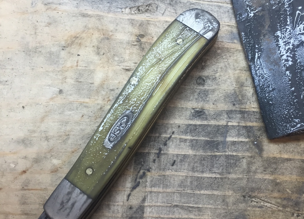

During clean-up....
After a while of scrubbing.....

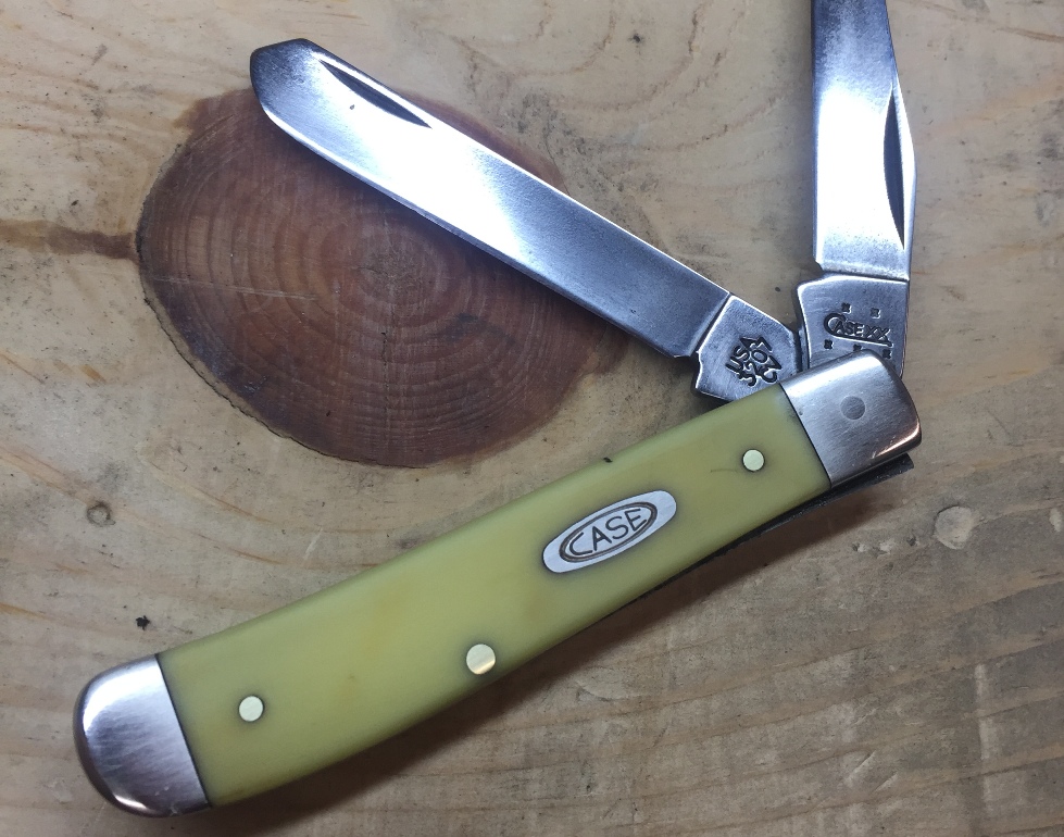

My knife next to my Bro-in-laws Case after I cleaned up both.....
Thanks for your help everyone!!
