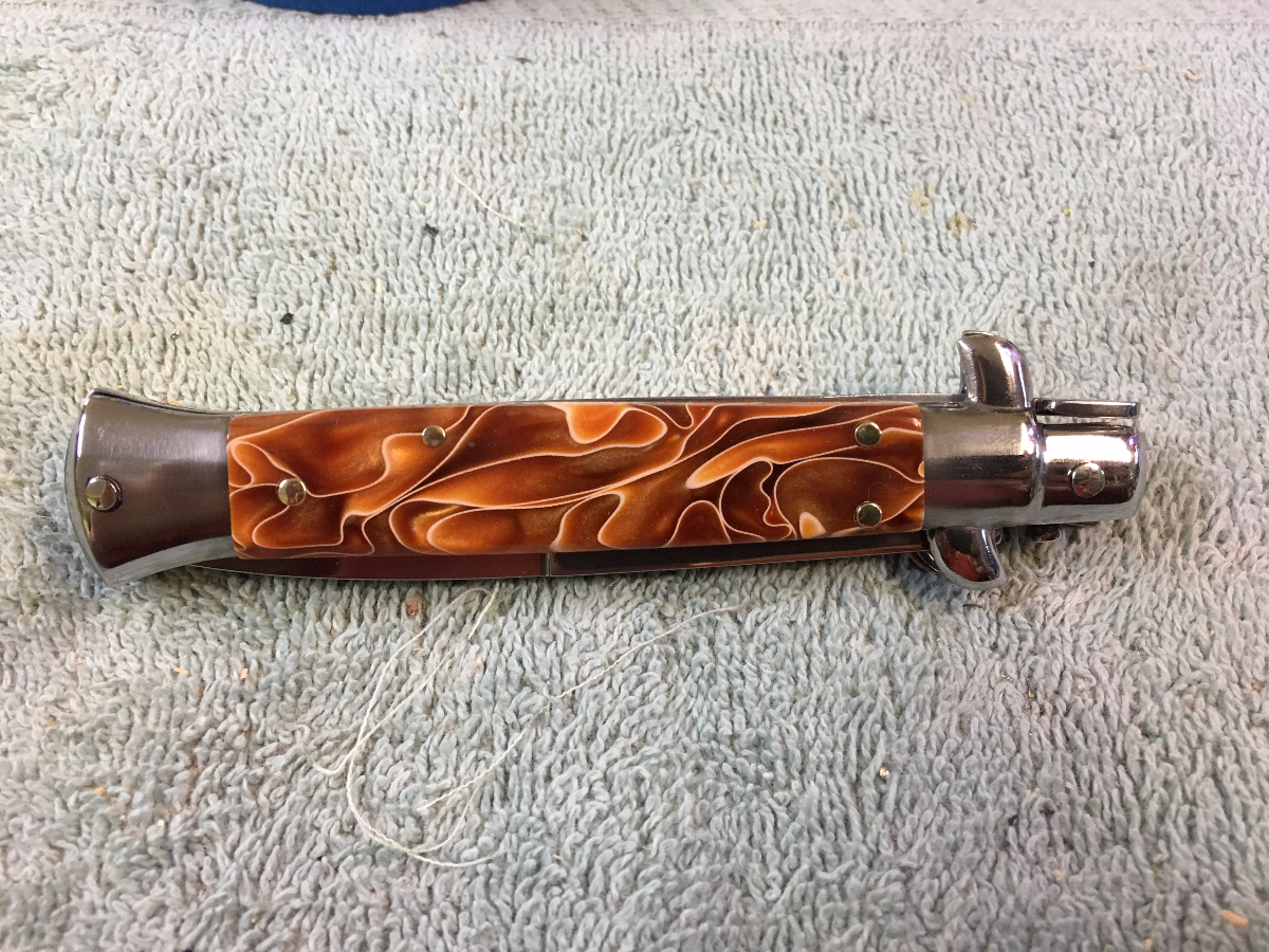

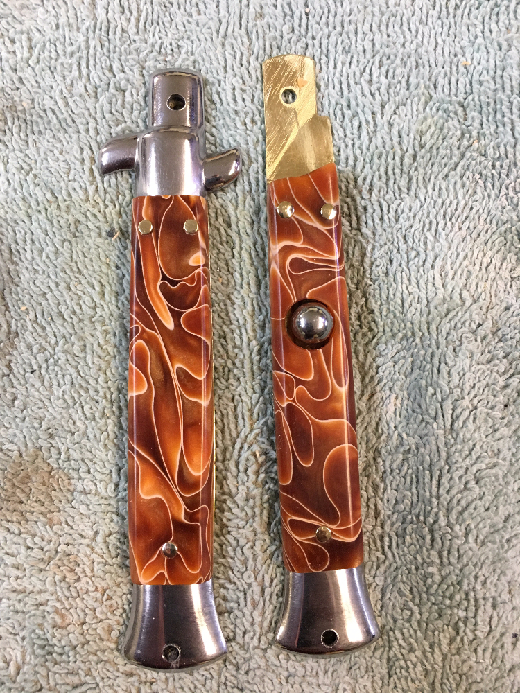

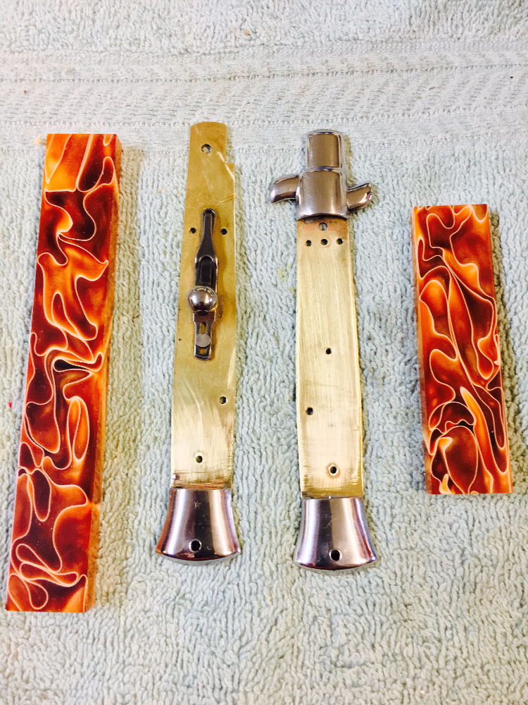

I had a few switchblade parts in a bag of parts that I bought previously so I decided to see about assembling it. Here's the liners with the bolsters soldered on and some highly visible acrylic pieces that will be used for the handles;

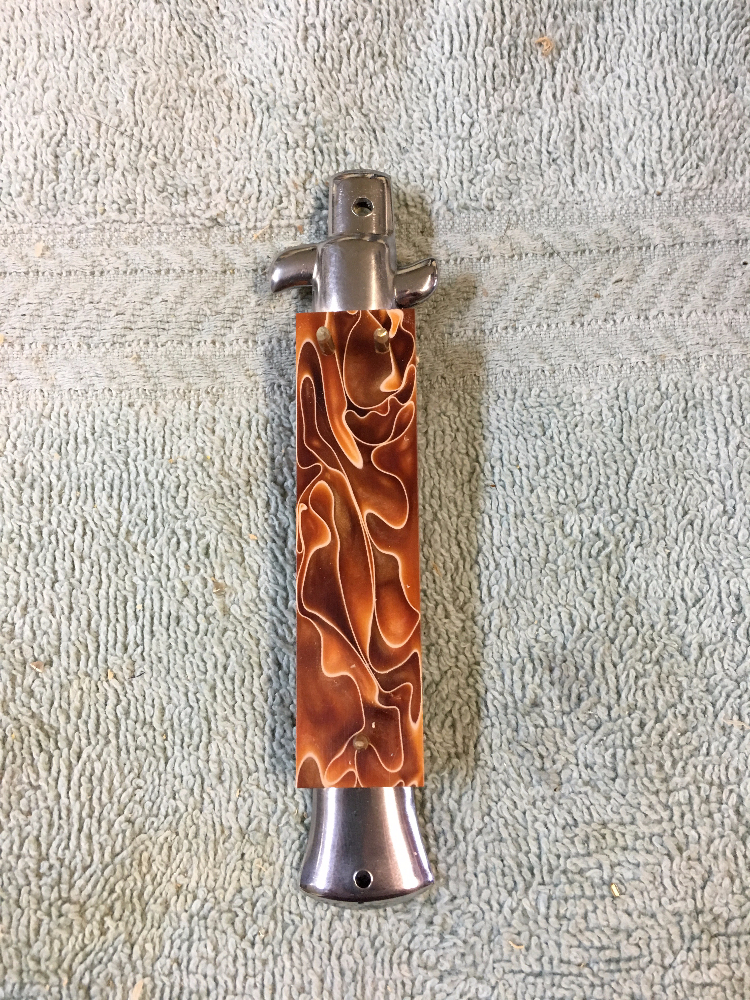

I cut and roughly fit the handle for the rear scale and pinned it temporarily in place;

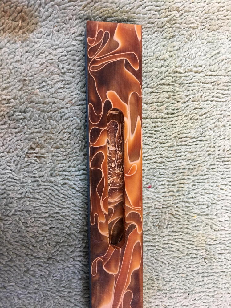

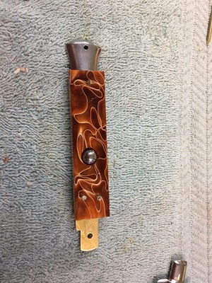

For the front scale there has to be a channel cut in the back of the scale. I use a trim router and table for this but other guys freehand this in with a dremel and bit;
Now there needs to be a hole for the button to come through. I usually lay the scale along side of the liner and draw a pencil line where the hole needs to go (there's probably easier ways to do it but it works okay for me).I use a Forstner bit to get the hole and then file and shape as needed to get the button moving freely;

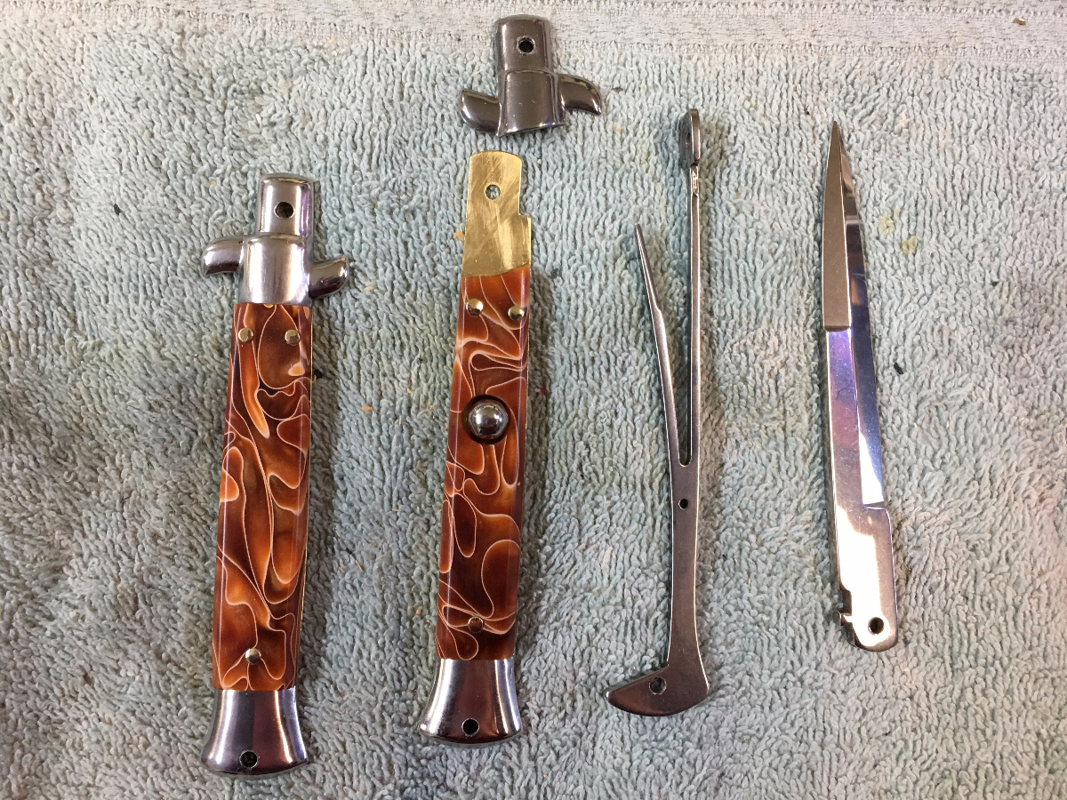

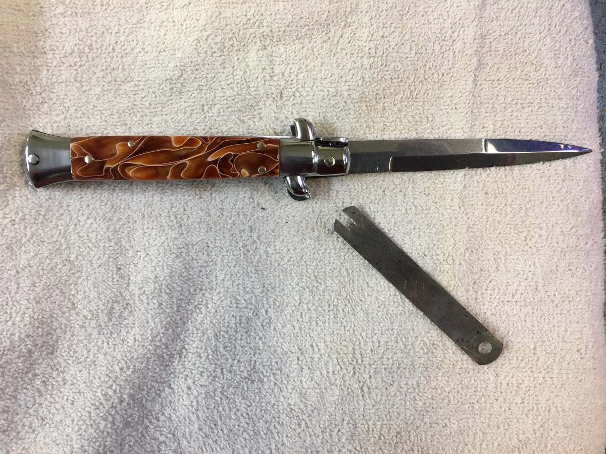

Here's all the parts laid out for assembly. It was during this stage that I discovered that the spring wasn't the corrent spring for this knife. It was close so I decided to go ahead and assemble the knife;

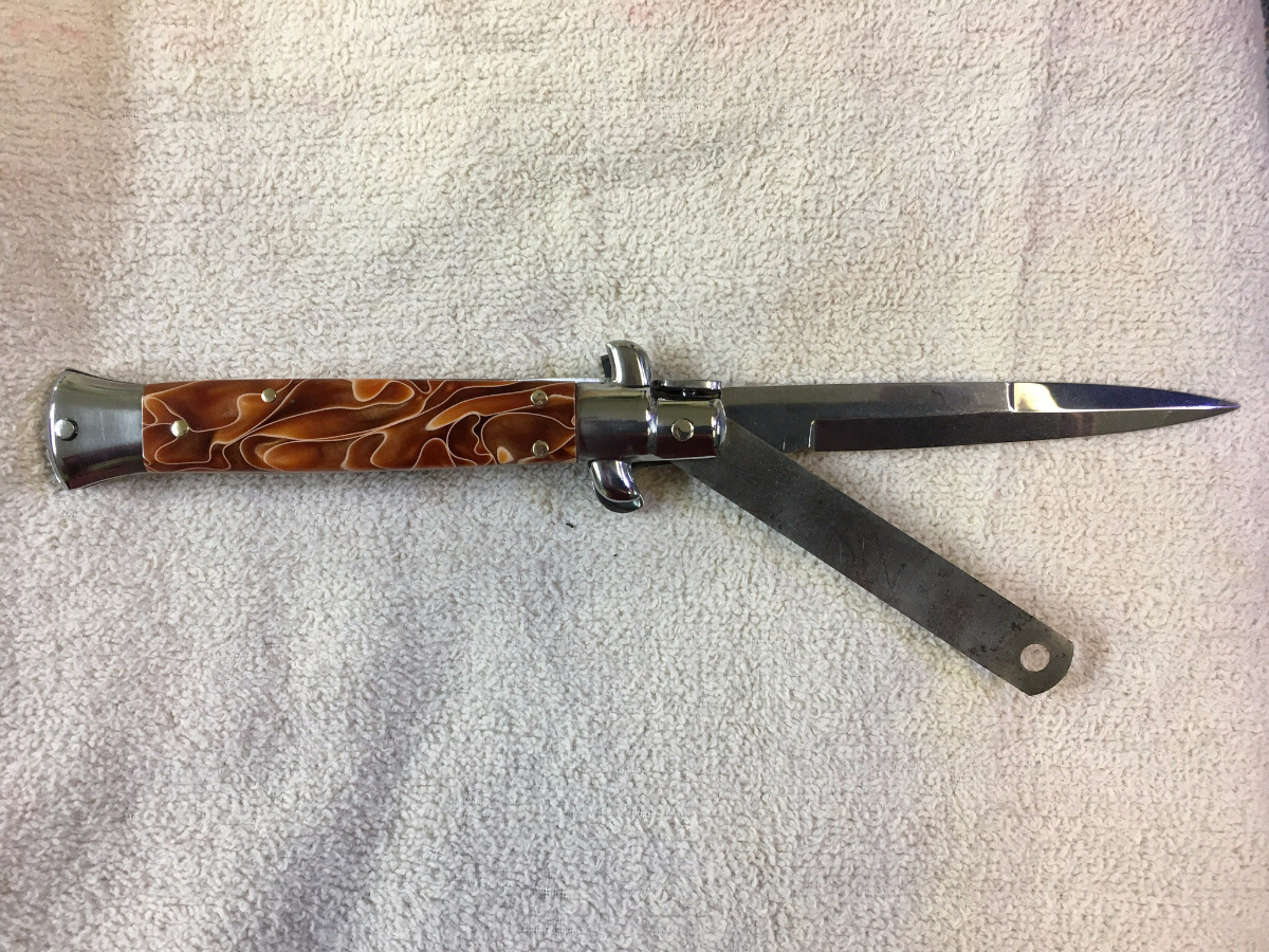

When I peen the pivot pin I use a .004 inch feeler gauge with a notch cut out of it, placed between the blade and the Liner to ensure theres enough clearance for the blade to pivot freely;

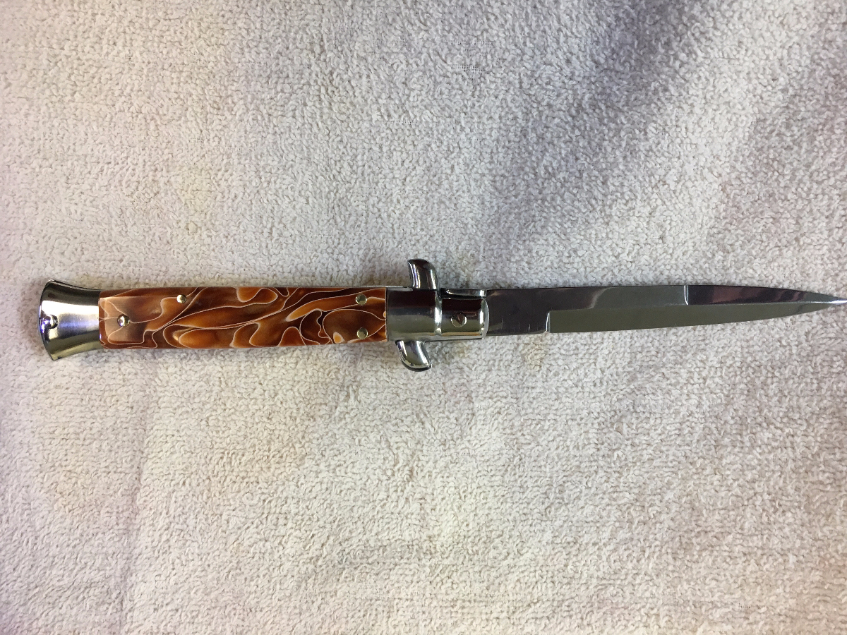

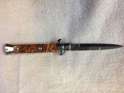

So here's the final finished pics of the knife. It still needs a bit of finish polishing but all in all it turned out okay;
I'll finish polishing the scales a bit more tomorrow, see if any pins need to be touched up and then its on to the next project!
