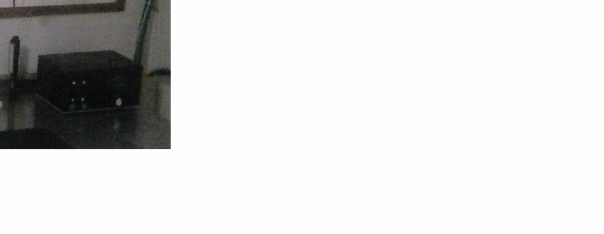

- americanedgetech
- Posts: 1552
- Joined: Mon Sep 04, 2017 1:40 am
- Location: Florida Pan Handle
Re: Which Buffing Wheels To Use
I can help with a speed controller if anyone needs information on how to make one for a 110 or 220 volt single phase motor.
