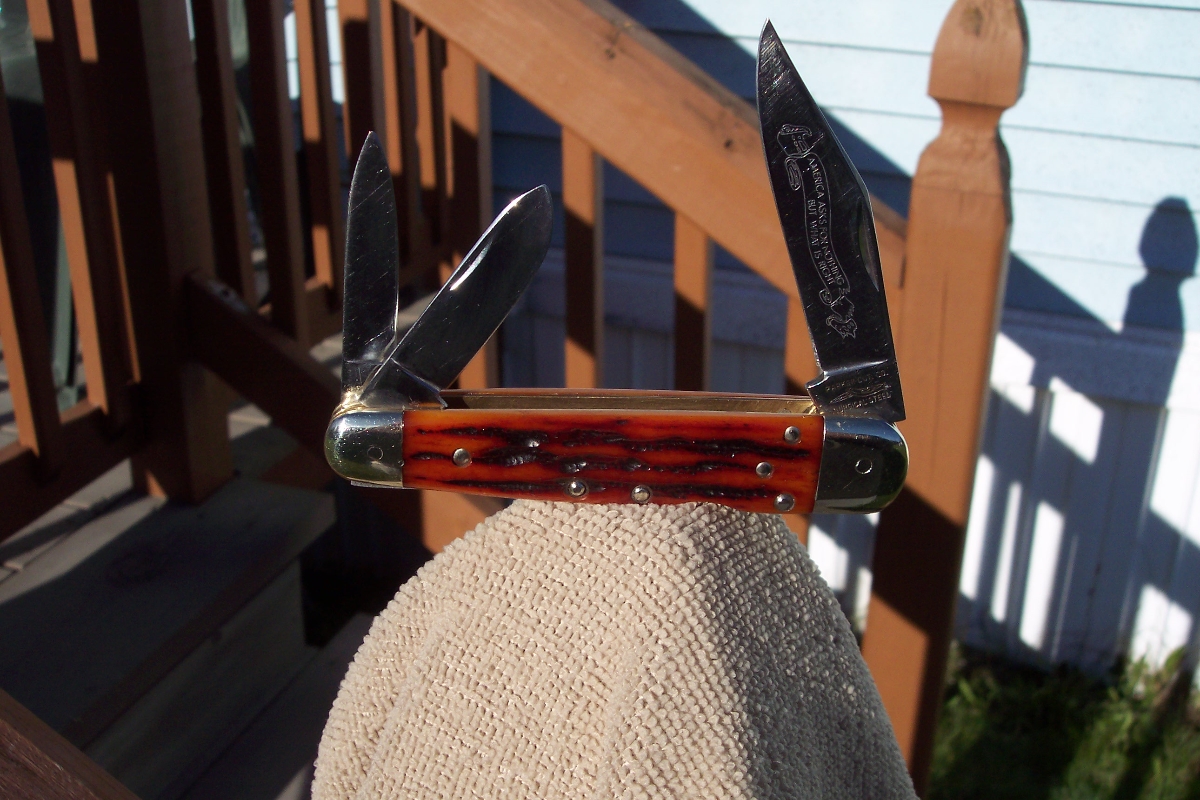

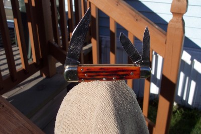

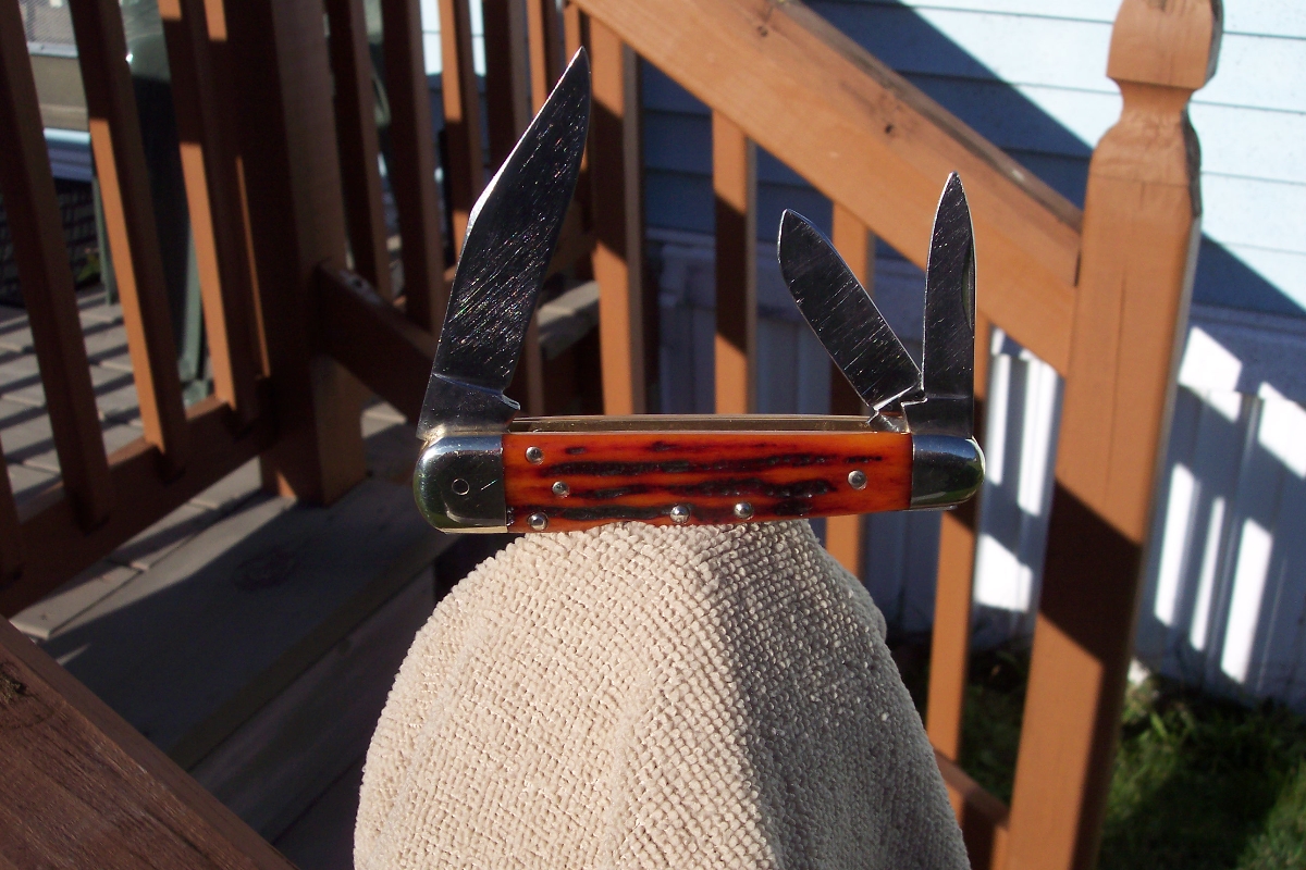

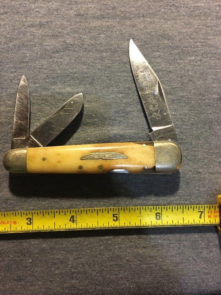

I Finely Put my Skill- N- Knowledge To the Test.. A Simple Designed Parker Cut Co Sleeveboard Lockback Whittler Slipjoint Pocket Knife ,, I like everthing about the Design of theses ,Needs a little Polishing up but after all it is Together And Functioning Perfectly .Thanks for Looking .

What a GREAT candidate for a rebuild, and a fantastic outcome.
LOL, You should have looked for a knife with just a few more handle pins for a first project tho!.
Great job sir. Very respectable...

Thanks Ken . You Are So Right , Lookin like a Studded Biker knife of sorts
I thought it Needed that Rugged look Something awfull

Looks great!

Hey man... I have to say that you did a Great job on peening those pins. Very nice work.
Good call!
Edit:

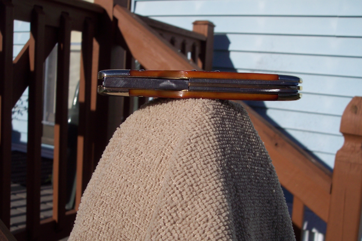

Thank You Rick , Ken The Pins were Schrade old stock 3/32 ns , With 1/8 Heads . I Simply Counter sunk the pins and assembled the Mark side , Then Sandwiched the To Halves together in a Vise , with some lubar( Jantz) on the Pins It Went together with out a hitch. Then Did my Best to Spin the Remaining Side , I was most concerned with the Durability since I intend to EDC this one..

Great job Joe! Very nicely done. What kind of bone is that it is very pretty?

Cullpepper Amber Stag .And The dye Process is Fantastic , ( no -Info ) I Buy the Thicker Pieces and saw them in Half , Any Way there Really Starting to get the Knarly look from what stock I Bought , Maybe input to Cullpepper from there Followers,
Really Nice Scales Tyvm ED

Amber" Bone" Stag

You certainly didn’t try to get by easy by picking a simple pattern! Whittlers are not the easiest pattern to begin with and then toss a lockback in the mix with all those pins! You could have picked an easier pattern, just saying…
Nicely done however in spite of all the pins! Culpepper’s Amber CSB is an excellent choice for larger knives and it always finishes up nicely.
That is a vast improvement over the original handle material!
Excellent work!
Excellent work!
