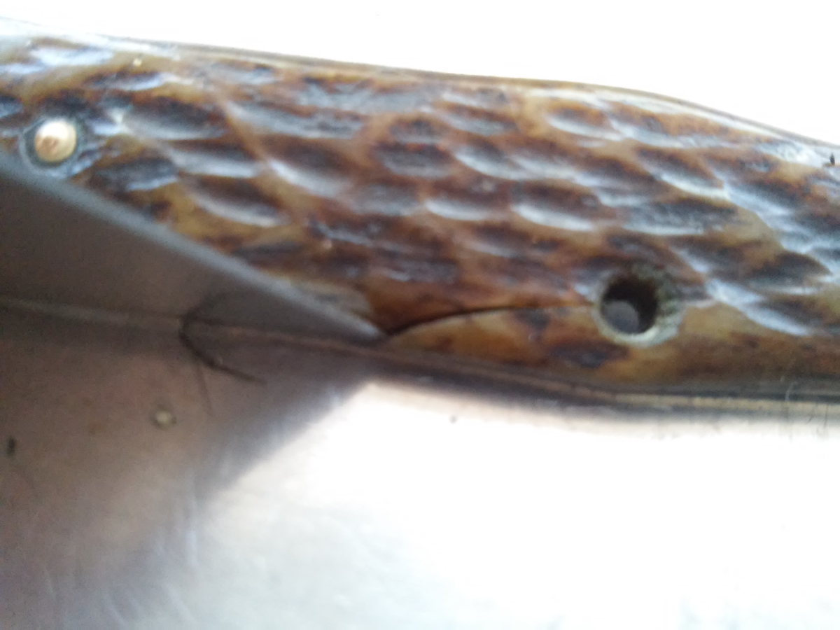

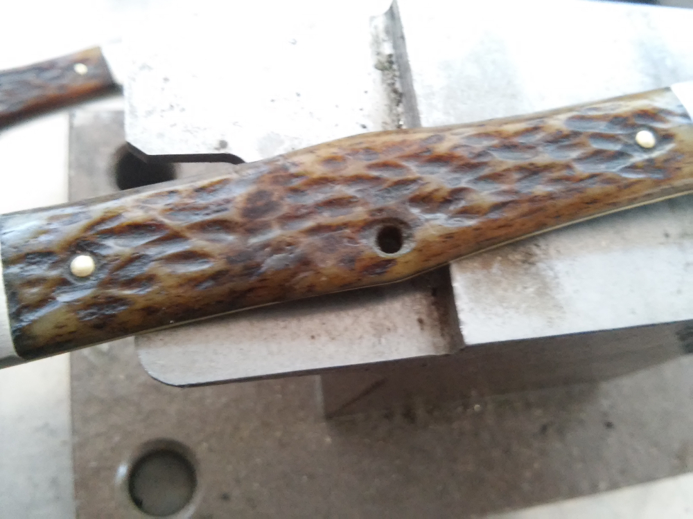

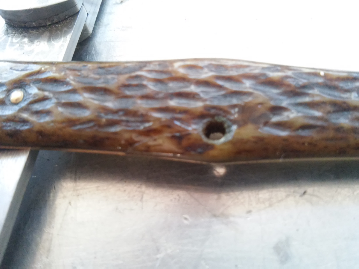

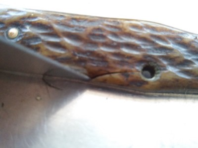

Greg has been generous in giving me 2 2nd gen Camillus 72 beaters so I can repair a first gen that I have. He sent me two because they had handle issues on opposite sides. That way I can two nice handles for my 1st gen. Thanks Greg! Any way I noticed that one had a pin crack at the rocker pin. since that was the only issue on the one knife I thought I would take a shot a repairing the crack.
I carefully spread the crack and used some zap a crack. Taped in place while it dried. After it set I used a 3M pad to smooth area and low and behold!Crack gone!
I love it when things go according to plan!

May be too late but as an extra measure to prevent re cracking flip to the back take a dremel tool with a thin cutter an cross the crack with a coulpe of lines use superglue an ivory dust finer the better an fil in both line accross the back side of the crack an re-sand flat ,it adds stabelization so when you re pin it its way less likely to re-crack out also once its back on the liner drill out the hole an make sure its liner on pin not offset to make it bone against pin , t

This handle never came off of the liner. To make the crack stable and disappear I used a technique that I learned from a luthier in Hangtown many years ago. I clean the crack with alcohol and dry. I spread some zap a crack on the crack. I stress the crack just a bit to open it up then blow the zap a crack into the crack with compressed air and then tape it down tight until it sets. Clean it up with a 3M pad and buff! That repair with the proper glue has saved many a cracked guitar neck! That got my attention and its the method that use on knives when ever feasible!
