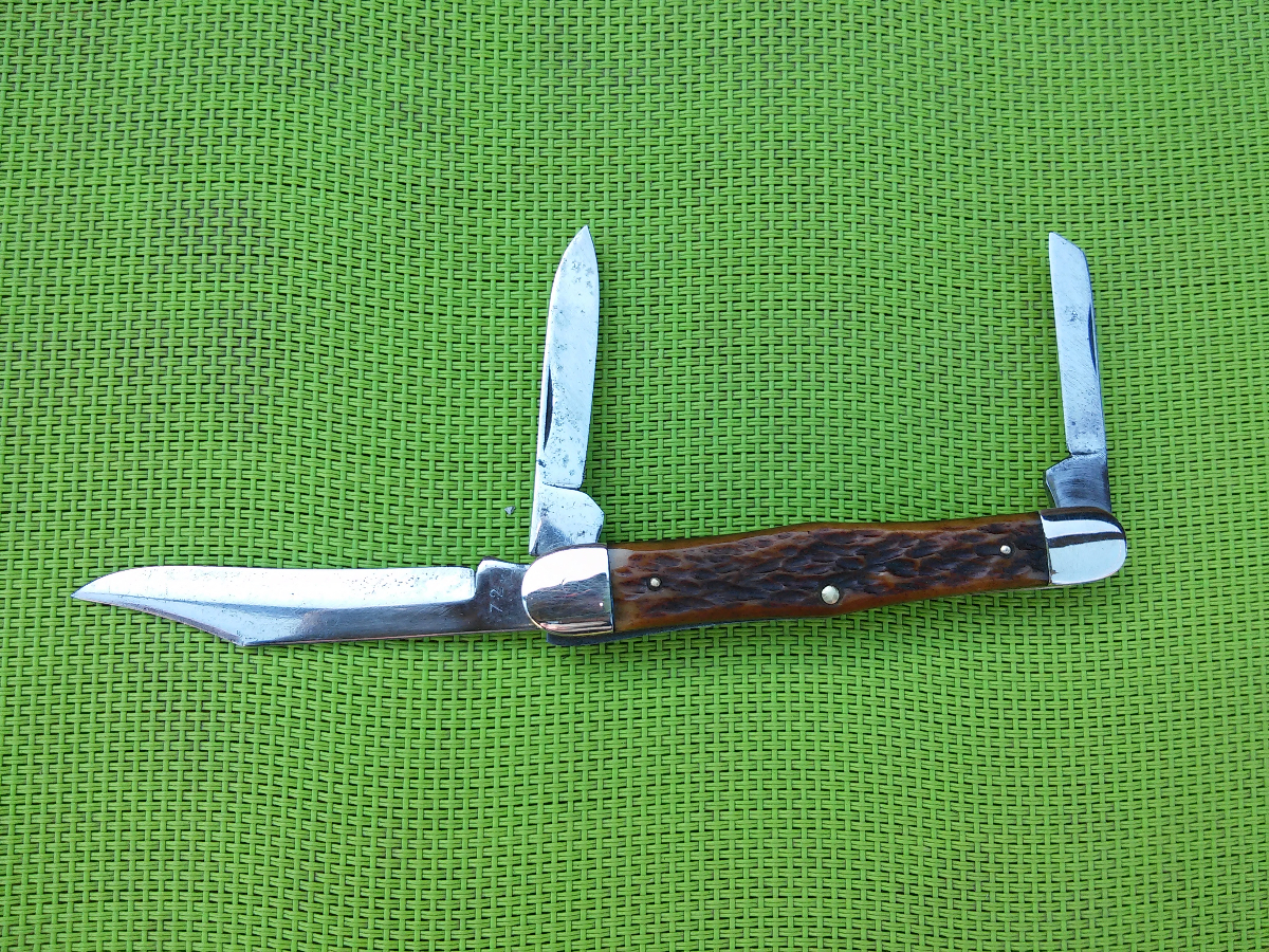

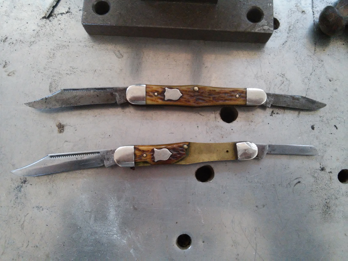

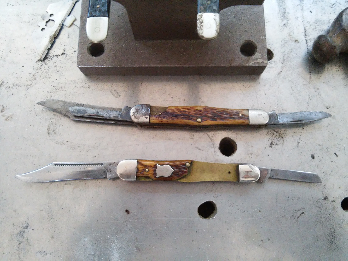

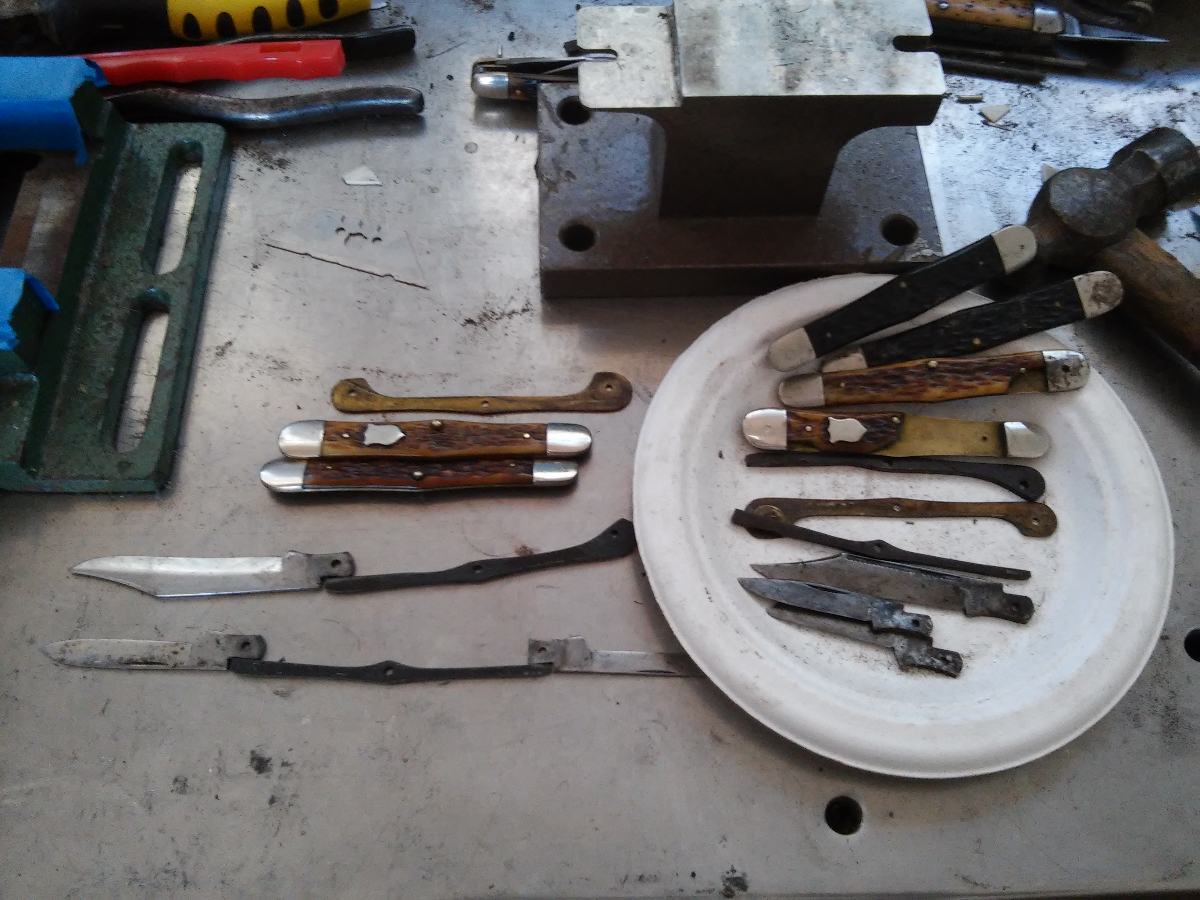

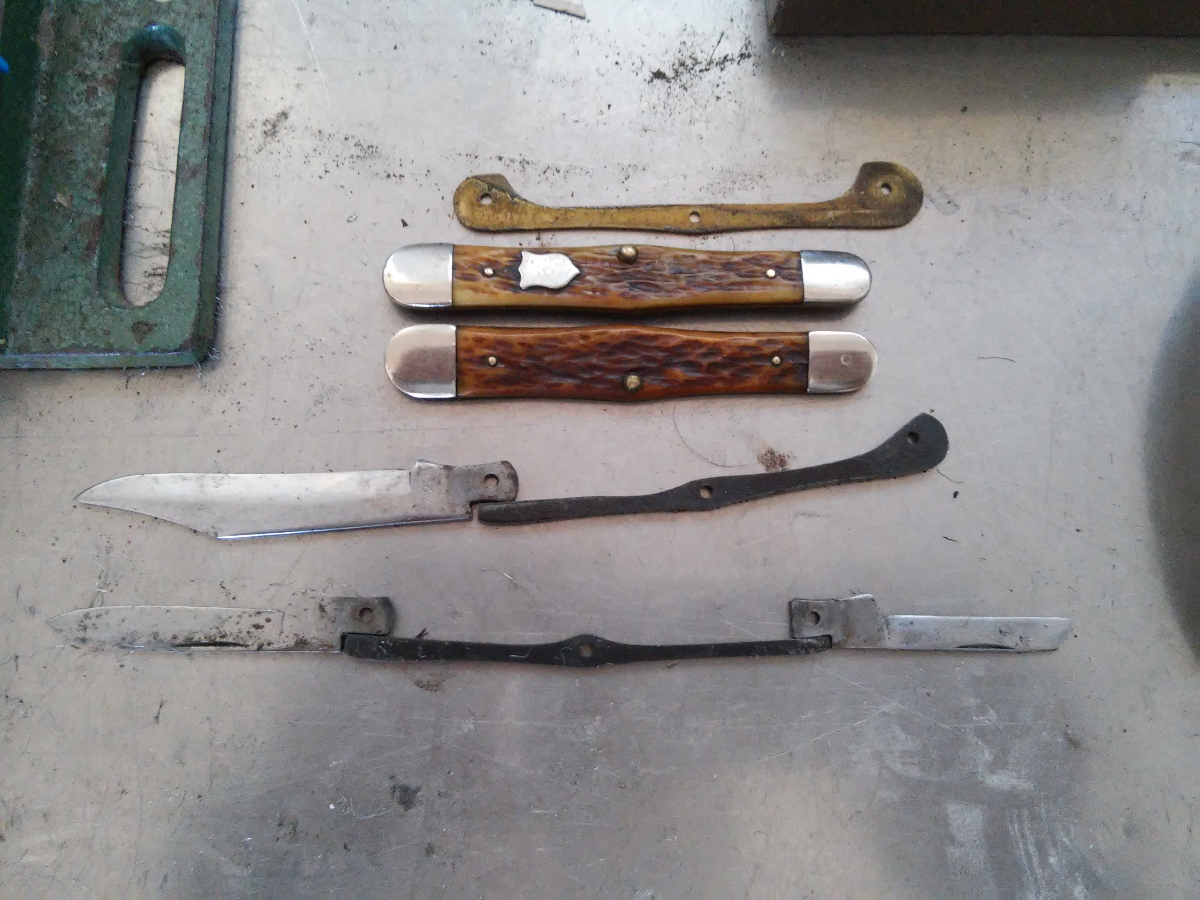

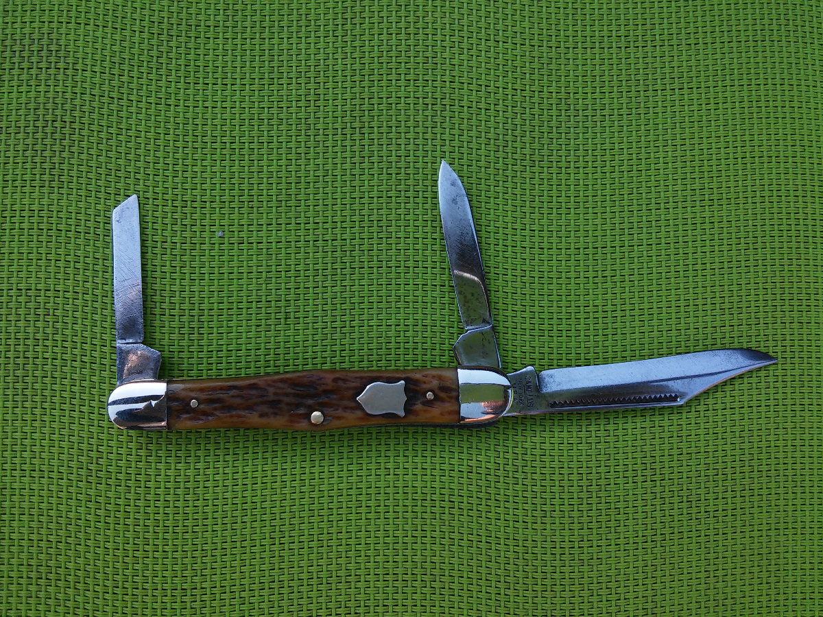

Greg had picked up a couple of short line 72's and both had damage to the bone handles. He wanted me to make one good first generation out of them. As you can see after I cut them apart and cleaned them up and put everything back together. Came out real nice too! Hope you like it Greg!

That turned out to be a fine looking knife Randy!! Nicely done.

Thanks Mike! I have fun with the 72's Its my favorite pattern to work on. Makes happy when I have one on the bench.

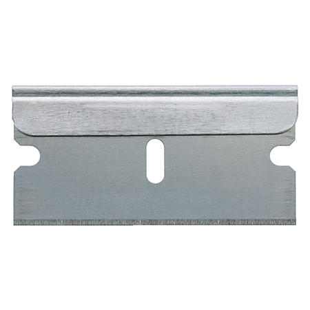

........will a single edge razor blade work for cutting the pins???..........#goldpan wrote:I use a utility knife blade and a hammer. Wedge the edge of the razor blade in the space between the pin and the liner. For the butt pins, pivot and rocker pins. A few whacks with a hammer. The pin is sliced clean through!americanedgetech wrote:Randy,
When you say "Cut them apart" are you using a shear blade to actually cut the back spring pivot pin?
I am using a 1/16" hardened blade to shear the pin but I worry EVERY time that I am going to break a good handle. I still find it easier than drilling, and removing the leftovers but my nerves are paying the price.
- jerryd6818
- Posts: 39458
Re: First Gen Camillus 72
Tommy, if you're talking about these, the answer is no. They are too thin and too brittle.carrmillus wrote:........will a single edge razor blade work for cutting the pins???..........#goldpan wrote:I use a utility knife blade and a hammer. Wedge the edge of the razor blade in the space between the pin and the liner. For the butt pins, pivot and rocker pins. A few whacks with a hammer. The pin is sliced clean through!americanedgetech wrote:Randy,
I am using a 1/16" hardened blade to shear the pin but I worry EVERY time that I am going to break a good handle. I still find it easier than drilling, and removing the leftovers but my nerves are paying the price.................
If however you are talking about these blades used in razor knives then the answer is yes. As I understand Randy, Dale and Glenn, these are what they prefer.

Jerry is correct!
I tried those single edge razors at first. One whack and their done and the pin isn't cut.....

BRASS pins only.jerryd6818 wrote:Tommy, if you're talking about these, the answer is no. They are too thin and too brittle.carrmillus wrote:........will a single edge razor blade work for cutting the pins???..........#goldpan wrote: I use a utility knife blade and a hammer. Wedge the edge of the razor blade in the space between the pin and the liner. For the butt pins, pivot and rocker pins. A few whacks with a hammer. The pin is sliced clean through!................
Steel pins need to be drilled or have the peen ground off (as a generality)
