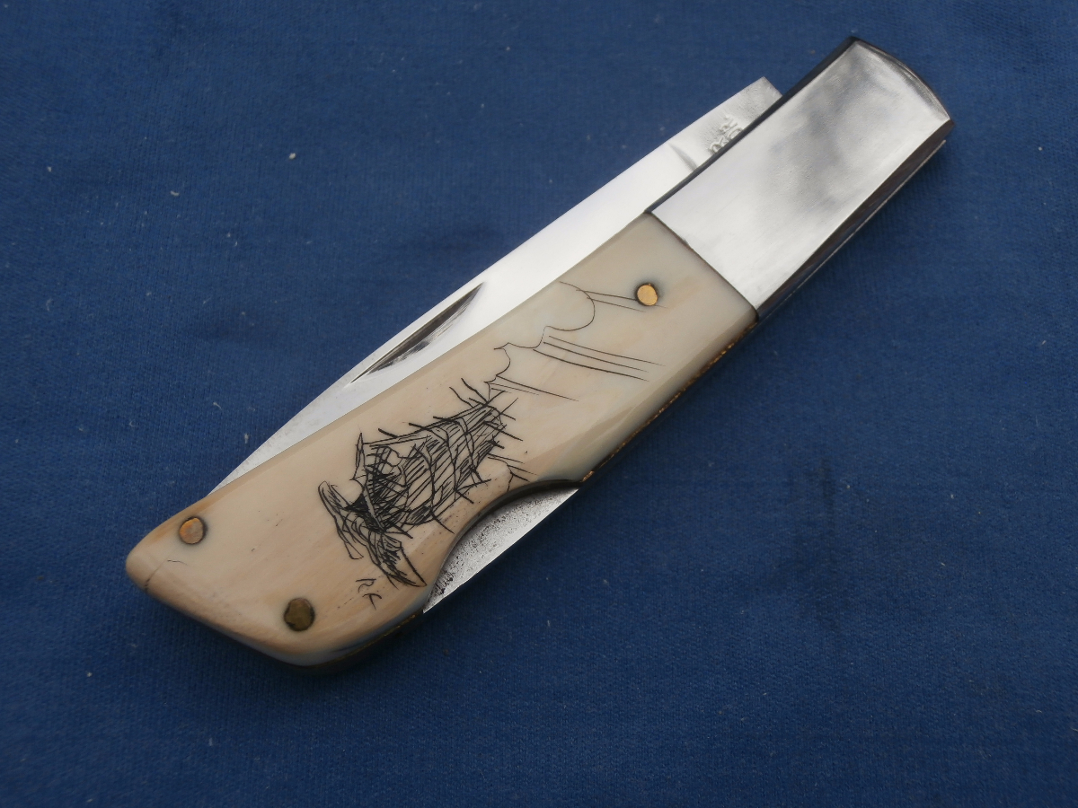

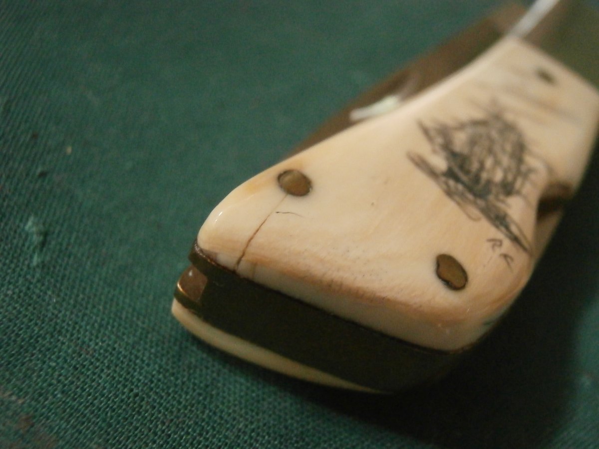

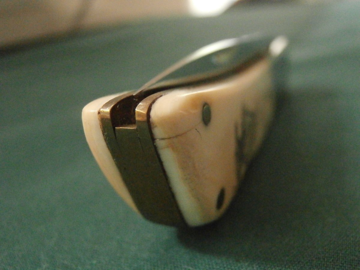

I just got this ivory handled Gerber Silver Knight and I don't know how long it's had the pin/scale crack, if it's old or recent. Could anyone give me some advice on what I could do to stabilize it? I was thinking maybe a tiny drop of Superglue, but I sure don't want to do anything that might somehow make it worse (unforeseen/unintended/undesired consequences due to uninformed actions). The knife is a "safe queen," so, it's never going to be carried or used...but, I would like to be able to handle it from time to time without worrying about the corner of the scale breaking off. Appreciate any expert opinions.

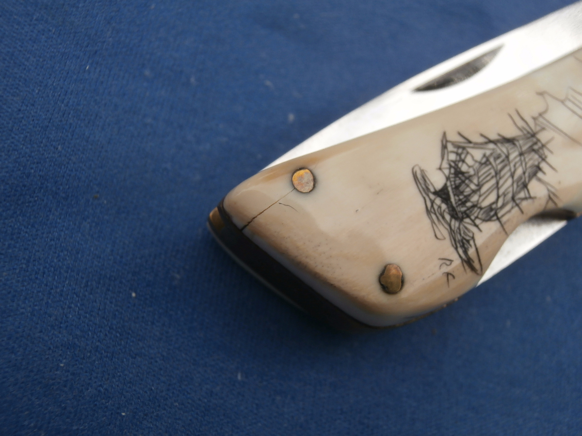

What was never posted was a private conversation I had with QTCut5. I had him send me the knife and I stabilized the crack using my method as I described it.
I didn't fill the crack, it wasn't that wide and often the zap glue will take on the color of the ivory and a fill isn't really necessary if the gap is not too wide.
I don't remember if the crack was highly visible or not when I was done.
Q - if you read this, perhaps you could post a picture of the knife as it is now. It's been a year or two since I repaired it, and I would love to see how well the repair has held up and what the knife looks like today. I would like to make sure the method I'm using holds up with time. Thank you my friend.

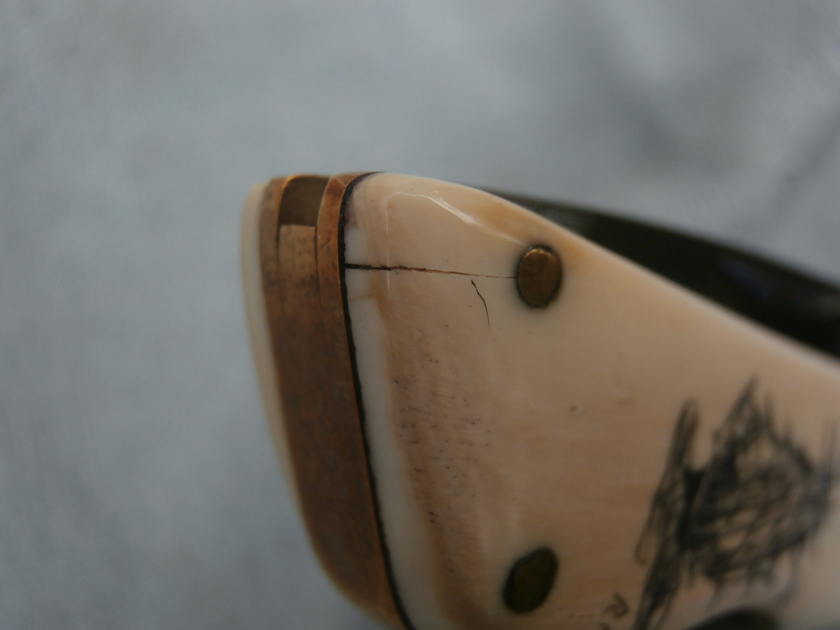

Sure thing, Dale...your wish is my command.
When I read the new post on this two-year-old thread, I realized I had been remiss in posting a photo of the stabilized crack for all to see. For that negligence, I sincerely apologize.
So, to update the record...Here is the same knife two years after the fix by Dale. Although the crack is still visible, it's perfectly smooth and when I run my fingernail over it it's impossible to detect. Dale did an outstanding job. Thanks again, my friend.

Thanks Q!
I was more curious than anything else about how the repair had held up. I don't often have a chance to follow up on work that goes to a tropical climate or an Arctic climate and I have sent knives to both places. Sometimes products and methods that work well in a temperate climate do not work well in extremes of hot or cold, or in arid climates either.
I was curious as to how the zap glue held up in that crack. I suspect that Gerber stabilize that piece of ivory before they used it and yet it still developed a crack. I'm glad to see it hasn't grown and that the zap has stayed in place as it is supposed to.
Thank you my friend for the pictures!
