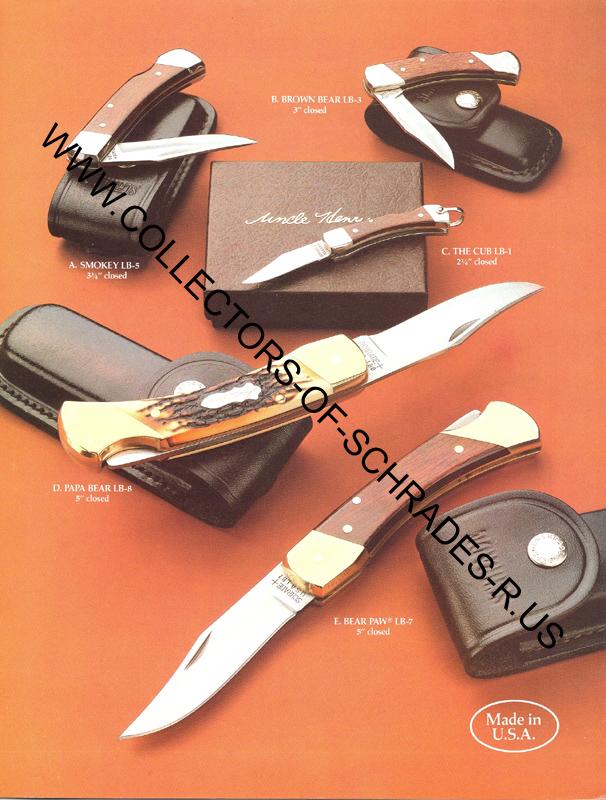

Do you have a picture? It is always helpful to see a picture when working with something out of the ordinary.
I haven't had any sheaths, from U.S.A. made Schrade folding knives, like you've described...and would be interested in a picture. Some of the newer sheaths from Taylor are made with a reconstituted leather.
Is this what your knife looks like? (Picture borrowed from Larry's site)
Did you acquire it new?

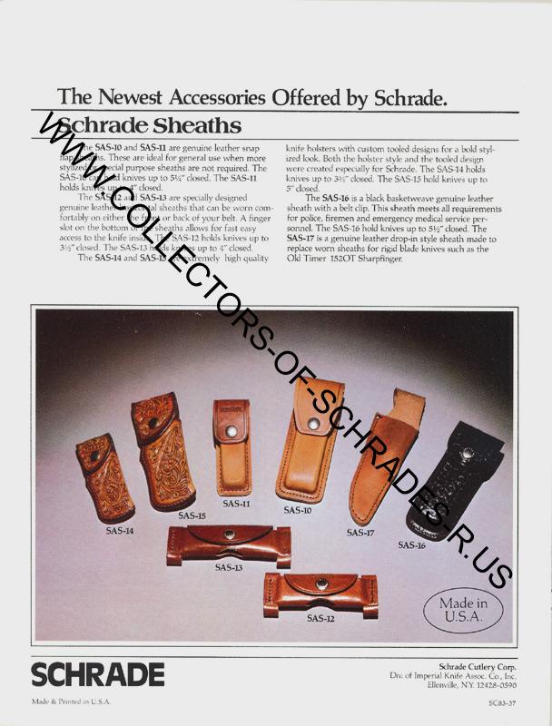

Here are a couple more pictures showing the lockbacks.....and the standard sheaths. Your sheath with Uncle Henry sounds interesting.
