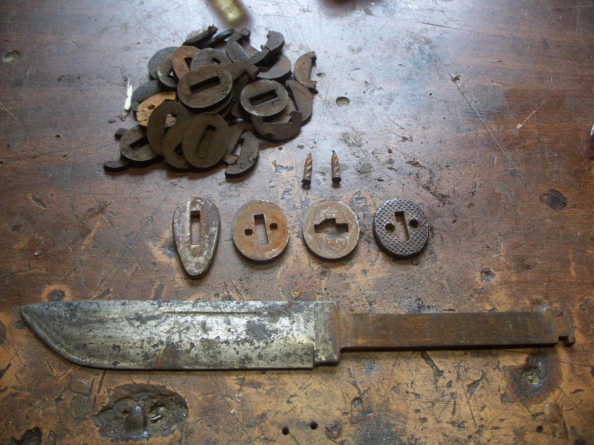

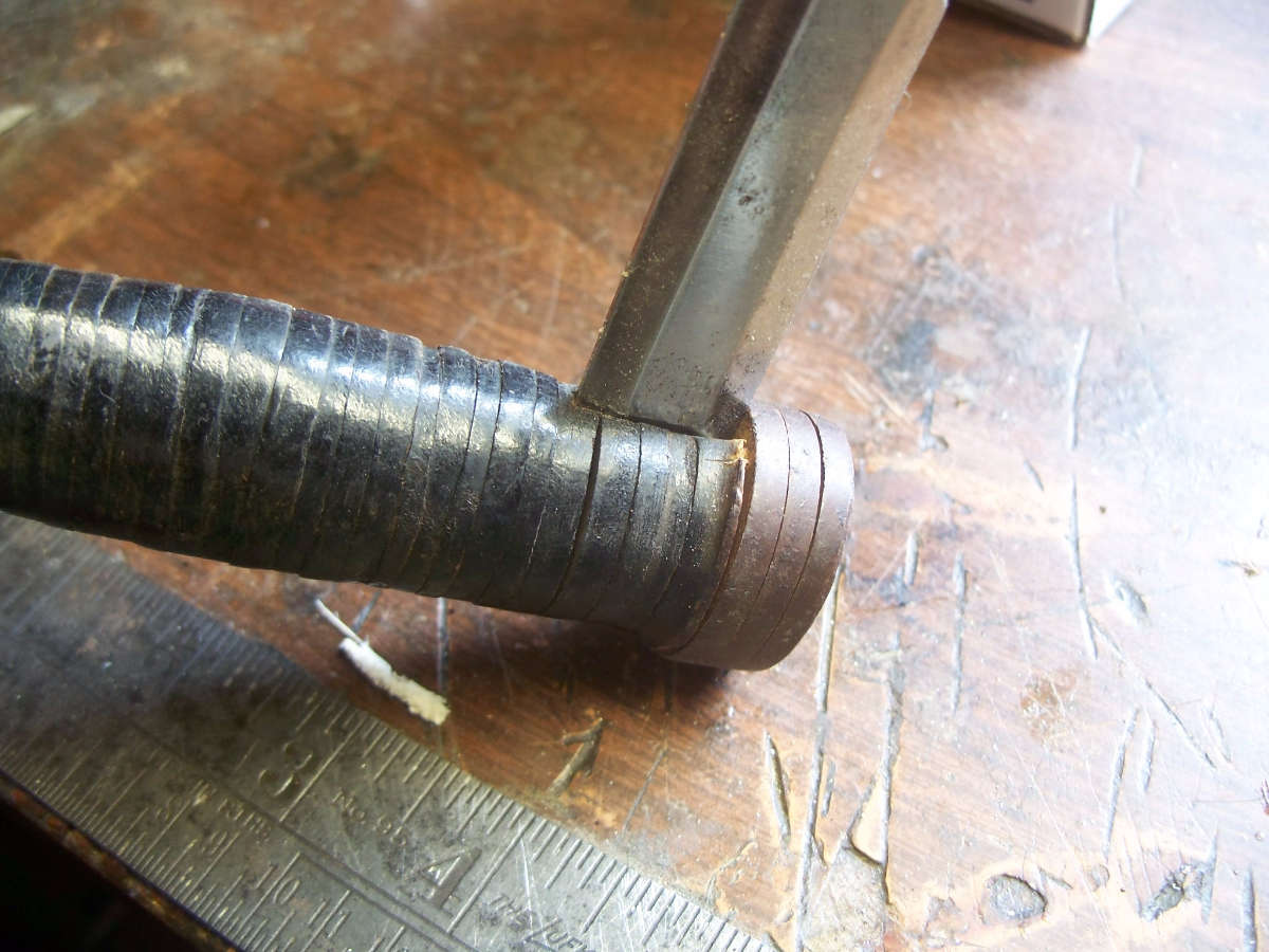

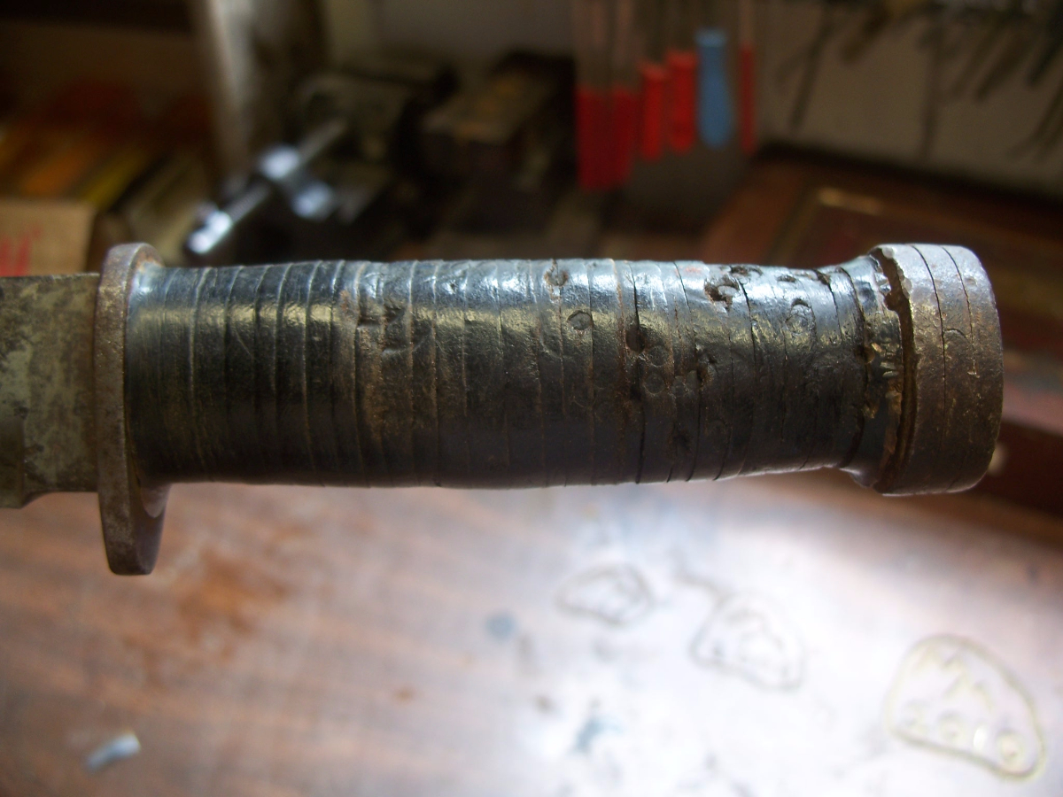

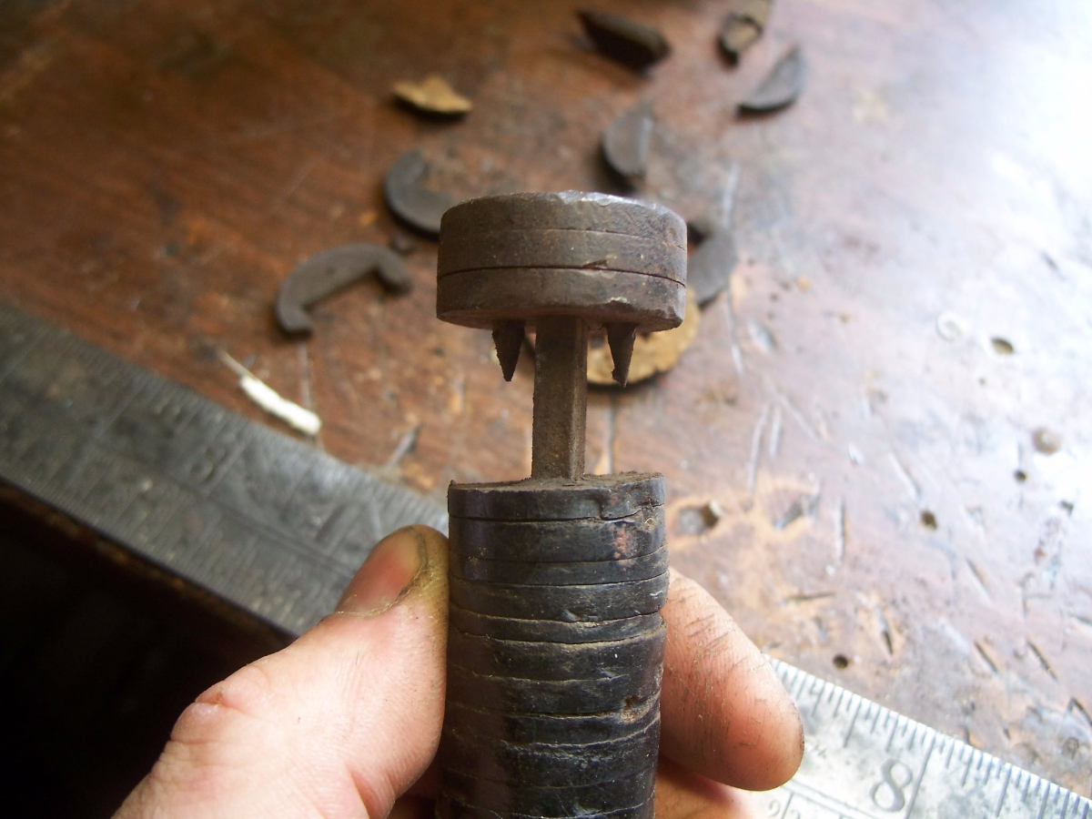

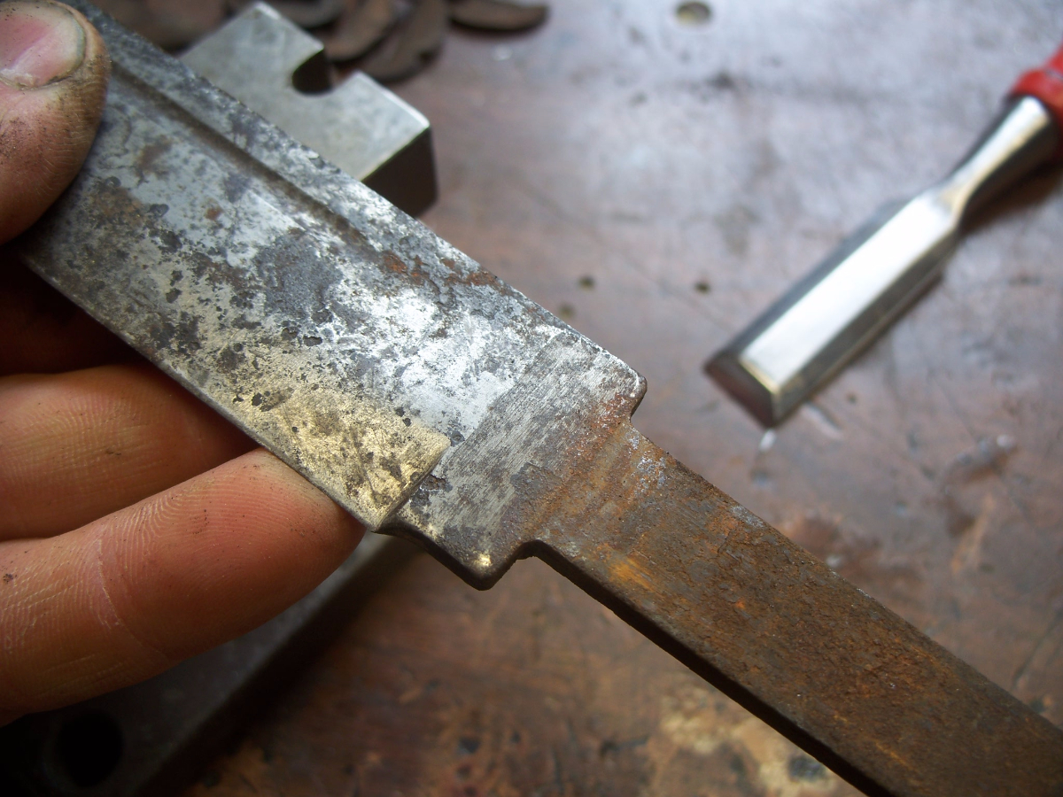

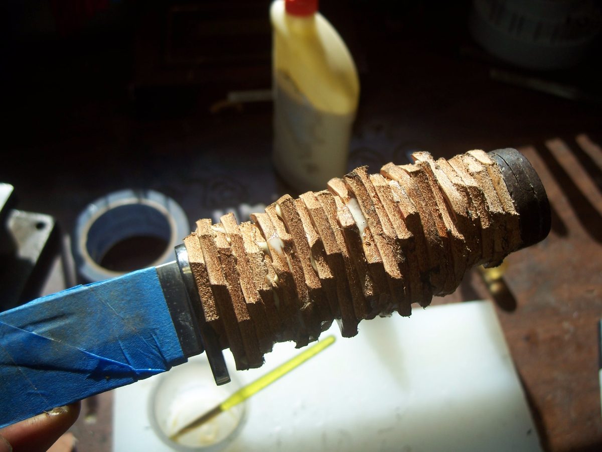

Thought I would post a little on this since there is some 225 discussion going on lately. This is an heirloom knife, handle was battered and shrunken beyond repair, all the washers were dry rotted and loose. Somone very neatly shaved off all identifying marks on this 225Q for whatever reason. This was carried by the onwers grandfather during WWII and he requested a complete restore for display purposes.

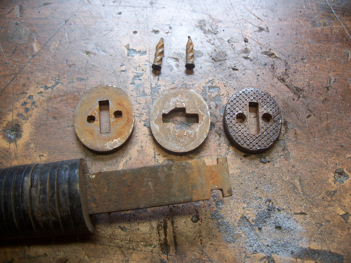

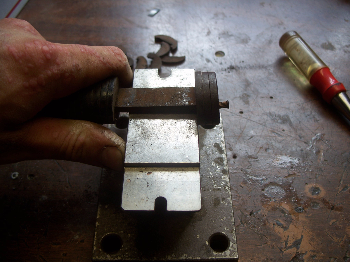

If you need to get the pommel assembly off without destroying the nails, but a few (or a couple depending on how much of the handle you may want to save, and tap them out from the underside. May need to resharpen the tips before reassembly but this way you don't booger the heads up and can use the original twist nails.
Here's a bunch of pictures hopefully they speak for themselves. Whenever I redo one of these I pre-compress the washers dry, then reassemble with cement between every washer and compress again while installing the pommel. This way the handle should never come loose again.

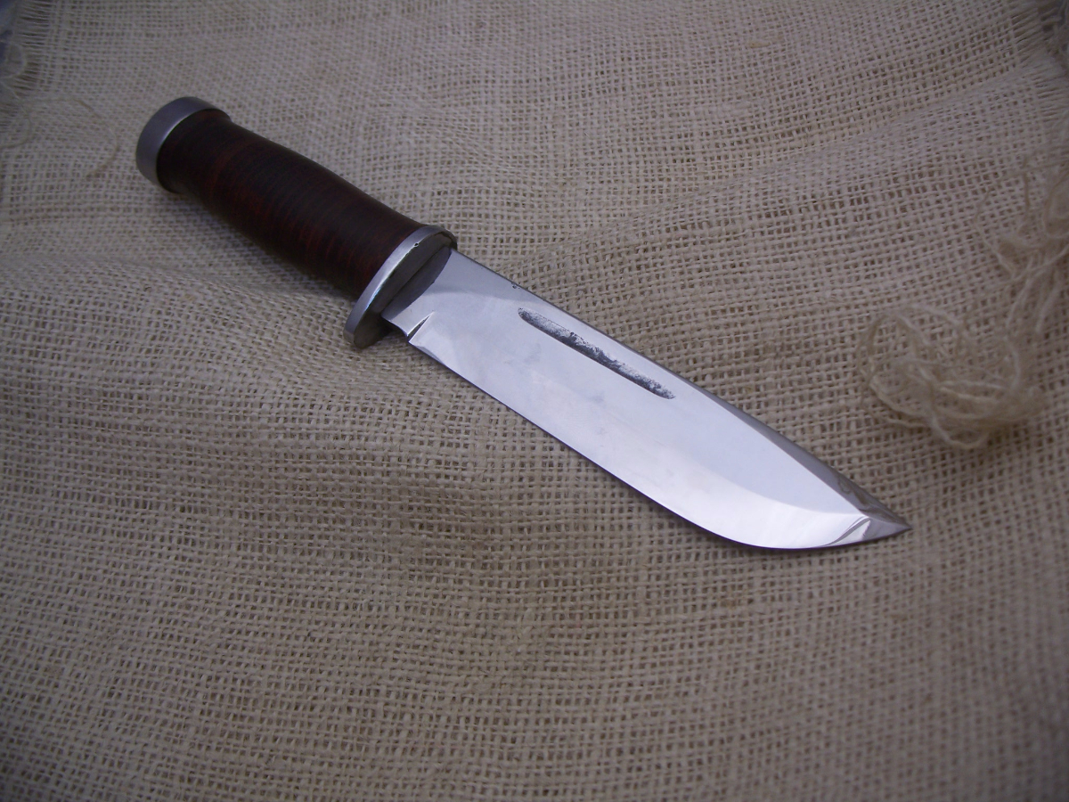

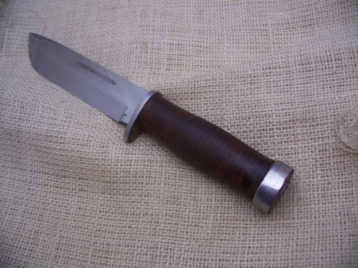

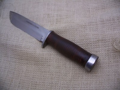

Here is the finished product

Wow Kaleb, that;s a fantastic job!!

WOW!
I hope mine comes out half as good as yours.
How well did the nails hold after reusing them? I'm a little nervous about removing them without damaging them.

rexstubbins wrote:WOW!![]()
held just fine, just need to resharpen the points. make sure you compress the washers a lot, otherwise you'll end up with gaps, some cement on all the parts as you do final assembly helps too.
