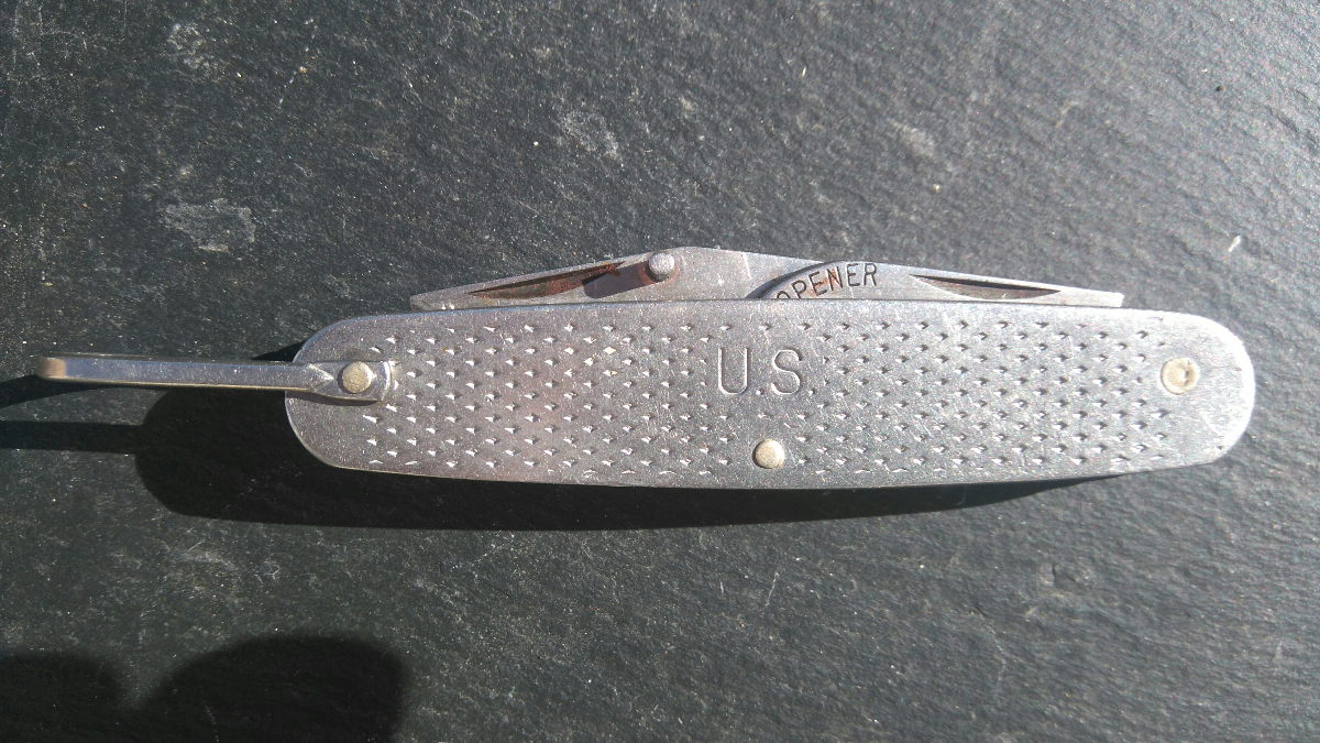

Hi,
I'm new to this forum and have just started to collect pocket knives, mainly military issue.
I recently had the good fortune to be given a Camillus military folding blade pocket knife.
It's in great shape for it's age, 1972, but the pin at the blade end has broken inside, leading to the blade being loose when opened out.
From my understanding, and after a little research, it would seem this is a fairly straightforward fix.
Only trouble is, I never had to fix a knife before and don't want to ruin this one!!
Can anyone offer any advice on the best way to do this?
Regards
Luke

Luke, have you got a picture of the problem spot? Seems a bit unusual for the bolster pin to be broken (at least that's the one I think you're talking about).

You might be able to get away with just replacing the bolster pin, but I'm guessing you'll have to split it in half at the liners and replace all three pins. I say that only because that bolster pin is going to be a pain to remove without taking the whole thing apart. With all of the Camillus TL-29's I've customized, it's always been that front bolster pin that has given me trouble.
Pictures would definitely help.

This is likely a stainless handled utility (camp style) knife with can opener, punch, screwdriver, etc. and no bolsters as others are assuming but I could be wrong. This is a straightforward repair either way but if you have reservations about tackling it yourself it is not an expensive repair to have made by a professional.

I have, hopefully, attached a photo of the knife for clarification. The broken pin is the blade end, which is the pin on the far right looking at the photo. Hope this helps!
It would be helpful to have some names of 'mechanics' as I don't want to ruin this knife. It has become quite well traveled: I live in the UK, the knife was made in the USA and I was given it by a guy in Australia!
Any help in getting this knife back to a useful state would be greatly appreciated!

Forget everything I said, I was thinking about a different pattern. Take Muskrat Mans advice, he had it right !
