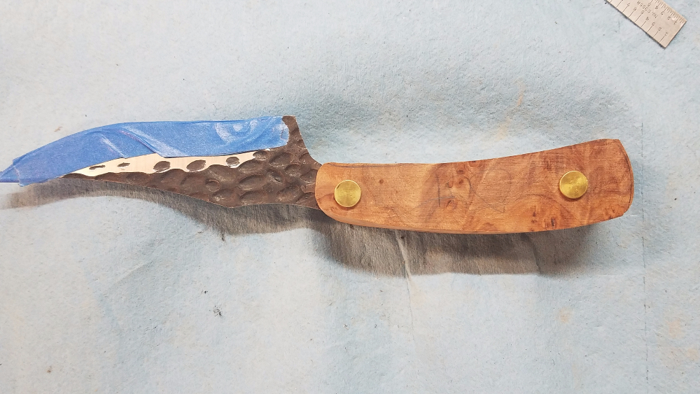

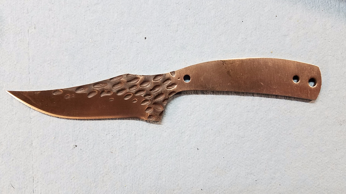

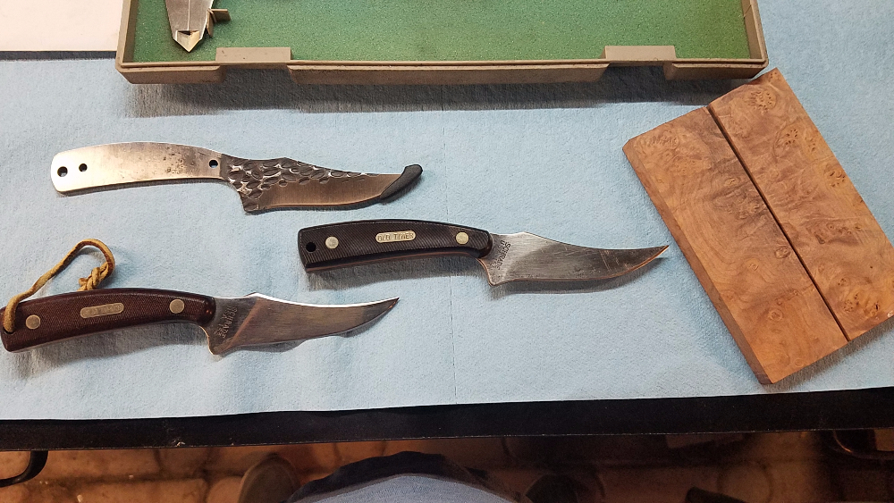

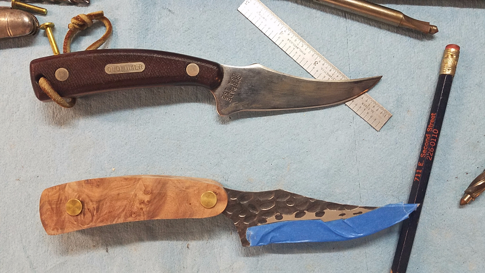

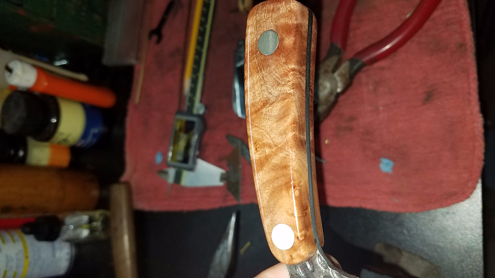

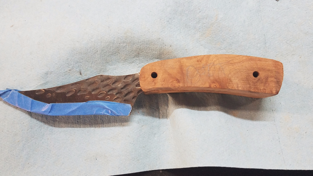

I picked up a hammer finished Woodsman Skinner (Sharpfinger design) from company located in North Carolina. I love the Sharpfinger design, and am glad to see it out as a blank. I'm using it to build a knife for my step son out in California. I chose a stabilized maple burl for the handle material. I've got it shaped as far as I can go without mounting it to the blade, and am waiting on the counterbore I ordered for the cutler rivets I'm using.
Here's a few pics of what I've got and where it sits at the moment.

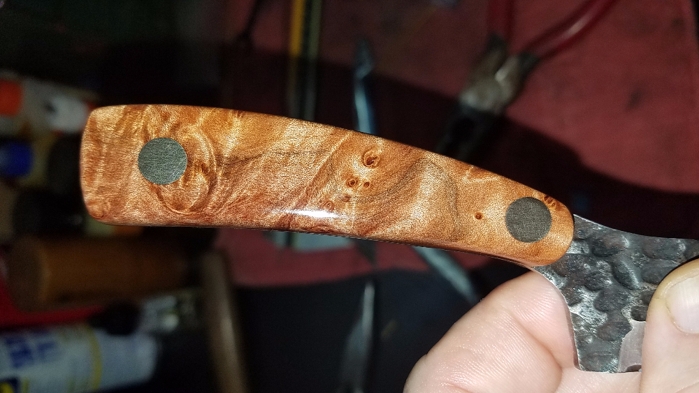

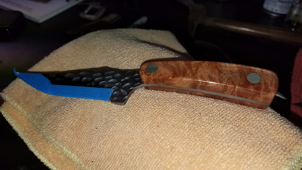

It's coming along nicely, I think. I'm now up to 6 coats of Formby's High Gloss Tung Oil on the handle, after sanding all the way up to 2500 grit automotive sanding sponge. I have no idea how many coats of this stuff I should put on, but I plan to keep going until the leather sheath I ordered comes in sometime late next week. When it arrives, I'll wet fit the sheath for a custom fit, then freshen up the cut edge a bit.
Here's what it looked like part way in the sanding process, prior to the first coat of tung oil...
Jon

I forgot to add that I had to relieve some of the lumps from the hammer marks that are under the front of the scales. The left side scale wouldn't sit flat, even though it was flat sanded on a granite surface plate. I set the scale on the blade, traced the front onto the steel with a pencil, and filed it down some with rifler files. I was very happy to see that I bought the right counterbore, and that it cleared for the heads with a slight amount of rub, allowing for a seamless transition after final sanding. It took me a few days to find a vendor for the cutter, and I was close to grinding down a pilot for one of my spot faces I had from my jig boring days, but I didn't have to go that far. I found one online that was made from a split piece of HSS. Had I had access to a surface grinder and spin jig, I would have had one made out of an old endmill in short time.
I do miss that kind of work so much. That's probably why I like working on guns and knives. The feel of steel, oil, and dirt on my fingers feels good.

8 coats and it's finally getting depth to the shine. I've learned the secret, I think...sand each dried coat with the finest abrasive I have and re-apply. Just when I think I'm done, keep going. I'll probably keep doing this right up to my surgery, to ensure that I get the best and deepest shine to the maple burl. It's amazing how, with each progression sanding grit, the details of the wood really come through...almost like bringing a photo into focus.
I have just enough left of this material to do a pair of scales on an Imperial shell knife I have. Other than the plastic peeling away, the knife is in great shape.

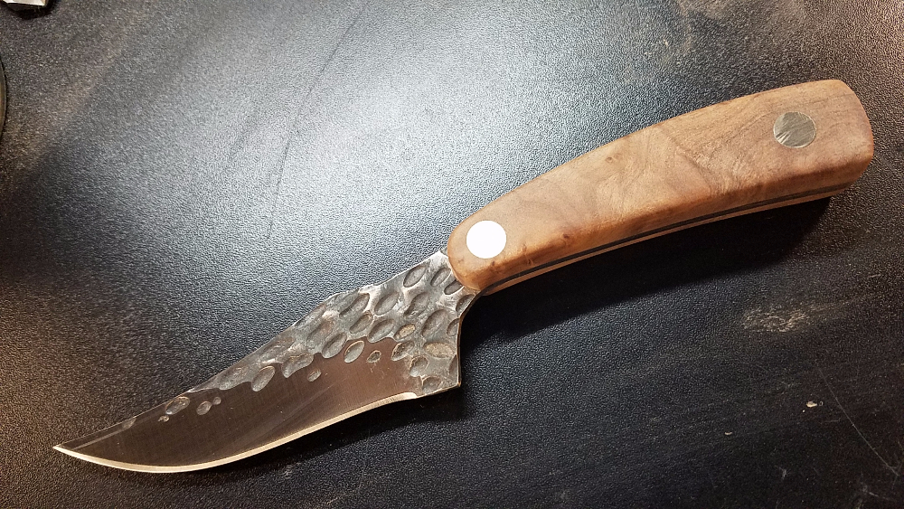

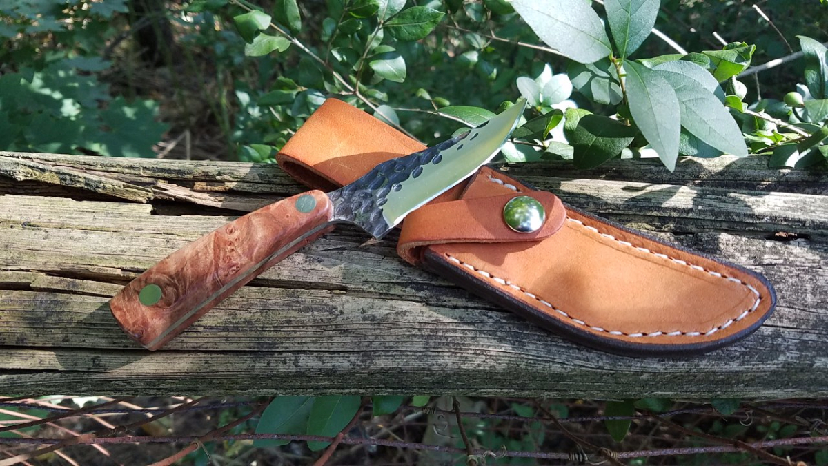

Here it is, paired with it's sheath. It took me some time to get back to normal after my shoulder surgery in May. I've picked up a few more blanks and stabilized burl scales to make more knives. This one was sent to my step-son, who should get it tomorrow. I collected a few orders while on the mend after showing this one off a bit. Now I wait for this blank to be back in stock, since one of the orders was for this specific knife.
Perhaps after some more healing, I'll start making them from scratch.
