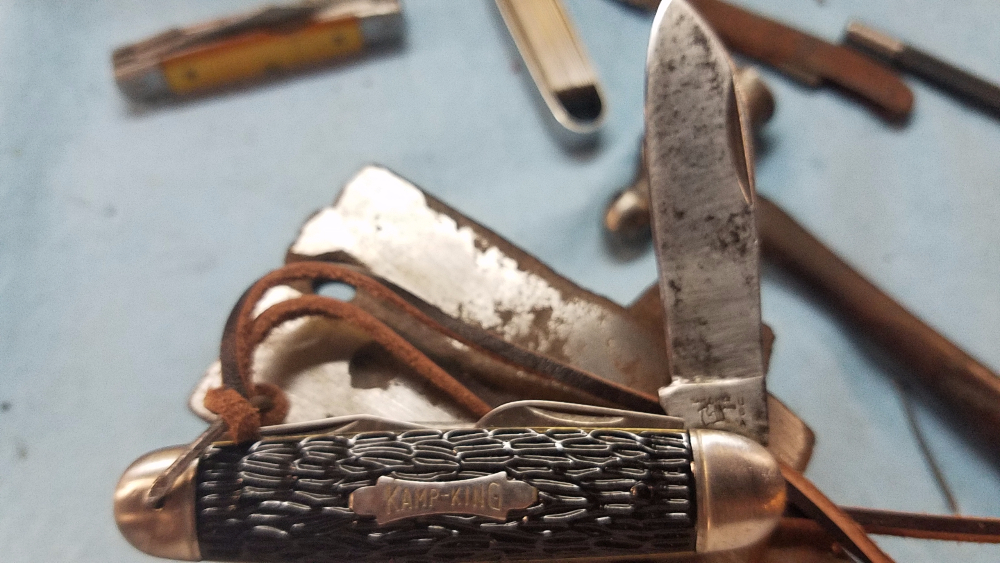

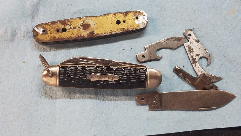

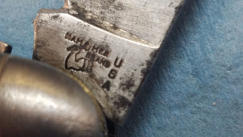

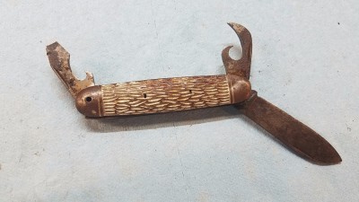

I'm in the process of restoring a Hammer Brand Kamp King (1945-1955 tang stamp), using the awl from another of the same vintage. Both came to me in very, very rough shape. One had both springs broken, and the other with a broken awl. Both were covered in rust. One was missing the pile side shell. I removed shells from both (one was hollow and the other was plastic backed. The black (celluloid?) was trashed on both, and easily flaked off the hollow shell knife.

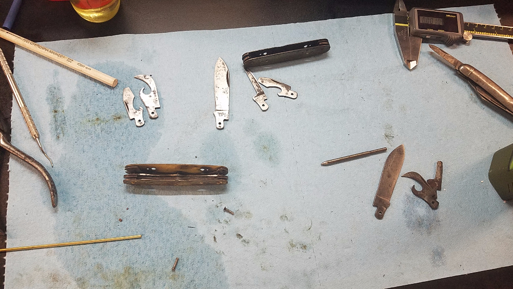

I disassembled both knives. Using a red 3M wheel on a drill press, I was able to remove the rust. There was very little pitting, which surprised me. I checked dimensions on both awls, and they were the same. Out of curiosity, I measured the thickness of all pieces, and found that one of the main blades was 0.020" thicker than the other. Now, both frames being equal, and all parts measuring the same, why would one blade be that much thicker than the other?
I forgot to add that one bottle opener/screwdriver was about 1/8" longer than the other, but had no signs of it ever being ground down, so I'm assuming there was an engineering change from one knife to the next, even though both have the same tang stamp. I'll measure and compare both frames tomorrow. The frame I'm using did have a thin piece between the brass liner and spring. I'm wondering if that piece measures 0.020" to make up for the difference from the main blade to the one end opposite...
BTW...I plan on painting the handle black like it used to be, and replacing the shield from one wit the shield from the other. The knife will not look brand new when done, just very tastefully restored. I'm sure it will affect the current value, but in 20-30 years, I don't think it will matter much. I'm not altering the knife, but it will new rivets holding it all together...not that anyone would ever see the rivets on, due to the shell handles.
I didn't get before photos, but do have a few during photos. I'll post those after I'm done with this restoration.

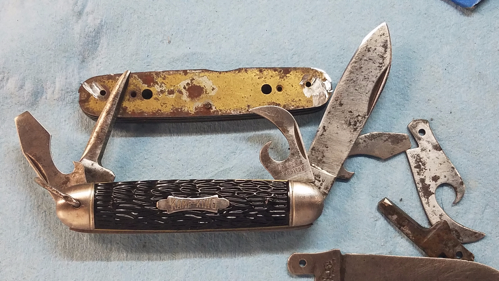

Yeah, I figured it out as I was typing the comment yesterday. Sometimes you've just got to talk it out to figure it out, right? LOL Anyway, I got the springs in this morning and sharpened the blade to "shave a gnat's rump bare" as my grandpa used to say...well, his language was a little more colorful that I think we're allowed on this side, but you get the point. LOL
I masked off the scales, shot a layer of primer and two layers of gloss black. I also cleaned up the two Kamp King shield I have with Semichrome and a t-shirt rag. I noticed that one of them was stamped off-registration and one was perfect. I haven't decided which one to use yet, though. I'll be able to assemble everything tomorrow morning.
I spent the rest of my time in my shop starting a new project that I'll eventually post in the Custom section...something I'm making for my step-son. I"m hoping to get it and a few more knives done before my surgery next month...complete shoulder replacement. That's going to take me out of the shop for at least 3 months, if not longer.

Well, once I figured out the trick to get the springs in, it wasn't that difficult of a job at all. It's not perfect, but the knife wasn't perfect when it left the factory. It is, however, sharp as heck, and more than good enough to be used again. Like I said earlier, the awl was broken, and there was another knife with a good awl, but broken springs. Both were pretty rusty, but cleaned up decently enough. I didn't want to completely clean and polish the blades, partly because of the age and partly because I'm not too keen on seeing old knives polished up and looking like new...this one shows that it has been well used, and it can now be used once again.
I learned a bit about the construction of these shell knives, and that while they may have only been built to last a couple of years, they can be brought back from the dead with a bit of patience and time. Getting the shell scales back in place wasn't too difficult, since I only pried one side off, and slid it down to remove it. I used a screwdriver to push the tabs back in place during assembly. I wish that I could have redone the plastic overlay on the handle, but I'm not equipped with what it would take, so I masked it, primed and then painted with gloss black Rustoleum. I think it came out pretty nice. I'm beginning to amass a collection of old knives that need some attention...some of them I can compete, and others are parts knives only.

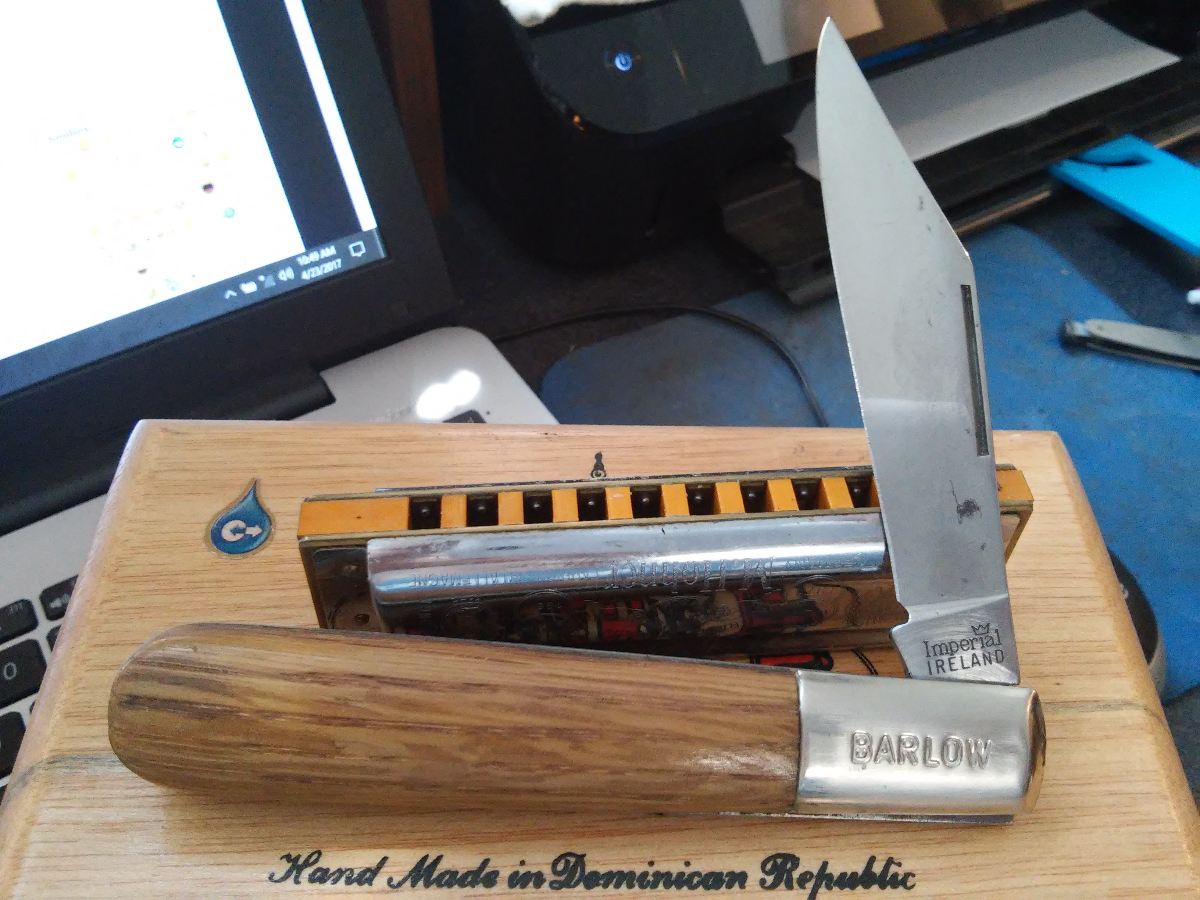

I have some shell handled knives that I plan on upgrading the handles on. I did one a couple years back. Its different from your as it had the brown plastic cover on the shell.
I popped the shells off and replaced the plastic with Oak. Came out nice. Yours rocks because it looks original! Keep up the good work!
