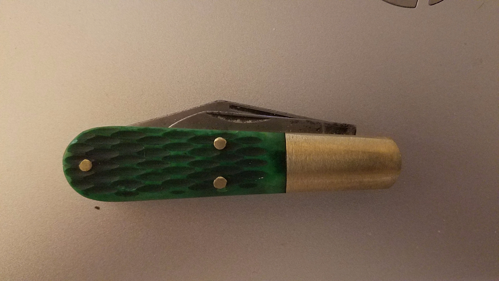

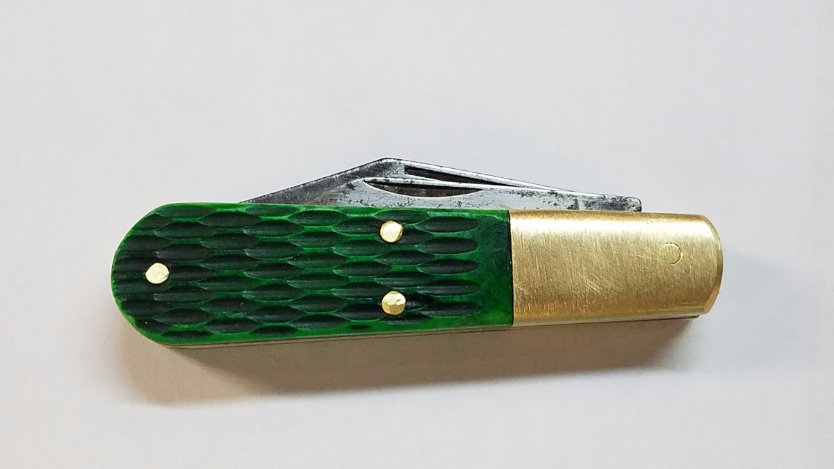

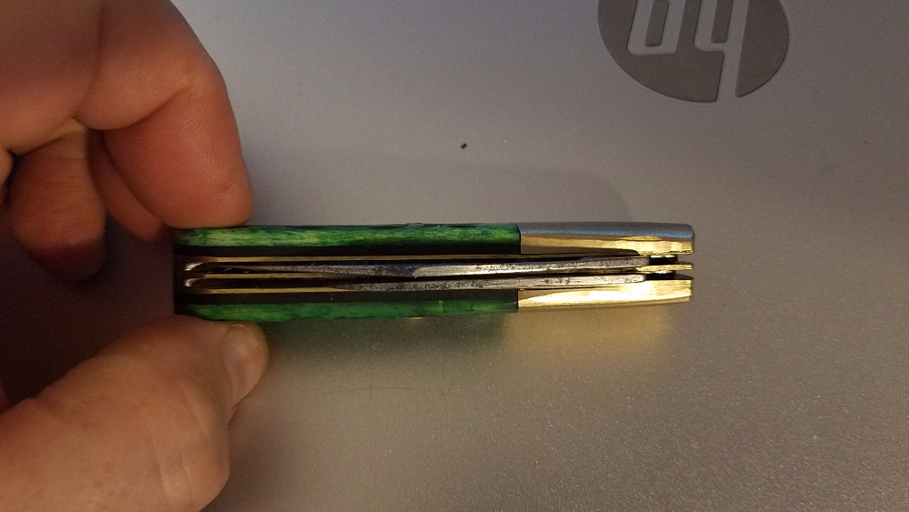

I was handed your typical later run Colonial Barlow with each scale missing a tab. After taking it apart, I decided to rebuild the entire knife...in for a penny, in for a pound, sound about right?
Now, I've made simple repairs to fixed blade knives in the past, but this was my first time for what I was about to embark on. I hammered the outer liners flat, but after a trip to the hardware store for some 3/32" brass pin, decided to scrap all scales completely...I came home with some brass. I made one new scale, clamped it to two other pieces of brass, drilled the holes and temporarily pinned them together so I could profile them as one. I added one additional hole opposite of the center pin, then took them apart. I was going to silver solder solid brass bolsters to the outer liners, but was out of map gas, so I figured two blind rivets would work. After attached, I flat filed the rivets. I had some green jigged bone scales and black micarta spacer that I bought, glued everything up and waited for it to cure. After curing, I carefully drilled the rivet holes through the scales and bolster. I then sanded the bone down close to the liner profiles on both pieces.
All I did to the blades was straighten the tip on the main blade, then clean rust and patina from both...leaving some patina to pay homage to the knife's former life. I kept the original springs, as they were nice and strong...just cleaned up the pocket gunk from the end corner and scallop.
Now, when I say I have limited tools... My belt sander is a 4" wide belt, and I only have course grit belt. The buffer is actually a 3M paint removing tool with red Scotch Brite, on an old drill press. I don't have pin head spinners yet, but will eventually, and will address my pins when I make the tool. I have many hand tools and files in my shop...I was a toolmaker for 28 years, and have nearly everything I collected over those years, plus what I inherited from my father when he passed. He was a die maker.
I still have a little bit of finish work to do once I have access to better machines, but may say the heck with it and try to fix the pivot pin voids with a few hours of hand filing...even though I'm digging the course belt finish on the brass.
For a first time folding knife project, I'm happy with my results. Please, don't be kind with praise, I want to hear some constructive criticism. I'm a disabled toolmaker with a wife that will praise me for being able to get to my own basement shop. I want to hear if it looks like crap, and I want mistakes pointed out to me so I can improve. I'd like to do a number of these re-handle jobs for my grandkids. BTW...I already know about the gap between bolster and liner, and the pivot pin and bolster void. The thickness of it all was on purpose for my large hands. Hit me with everything else you've got, please.
The blades are now tight and have good snap. The main blade will have a wear in period of me working it open and closed...it's a little snug, but workable at the moment.
I hope the pics come through since I apparently am not allowed to use code to insert them...

This project took me roughly a week to do, working as I felt able to. This made me feel like I was at work again...something I miss. This is why I want to do more of this type of projects for the grandkids.

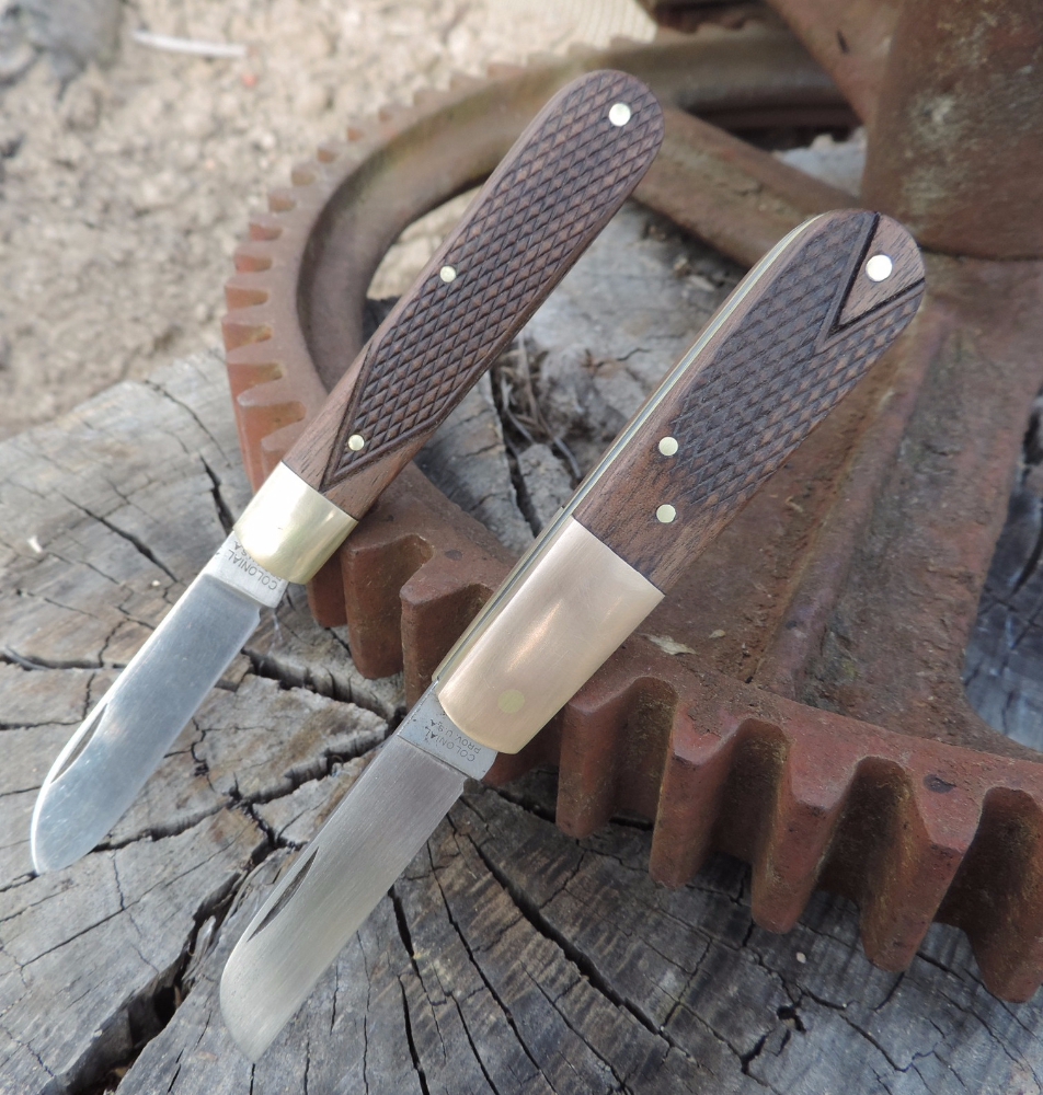

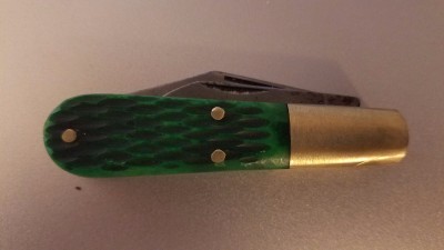

Pretty dadgummed nice for an old toolmaker with "limited tools". As long as you like the sanded look (I don't) who gives a rip what others think (even me). I see some good bones on that knife that show potential for the maker.
Lucky for you, used tools go for a fraction of their new price. Maybe you should start checking Craig's List for a narrow belt sander, or make your own (parts are available). With the proper tools and some experience, I think you have a bright future in the custom knife business.

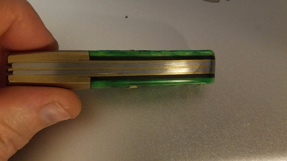

That looks great for a 1st time mod! I really don't have a lot to critique. What you did with limited tools is amazing. I really like the black spacer.
But, since you asked:
I would sand down the back of the knife where the backsprings are. I like to see them flush with the liners/handle materials. Plus it will clean up the springs.
You didn't mention if you were using a slackener when you peened the pivot pin. A slackener introduces a tiny bit of wiggle room in the joint for the blades to move without binding. Once you remove that slackener, you can always tighten things up a little more if needed. Most of us just make them out of thin feeler gauges.
Your belt sander, is that a tabletop model, or a hand version? The tabletop ones work great, and I rarely use anything other than a coarse belt on that tool. What I would invest in, if they a Harbor Freight near you, is a 1 x 30 belt sander. They're not an amazing piece of machinery, but you can dial them in okay, they don't cost a lot, and you can use the heck out of them. You can get different grit belts for them, which will help your finishing.

Thanks for the critique. I used a 0.002" feeler on one blade. I cut a slit in the feeler and trimmed it to fit on three sides. I got a little carried away and thought about checking the feeler after the last hit with the hammer. The smaller blade is perfect, but the larger one is a bit snug. If I can't get it to loosen up through opening and closing alone, I'll add a touch of diamond lapping compound to the joint and work it in, then rinse with penetrating oil to remove the remaining compound. If I do that, it should produce a very smooth action...it's what I use when lapping in 1911 slides to frames when I'm fitting them properly.glennbad wrote:That looks great for a 1st time mod! I really don't have a lot to critique. What you did with limited tools is amazing. I really like the black spacer.
My belt sander is a table top version from Harbor Freight...the 4 X 36 model they have, and it came with only one grit belt. It's not perfect, but it does a good enough job. I was eyeing the 1 X 30 model this morning. The next time I'm out there, I'll likely pick one up. I just ordered a few assortment packages of belts for the sander I already have. When those come in, I'll finish the backsprings. I left those alone until I had the finer grit belt ready.

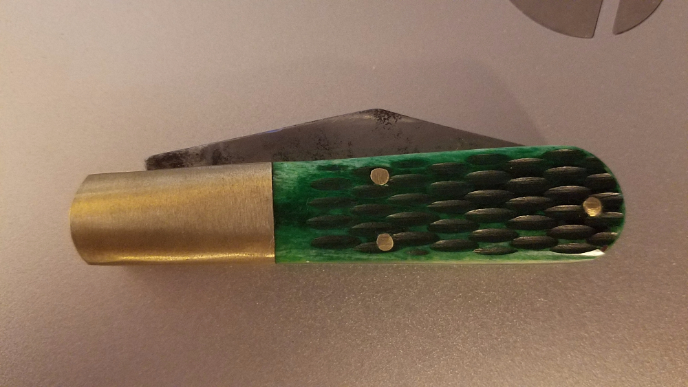

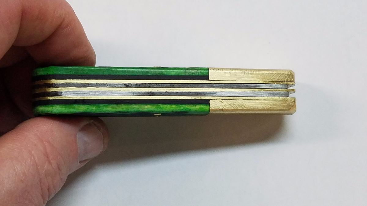

My belts finally came in for my sander, and I was able to complete the knife...but I screwed up and allowed too much heat while sanding with the finer grit belt and cracked the scales. It's not bad, and won't go anywhere due to the epoxy, but it's enough to piss me off a bit. First knife will always have mistakes, and mine show. Oh well...I still love the final product, and will carry it for a few years, I'm sure.
