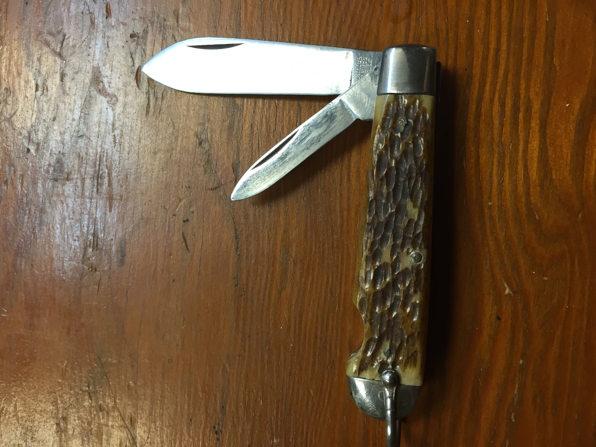

I've been developing a way to restore missing blade tips - NOT by grinding blades down to the point of the break (a method that always made me cringe thinking about) but by actually restoring the tip itself. This procedure has ups and downs, but mostly ups if you'd rather keep the original length of your blade. It also has advantages over having a new blade installed, as one can retain the original tang stamp (if the blade has one). Furthermore, the knife doesn't need to come apart so fragile original handle materials can remain intact if the knife is collectible.
I carry a wartime Camillus Navy/Coast Guard utility knife that at one time was missing about 1/4" of the main blade. I use this knife all the time, (although I don't "abuse" it). It has held up through lots and lots of box openings and the like, and even cutting big fat juicy steak, with no problem. The only real complaint with this procedure is that temper in the repaired area of the blade may be lost, but I would imagine the blade could be re-annealed and tempered once the repair is done if somebody wanted to disassemble the knife and have somebody do that.

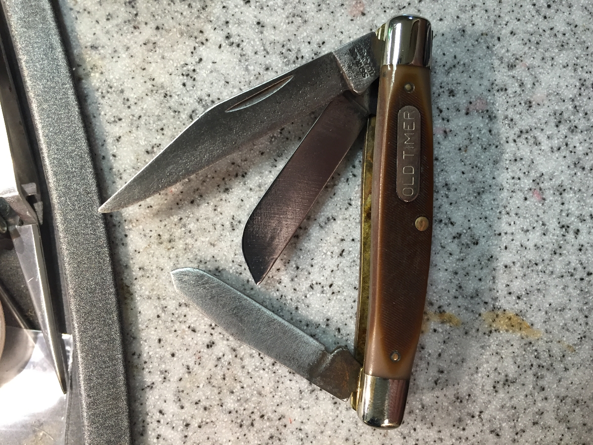

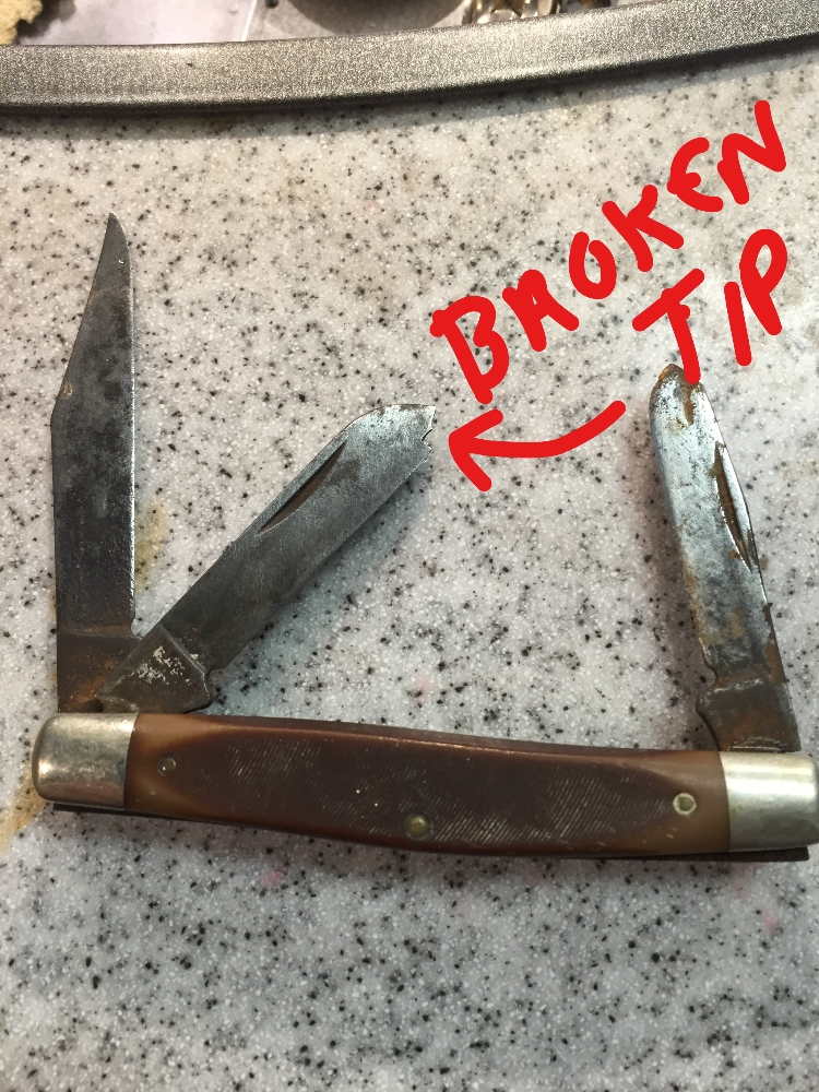

Here is a before/after of one Old Timer knife I did awhile back...this is one of the first ones I tried my procedure on, and the repair is faintly visible, but one must admit it looks 100% better than it did before with a broken tip. The afore-mentioned Camillus doesn't show where the repair was done at all.
And here is my Camillus- this blade was missing almost 1/4" of its tip (from the large main blade) at one time...

Hi guys, to answer the "how'd you do it?" question, I'll start by saying that I'm a jeweler by trade- In my shop I have a laser welder which I've been using for years to fuse gold, silver, and different types of steel (among other metals). I noticed a couple of years back when repairing eyeglasses that some metals welded better than others. The expensive, exotic eyeglass frames made of various titanium alloys were more problematic than plain old heavy, steel frames. I observed that the less expensive steel frames rarely if ever break once welded. As you can imagine, eyeglasses are constantly being twisted and flexed back and forth. So it got me to thinking about other things I could do with the laser welder. It is particularly good at fusing metals of thickness of 1/8th of an inch and less, a size which includes a lot of pocket knife blades.
As far as metal temper goes, the process shouldn't affect the existing blade dramatically outside of the immediate area where the pieces are fused. This is because the heat normally associated with welding simply isn't produced by the laser welder. (In fact, both pieces of metal are typically held in your hand as you're welding them- if they got hot enough to affect temper that wouldn't be the case, obviously). The pieces heat up moderately via conductive thermal transfer (far more prevalent when working with silver), but nowhere near the 400 degrees or so required to affect temper. The laser weld is typically only a fraction of a millimeter in size and most of the heat dissipates quickly after the laser "shot".
This obviously doesn't account for the area of the weld itself, and if the piece being replaced is very large it cannot account for that section without re-tempering the entire blade, but I suppose that can be done if you're willing to disassemble the knife.
The biggest advantages are, particularly in the case of a collectible knife, that you can retain your original tang stamp and avoid disassembly, great for a display piece or even light to moderate use. Obviously the biggest advantage is over the "grinding down" process which shortens a blade, forever altering its appearance. The Camillus shown above is used (judiciously) almost daily by me and has yet to falter or seriously dull even after cutting open cardboard boxes quite a bit. I can still slice paper with it many months after having it professionally sharpened shortly after replacing 1/4" of the tip, although I'll admit that after so many boxes opened it doesn't shave my arm hair any longer.

Colonel, In the case of the Old Timer pictured above, I experimented just building the tip back using tiny jewelry saw blades made of carbon steel, although when I did the Camillus I used a piece of a high carbon steel reciprocating saw blade I ground to shape...this made it easier requiring fewer laser shots and less finish grinding and I feel like it was stronger to boot.
Funny you mention the pitting because I also used the laser to address some pitted areas on the Camillus blade which was rusted pretty badly in a couple of spots. Basically it just allows one to "fill in the holes" rather than grinding the surface down to the level of the bottoms of said holes. I use this procedure a lot on badly gouged areas of stainless steel and gold Rolex and other high-end watch cases. This avoids the need to remove a lot of metal from the case to polish out the damage, something which has been done for decades that can greatly devalue a watch.
Strangely, I found the most challenging thing was getting the new part of the blade ground on the sides to match the angle of the existing blade. The trick is to avoid removing material from the existing part of the blade if at all possible. I accomplish this with a reductive abrasive approach and patience, just like I do with jewelry.
