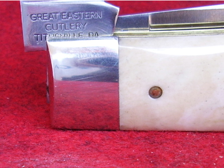

....and I wan't exactly pleased. After all the talk here on AAPK and reading the mission statement from GEC about how their intent was to produce the best knife available anywhere, I thought I'd go ahead and spring for one of the #23 Primitive Bone Jumbo Trappers. Bear in mind, this post is in no way a reflection on the establishment who sold me this knife....this is just my own evaluation of the knife. The accompanying photos will help describe my "issues" with the knife.

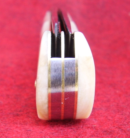

Item #1. The photo from the butt of the knife shows the difference in the thickness of the scales. The pile side measures .130", the shield side mikes at .188". Quite a difference that points to, in my opinion, very poor quality control....or an "it's close enough for government work" attitude. Would you/could you/should you live with this?

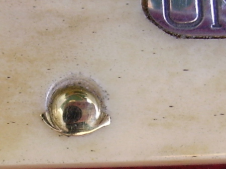

Item #2. Take a look at the main spring pivot pin. The pile side was slightly countersunk, making for a nice, smooth feel. But the shield side has been "squashed" over, leaving sharp edges and a very unprofessional look. Hell, even the Chinese do better than that!

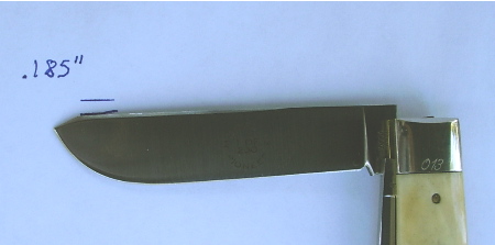

Item #3. The spey blade, when in the half stop position, has .185" of slop, allowing the blade to "swing in the wind" if you will. The hinge side of the blade, when in this position, doesn't even touch the main spring.
Again....where were the quality control people? Asleep at the wheel? On a coffee break, or again an "It's close enough for government work" attitude?

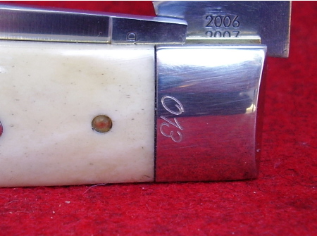

Item #4. This is the least objectionable of my four complaints, but still, for $85, I expected more than what I got. The pile side scale fits nice and tight to the bolster. The shield side has a very noticeable gap. On a knife that only has a front bolster, that shouldn't ever be an issue. I haven't done much in the way of rehandling knives, but I DO know knives WITHOUT a rear bolster are the easiest of all to fit.

- un-X-ld shield side bolster.jpg (81.7 KiB) Viewed 3574 times
- un-X-ld pile side bolster.jpg (88.73 KiB) Viewed 3574 times
- Spey blade play.jpg (37.13 KiB) Viewed 3575 times
- un-X-ld pin.jpg (57.5 KiB) Viewed 3575 times

I've been a QC guy for 23 years and seeing a knife like this just drives me nuts, especially since some of the knives I have; I rate as near custom, the highest rating I will give a production knife.dewman wrote:Hukk, you expressed my feelings about the situation with my first GEC knife spot on. If they make good on the knife I sent in for repairs.... and when it arrives back in my mitts, it passes muster, I will indeed consider buying another. But, as someone said earlier, "the jury is still out". However, I WILL hold the next one in my hand BEFORE I fork over the cash. Period!
You know, there is still a lot of folks that never heard of GEC. These folks rely on shows to buy and sell. They don't use computers and many have AWESOME collections of knives. They see a knife like this, forget it, won't give it another thought.
A FEW points:
1. A person that would put scales on that were mis-matched by .060, DOES NOT KNOW THEIR JOB-period end of discussion, thats nearly a full 50% of the smaller scale.
2. Each employee at each step of the way should be able to sort out good parts vs. potential defects, No parts is parts mentality.
3. Institute a Final Inspection BEFORE it is sent out for an engraver to be numbered.
4. It is real easy to set up parameters, expectations for each step of making the parts and assembly. Maybe it has never been done in cutlery, but maybe it needs to be done. Not everyone has the same work ethics and those folks need to be identified so that they can understand what is needed, in black and white - get rid of as much gray area as possible.
5. To avoid knives such as this, a Statistical Quality Control System needs to be implemented AND upper management needs to pass on their knowledge of the collector market to those doing the work. Everyone needs to understand WHY, not just HOW!
6. LAST AND NOT LEAST I still support what GEC is doing and will continue to buy their products.
This is merely a summary of the key points of my previous post. I do want to acknowledge the strides they have made in reducing rework, or at least I hear more happy tales than sad. Realize that you will hear the bad stuff more often than the good because GOOD IS EXPECTED, therefore not acknowledged.

If this knife had the endcap on it, two of the problems would not exist. That variance in bone at the butt end would not be noticable and the slab would have been cut to size and fit perfectly at the other end. It appears to me that the thickness is fairly consistent from a top or bottom view and just not tapered to the end uniformely. But the customer needs their voice heard on expectations.
The spun head having some flack is a minor issue, but could have easily been cleaned off at the finishing table.
The blade slack at half stop. No excuse, and probably by standards the only actual warranteed defect.
But to be fair, if anyone is going to put their handles up to any kind of benchmark, DO NOT BUY PRIMITIVE BONE. It is what it is; soft in some spots, inconsistent from end to end, and full of natural defects. I would almost guarantee that 95% of Great Eastern customers would rather have it mismatched in size as compared to what it probably started as (full of cracks and lines on the surface). It probably ended up in the hands of one of the other 5%
I have looked at over 50 of these primitive bone models; and they are a very interesting slab with every one having its own character. But almost every one would be considered flawed using standing criteria. Out of 16 knives that I have either sent back or have sitting aside to send back, 12 have been primitive bone. And, of the others, there was only 1 per se defect. And that is about 5% with primitive bone included.
If dealers get to the point that they have to be the final QC for every waranteed knife they sell, I can guarantee the margins would go way up. For example, factory fresh Case knives that I buy have generally gone through Case, a distributor, a master dealer, then me. Should each level unwrap the knife and guess as to whether 98% of all customers will deem it acceptable? By then the knife has been handled so much that (according to another thread I saw the other day) it would no longer even be deemed "mint". Most of my customers don't want anybody opening a factory wrapped knife. Dealers sure don't want to open factory wrapped knives, for a multitude of reasons. Not to mention that if dealers started sending back knives such as this one for repair, they would probably not be a dealer for very long. Not saying this knife should not go back; but the company needs to know what real customer expectations are, not what some old grumpy dealer thinks about them.
A long post just to say a couple of things. GEC is not consistently making perfect knives yet. But they need their customers to define the perfect knife for them.

I talked to Bill Howard (I must have been fortunate) and we agreed that, really there is no such thing as a perfect knife. But I think we can all agree that a standard of quality needs to be established. That's what GEC needs to define and has yet to do. EXACTLY what constitutes quality? To me quality means that it meets both visual and mechanical specifications.
Maybe there are no specifications which could also be called goals or targets. Mike is 100% correct, Primative Bone is what it is, I failed to acknowledge that, but I do believe that the handles could have been better matched. But he is right again about the rear bolster, it would hide or minimize the scale mis-match.
They will likely have to take the knife apart to fix the slack in the blade at half stop.

Mike, come on now.....the variation in thickness of the scales, looking from the butt end could have very easily been corrected by taking more of the material off on the side that was AGAINST the liner. It has NOTHING to do with the cracks that were on the OUTSIDE. That had already been finished and polished. It was simply TOO thick. Period. Pure simple logic that I face every day when working with wood. Nothing magical about it, primitive bone or not. That knife was a hideous example of craftsmanship and totally unacceptable. Like Hukk said, that knife should NEVER have left the factory.

dewman: Those bone slabs are not buffed to thickness and size before they are installed. It is just like pearl or ivory; when you start taking them down to the bolster and to fit you will uncover things that you did not expect. Having said that, you are completely right in that the other side should have been taken down to match. But with this bone; if you start taking the other side down and come across a wormhole or something you will be in trouble again. It is like a bad haircut, by the time you get it evened out you may have a burr.
I have some that you can actually see where the bone is softer in a spot and when they took it down the grit ate that spot a lot faster than the rest of the slab; causing an area that you will have lost your mind over. But it is the nature of working with a bone "in a state of natural deterioration, showing severe age and weathering" (advertised remarks on Primitive Bone). All the other bones have jigging on them before they start and are in a stable format; thus they will always be very consistent in thickness (because you can't do a lot of buffing once pinned on anyway).
If they would shelf this Primitive Bone today it would be too late for me; as I don't like a knife with a crack from one end to the other. But, as you have seen, the problems with it goes beyond just the finished surface appearance and makes it a slab that is just too complicated to put into customer hands. I don't think I could go through every one I have and find one that would be acceptable if not marketed as Primitive Bone was.
But again, your knife did not meet your expectations and that is all that matters to the company and the dealers. And I have cleaned 200 of these for storage and not noticed the blade play that yours had; so I am going to be testing half-stop spring tension more closely now as well. And will send it back if it has the slop that yours did. So you have already improved the quality of the end product as far as I am concerned.
Don't kid yourself, every knife that goes back to the factory raises the price of the next line coming out. You can especially see this on the Primitive Bone. This line is 10%+ more expensive than the other handles; I expect solely due to the expectations of returns due to the handle inconsistencies.
The bottom line is that collectors do not have to settle for something not acceptable to them. Period. But there are always circumstances surrounding a given issue that need to be understood. And when you pull on one end of the rope the other end moves. And understanding all this I would have sent the knife back in your situation, thus don't confuse my comments for criticism...
