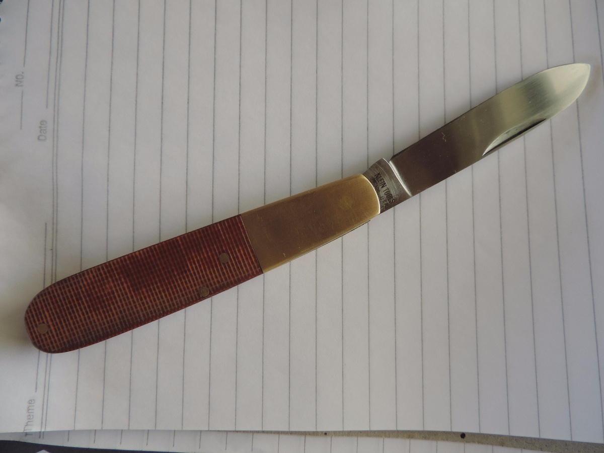

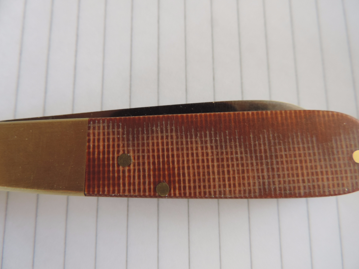

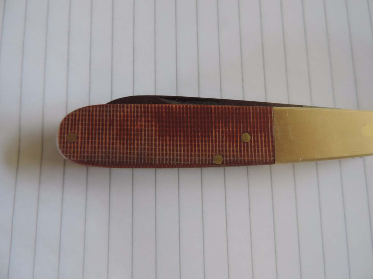

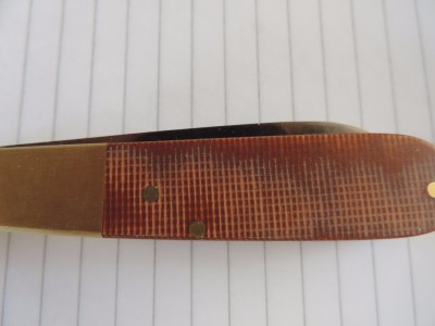

Only my second time using a Micarta type material and both times ( two different Pieces) I'm having trouble with achieving a consistent look across the entire surface.
This is Commercial Micarta style material purchased from a retailer not home made.
I can get part of the surface giving the 'thread' pattern but another part with a smoother look - showing more of the resin - with the 'thread' pattern less distinct. See Pics below.
My first thought was there is a depth/thickness variation between the two areas but this has been hand sanded to 600 on a glass platen taking the knife to the platen ...so ....thickness variation should(???) be minute I would have thought.
I've tried a number of variations from just dry paper to Wet & Dry with Water and Wet & Dry with WD40
This is yet another of my TL29 tear-downs and rebuilds.
Any thoughts ???Anyone on how I can achieve a consistent look?
I would actually be happy with either smooth or patterned "look" so long as it was consistent across the whole surface ........ Thanks in Advance.

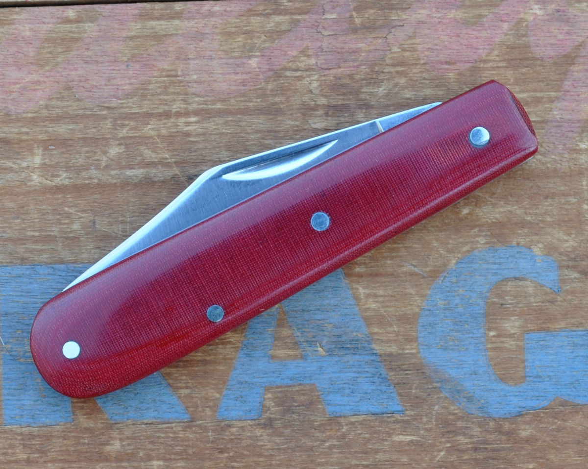

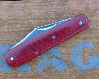

You might want to try slightly rounding the covers rather than keeping them perfectly flat. This way you get the layers to come through, like the rings on a tree. Just try to keep the high point down the center of the knife. You could also try buffing your handles with a finer compound which would blend those threads into the handle a bit. Here's an example that I used both methods on:
