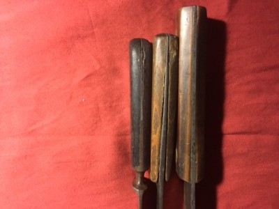

I have these 3 old tapered tang knives: a Foster Bros., a Russell, and an unidentified one I'm guessing to be french.
I'm trying to find out about tapered tangs. On the 'net I find mostly discussions by modern knife makers. They seem to all agree that it has some effect on balance but mostly it looks cool, and demonstrates their skill as craftsmen.
So my questions are: Was balance the main reason these older knife makers used a tapered tang? If it was important enough to do in the first place why did they stop? And third, is a tapered tang a reliable way to determine the age of an old knife?

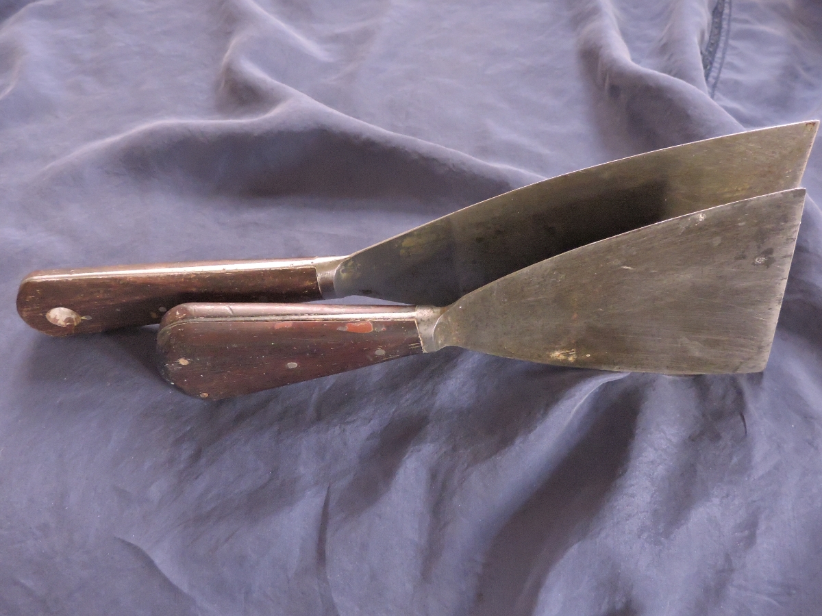

A tapered tang is something I look for when buying old kitchen knives. If it's not there it is not a deal breaker, but it is a nice sophisticated touch. I have old taping knives with tapered tangs and I'm showing a kitchen fork and a few kitchen knives with tapered tangs.
I think it's indicative of older knives. To me, it implies quality. Does it improve balance? Frankly, I doubt it. Once you get used to a knife it's going to work for you regardless of the 1.1368 oz. removed or not. I don't know why they tapered the tangs but I'm glad they did. It's just classy.

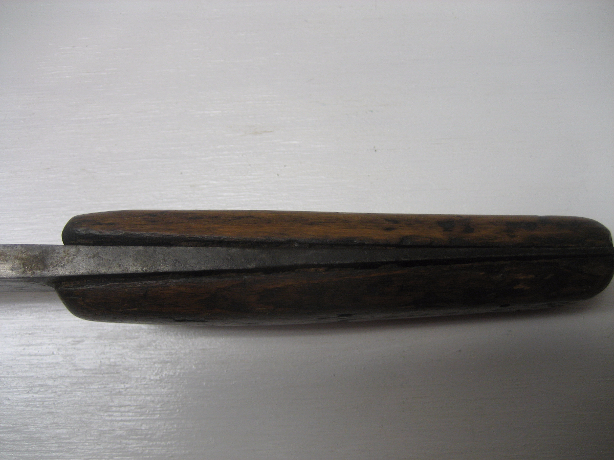

::handshake:: Here is the only old tapered tang that I have, and I don't have a clue who made it, it's similar to a dexter green river butcher knife except for the small handle pins. Most Dexter knives have 2 or 3 large rivets. but it is pretty old and has the tapered tang. Terry

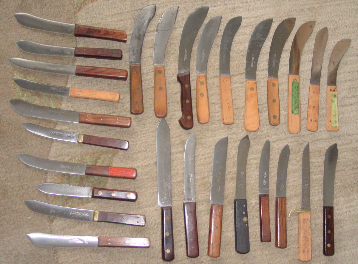

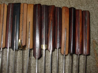

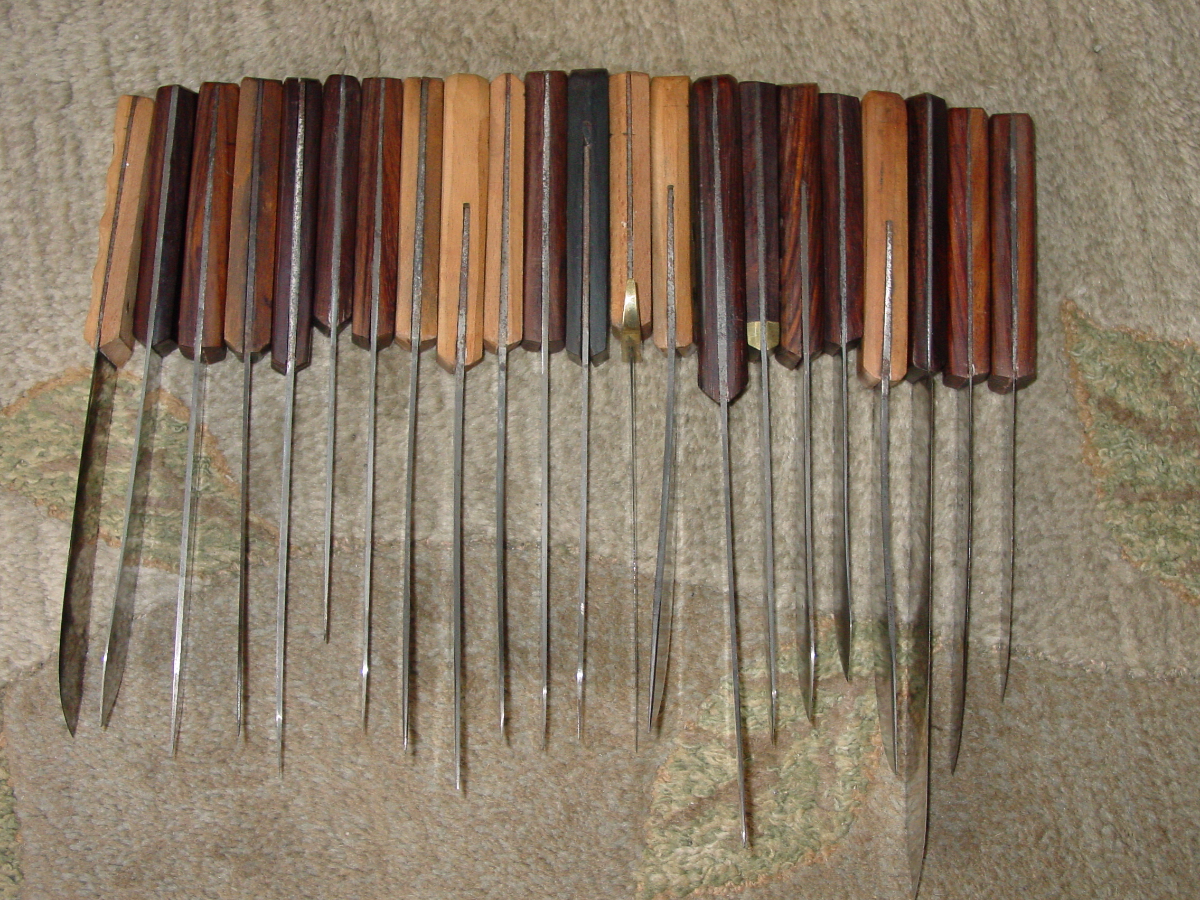

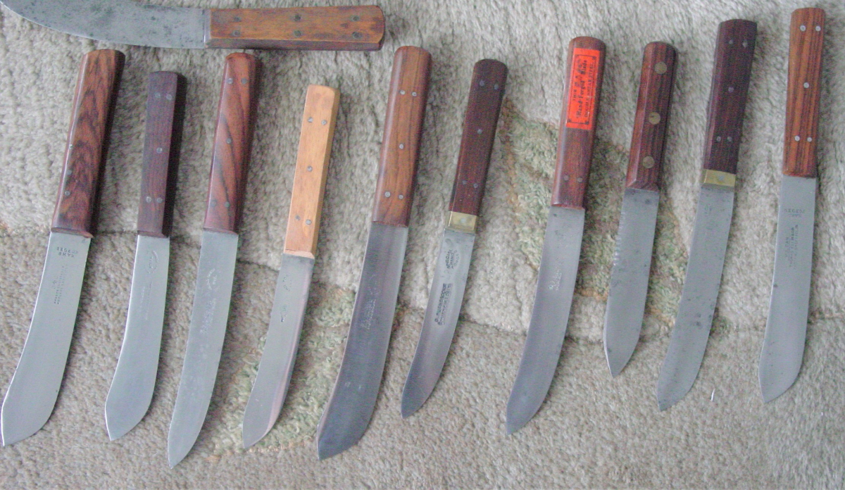

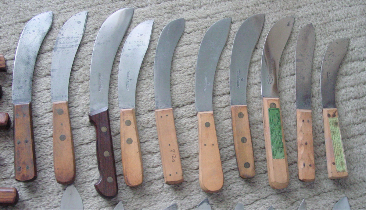

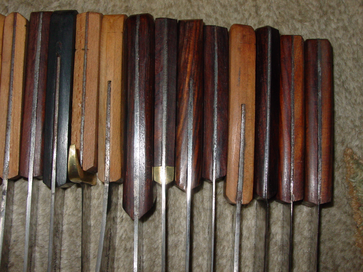

Here are some hand forged tapered tang knives I have had for some time now. They are for the most part unused and factory original knives made in England and over 100 years old. Some of them have tangs that don't extend to the butt of the handle. As a result of the forging process tangs are tapered both from the heel of the blade to the handle butt and also from the top spine to the bottom edge.
I don't believe the reasoning behind this was anything but purely economic. They didn't use any more steel than they had to on these old knives. Less steel = less expensive to make = lower cost to consumer.
Balance is something that comes into play with your custom made knives not on these old users.
Wayne

Wayne, Nice bunch of butcher knives! I too have some of the "half tang" styles and I'm sure your right in saying that they were cheaper to make. None of these butcher knives were very expensive, just made to use. ::handshake:: Terry
