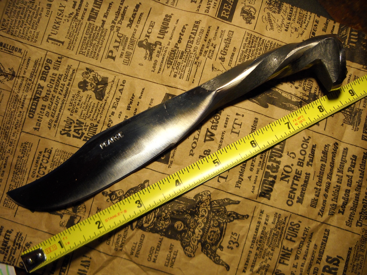

One of our children gave me an interesting knife made from a R.R. spike years ago. I've never used it for any thing, I'll make a picture later this evening and post it. The handle was made by twisting the head and part of the spike into a spiral then the blade is flattened and shaped into the blade.

Here's my R.R. spike knife. It was in a box marked "THE EDGE COMPANY, USA".
On their web site I found this knife was available back in 2011 for $150. It was probably made by the late Perry Pearce's grandson Logan Pearce. On the Pearce Knives web site, the knife can be purchased for $55.
It came with a 1/8" thick leather sheath, riveted not stitched, functional not fancy.
I've never used it ::shrug:: like about 95% of my knives :oops: .
It was interesting to see what different materials are used by Pearce making knives besides the RR spikes. Wire rope, box wrenches, re-bar, tire tools, etc.... ::tu::
