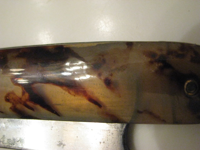

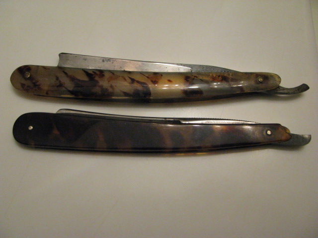

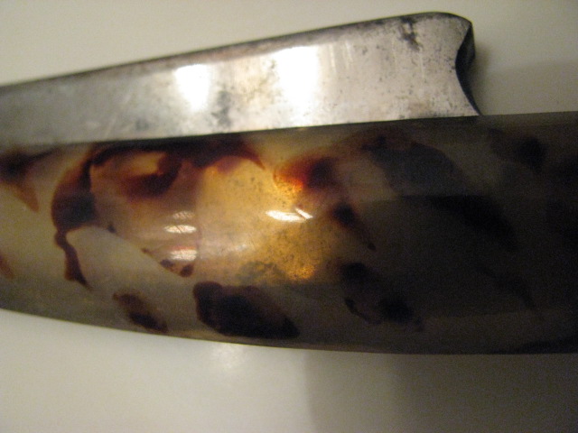

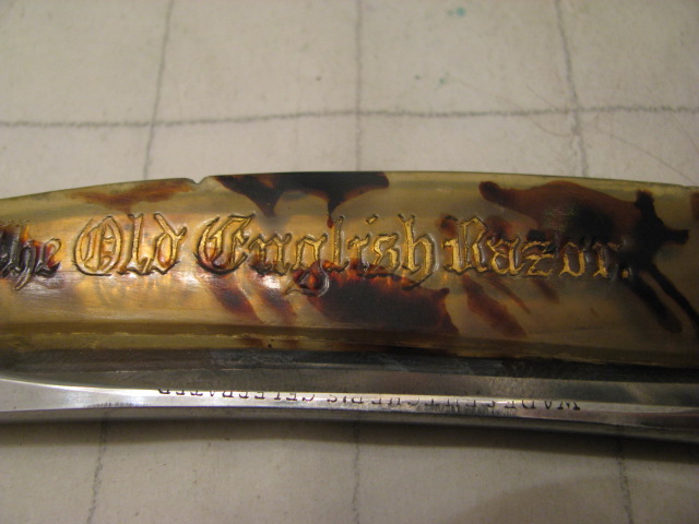

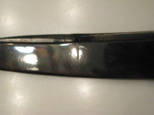

Here are some pictures of two straight razors I own that are real tortoise shell and one that is colored horn.Note that the last picture shows the parallel lines in the handle.

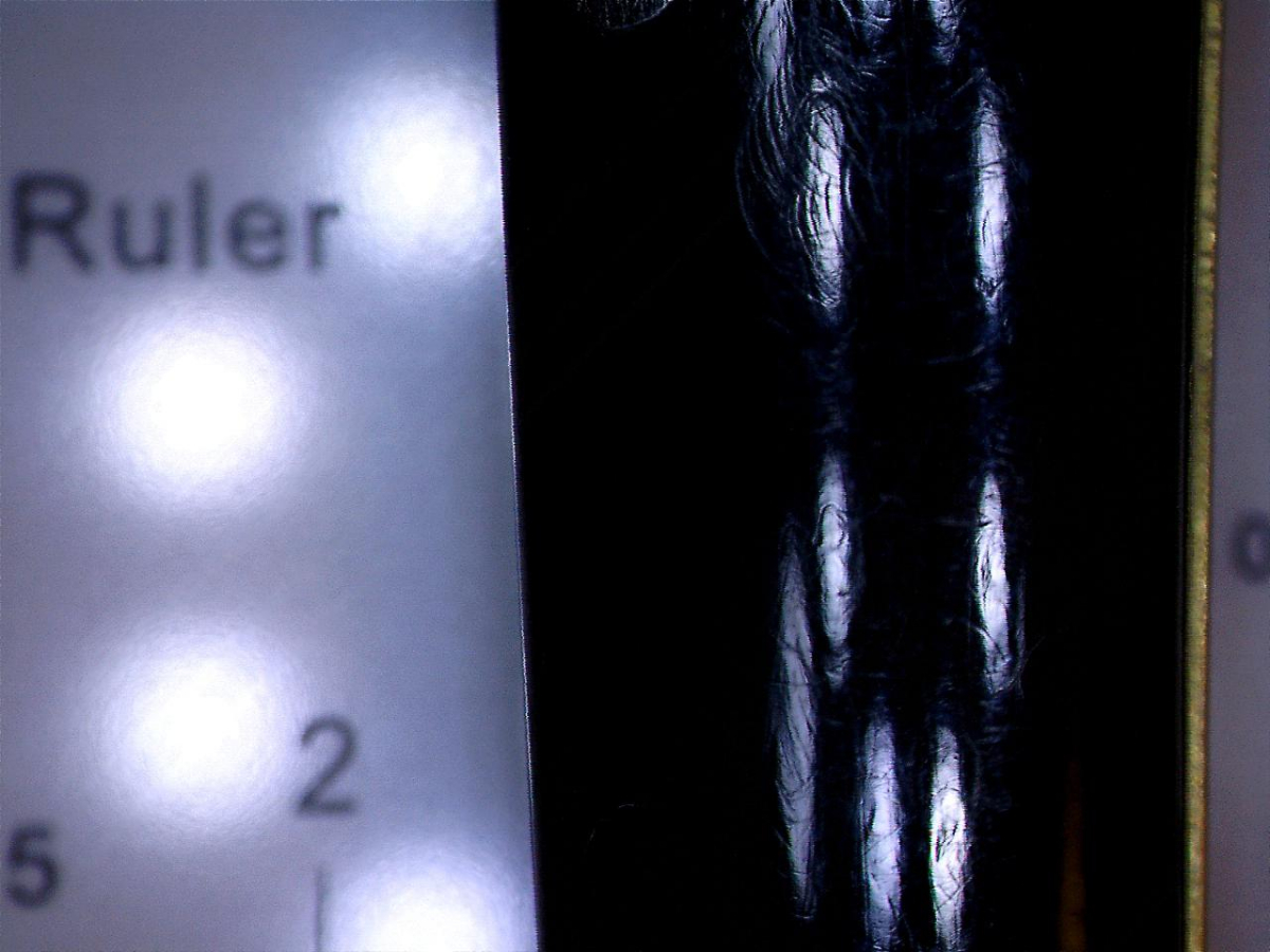

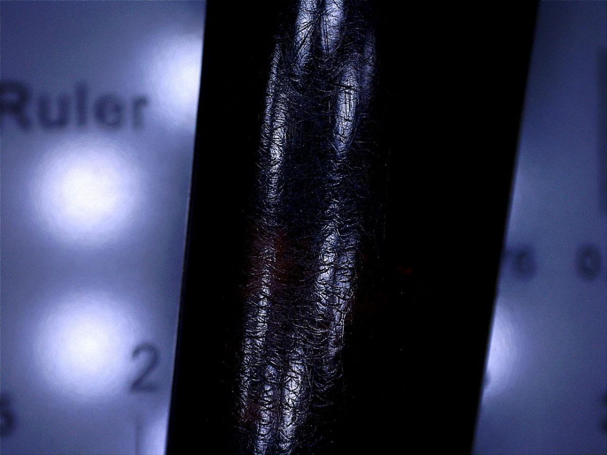

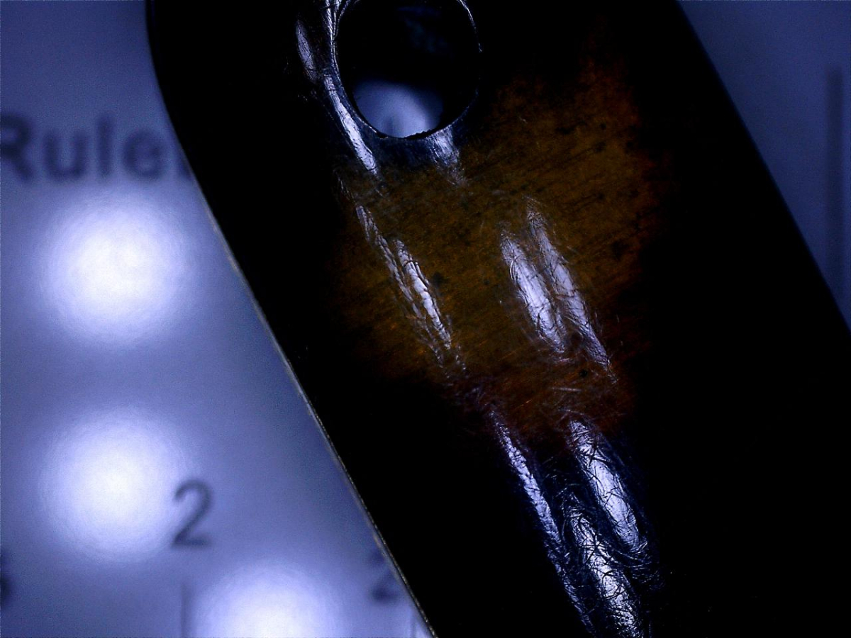

Here are some pics I took with my new USB microscope at various points along the handle of my knife I believe I can see some layering or scaling.

kootenay joe
- Posts: 13373
Re: How to tell real tortoise from celluloid?
Greg, those pics are too dark for me to read. Cannot tell what i am looking at ?
