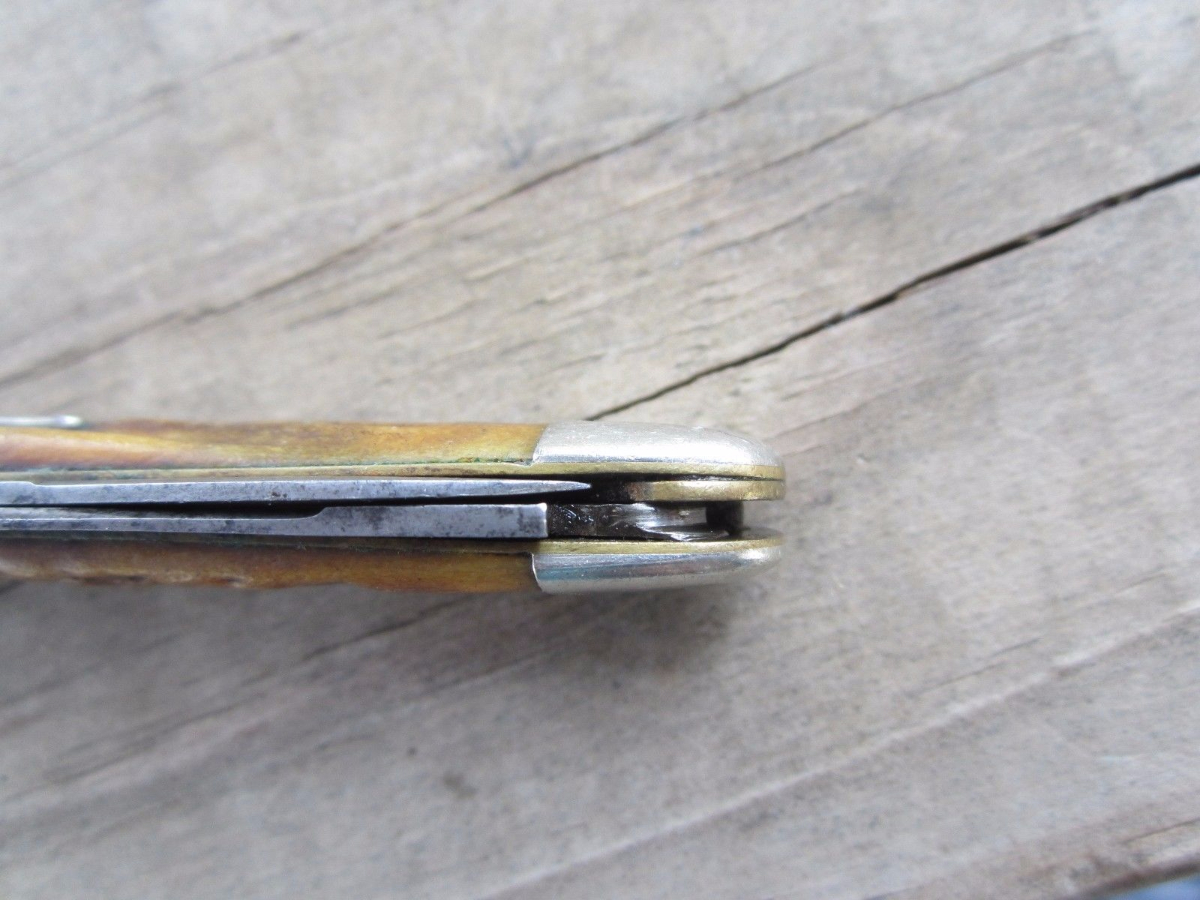

As an example the first picture shows an extreme case that would require disassembly of the knife and welding as a fix. I show this picture just as an example to show what these ears can look like.

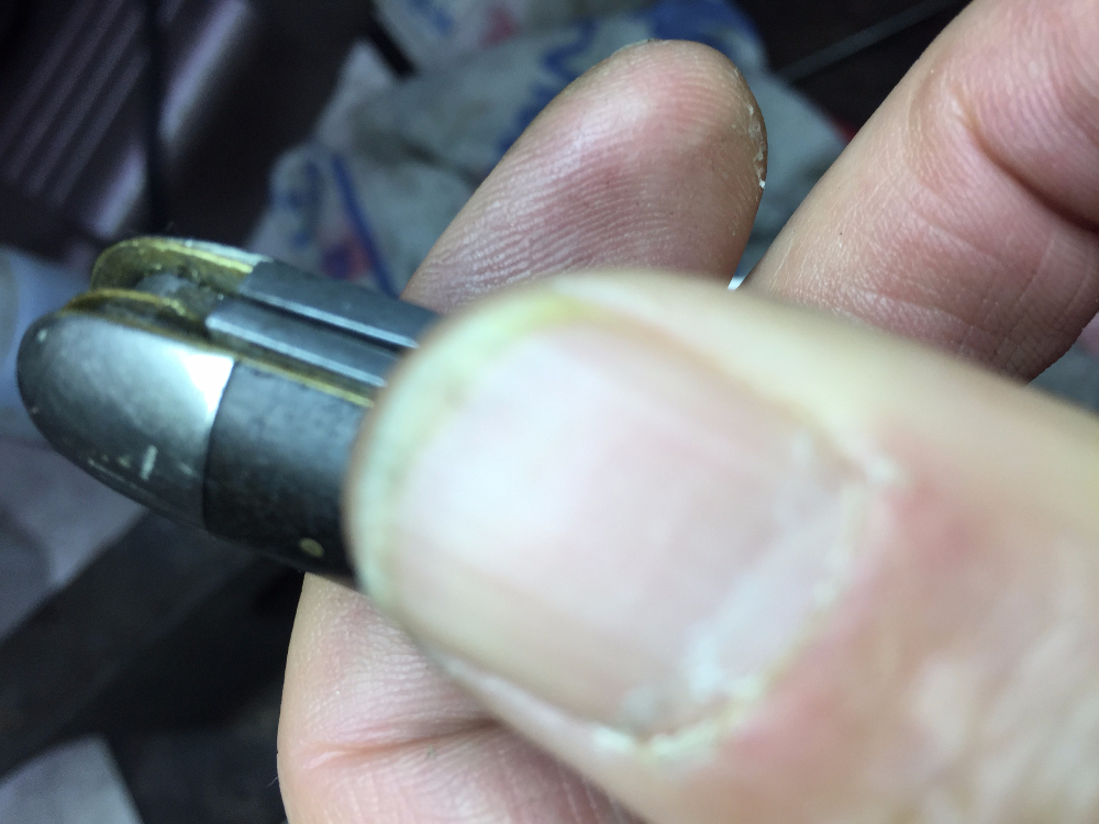

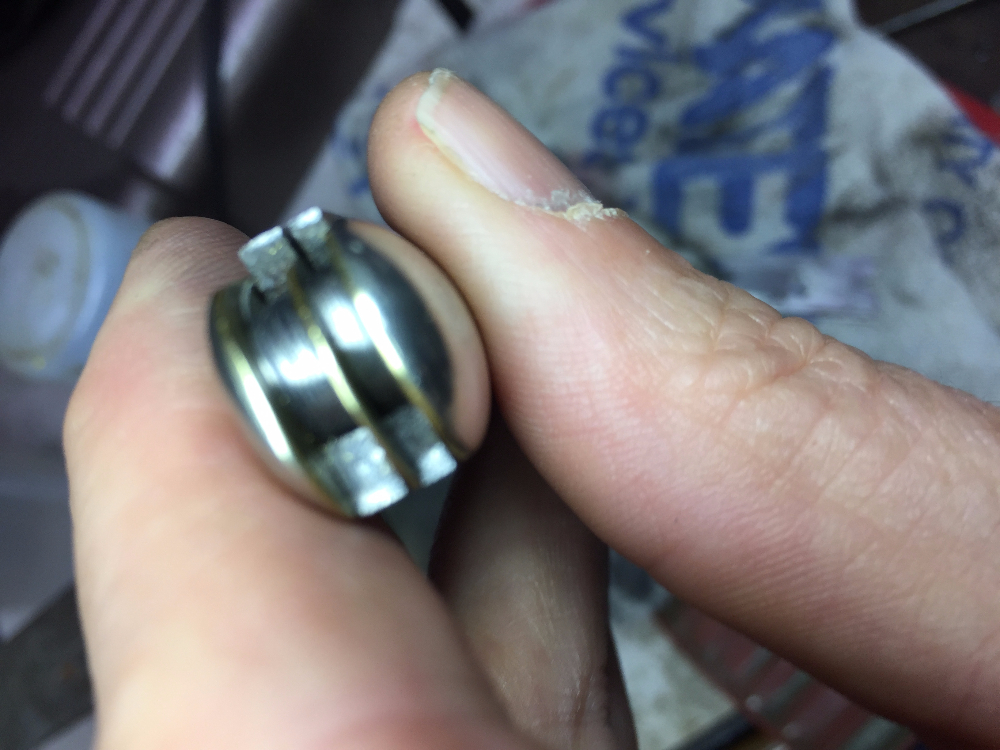

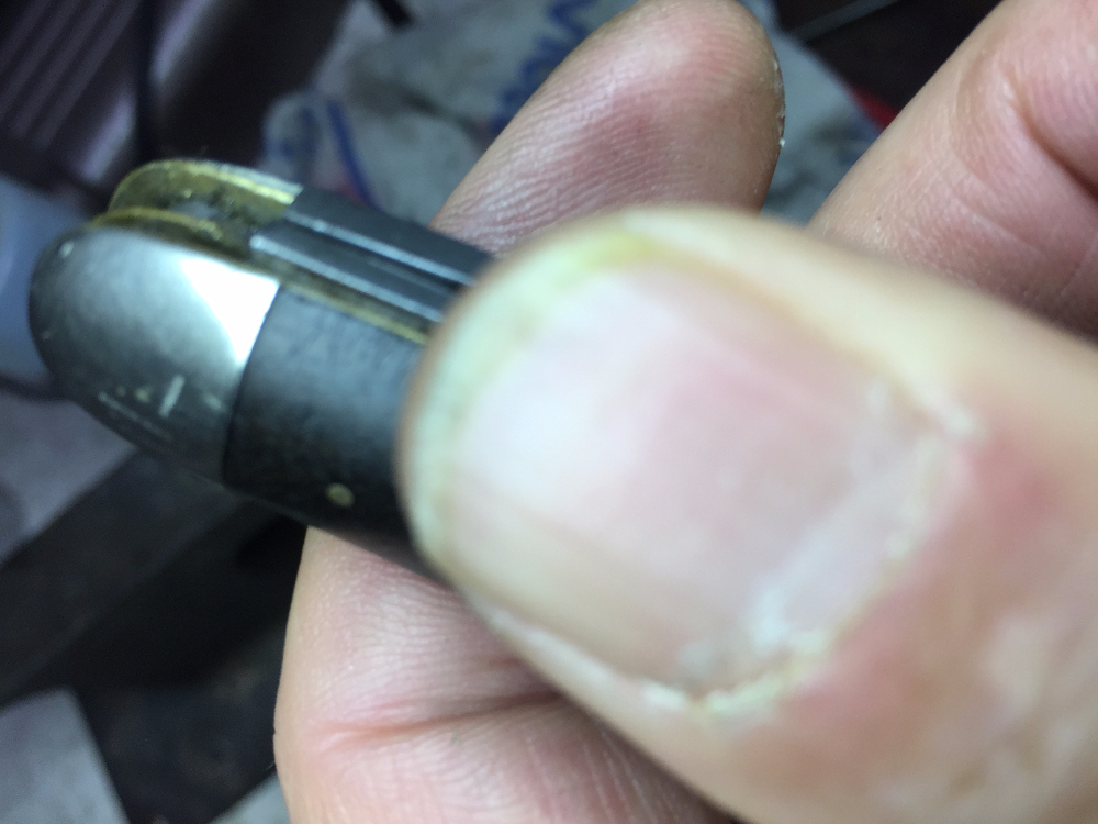

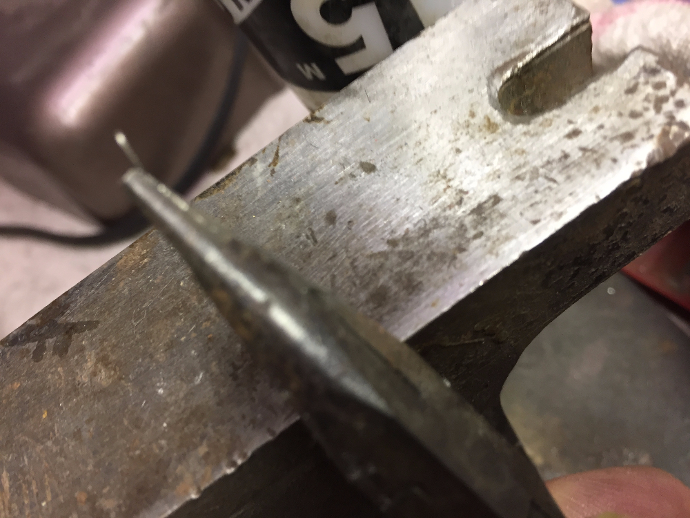

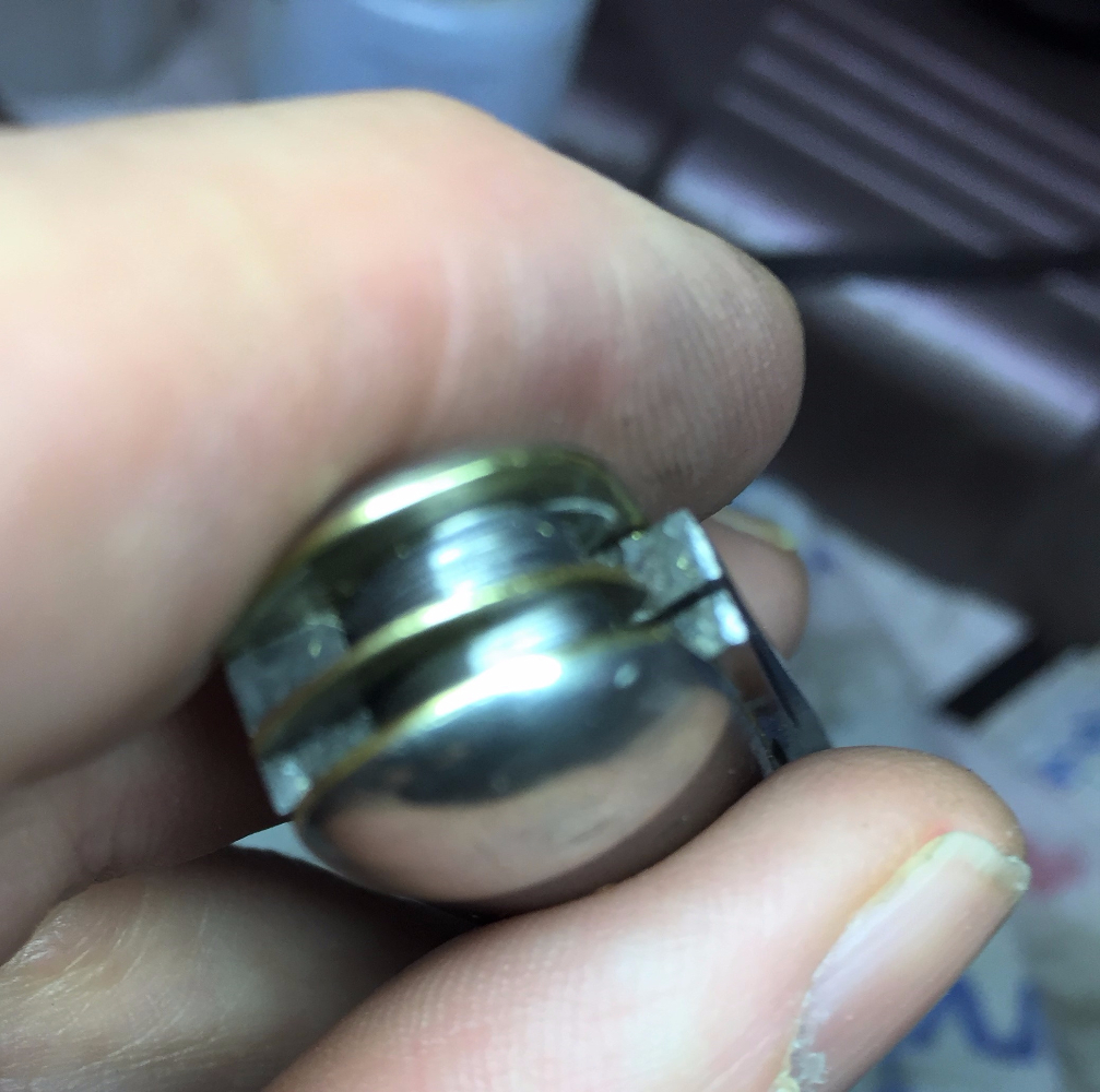

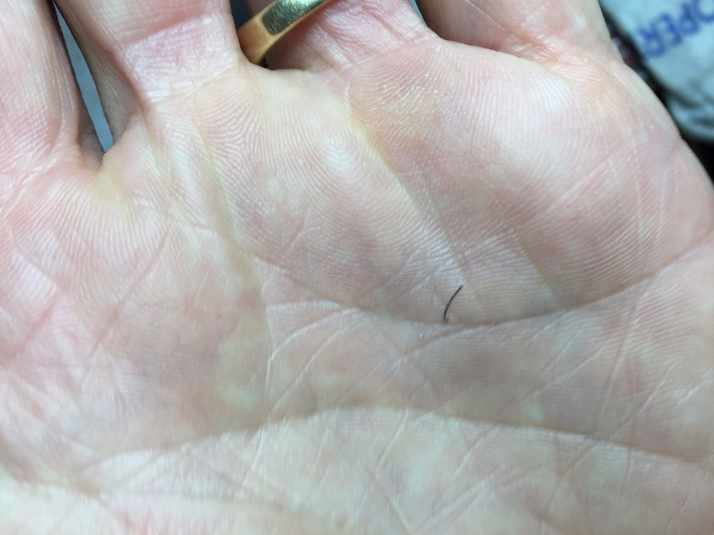

The following pictures are an old Case Bros. knife that had no snap on the master blade. Opening and closing the blade at first felt like there was grit in the gears. Even after oiling the joint the knife had a grind while opening and closing. Examination of the joint with some light magnification revealed tiny ear slivers on both sides of the master blade tang. The pile side ear was removed using precision files and the mark side ear was actually cut using a single edge razor blade. These pictures show the mark side ear after it was cut and before it was pulled out. It's hard to see but looks like a small curled piece of hair. You can see how small this little trouble maker is in pics 2,3,4 and 5. I then pulled the piece out using some needle nose pliers, img 4119. Img 4122 shows just how tiny this ear was in my hand.
After filing off the pile side ear and cutting off the ear on the mark side this old Case Bros. jack walks and talks like new. As with any type of repair the less intrusive the better. This knife was fixed without taking it apart, a much preferred method for me.
