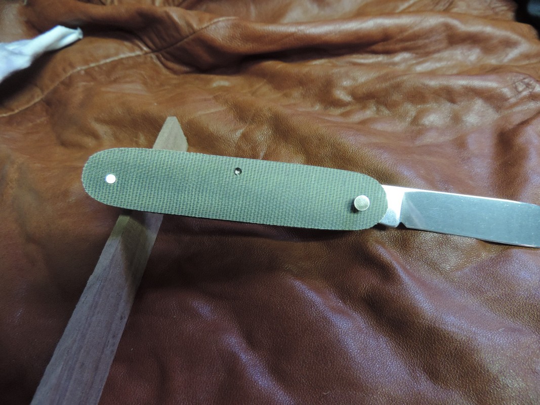

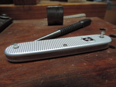

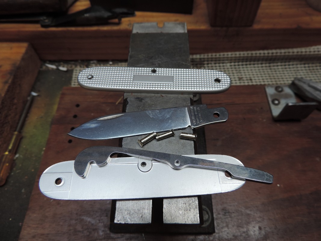

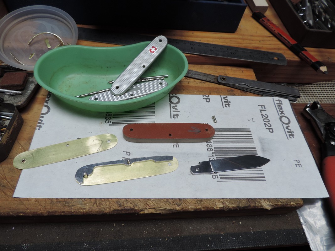

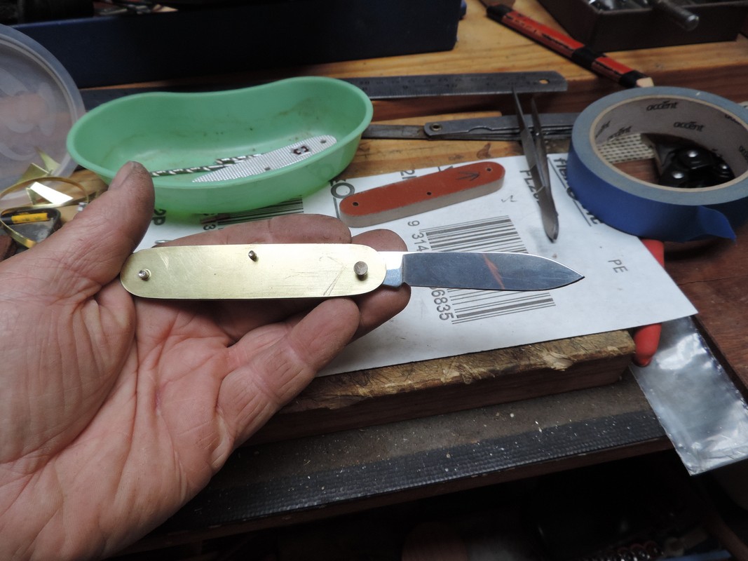

I sort of put my big foot in it with this project. A chap asked me if it would be possible to re-handle a Victorinox Solo with Micarta and I said "yep it should be". Next thing I know he's sent me the knife and micarta and said "show me".

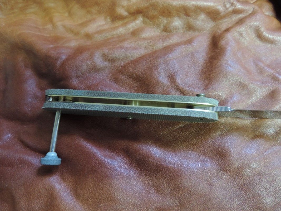

Decided it would be prudent to add liners just for a little additional rigidity.
So far so good
More to follow as I progress ... Derek

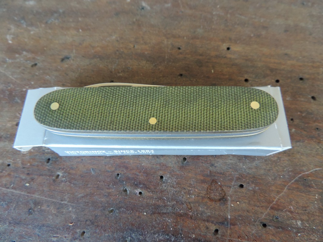

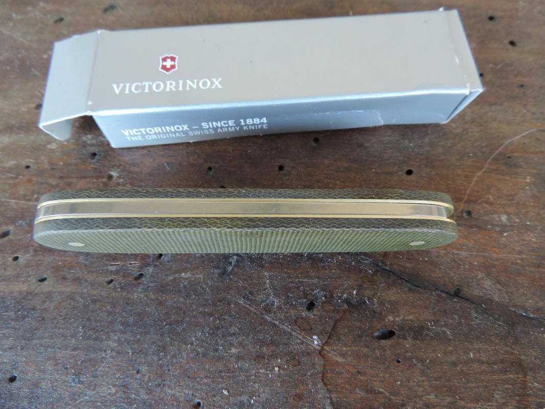

Re: Re-working a Victorinox Solo FINISHED!
One of the more fiddly projects I have taken on. Is it an improvement? I trust the owner thinks so.
My first time ever with Micarta which was interesting and as always I learnt heaps along the way.
Derek

The liners were a good choice, as the micarta, even polished, would have made the action a bit weak being pressed against the tang and spring.
If you think that was fiddly, try working on one of the little bitty SAK's like a rambler or minichamp! (I did one once, never again lol)

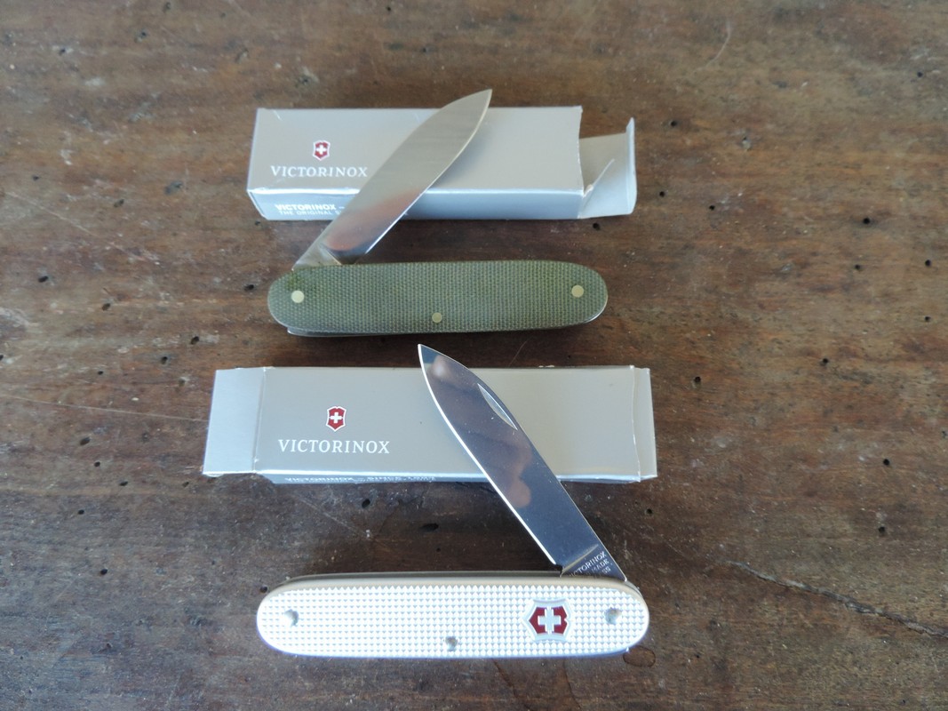

Thanks fellas... it's in the post on the way to it's owner.
The second Victorinox Solo pictured he sent to me so "I could do one for myself". But it has gone back too.
Having done one I'm in no hurry to do another
