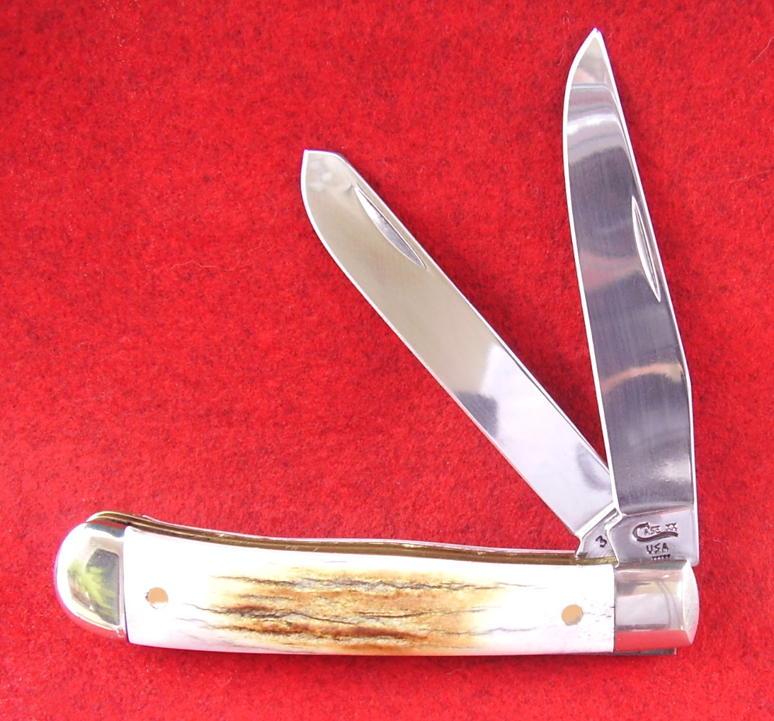

Here's a Case 3254 that I rehandled last night. It's yet to be buffed and polished, because I've got to get a new buffing wheel when I go down the mountain to Boise later this week. I don't want it to pick up the black color on the only one I have left. I'm learning more and more as I do more and more of them. One thing I learned that's VERY IMPORTANT. DON'T....I repeat DON'T put the front bolster in a vise and tighten it! It makes for some very interesting changes in the "walk and talk" that aren't always easy to correct! Sometimes, you can't EVER get them back to where they were BEFORE squashing them in a vise. But, live and learn.
I took my time on this one, trying very hard to remember all the mistakes I made on the others that came before. This one, when finished, will probably be my best effort to date. But, I've always had a real affinity for stag....or in this case elk antler.

SWEET ::tu::

Very nicely done. ::nod:: I agree with Kaleb. You seem to have a natural ability to do knife work. 8) Do you have gray hair, yet? An old knifemaker told me about 30 years ago, that every time you make a mistake, working on a knife, you would have 1 hair turn gray. He was totally bald headed. He said, "Well, after they all turn gray, they start falling out, 1 at a time, every time you make a mistake". :lol: So I suppose he had made his fair share of them, huh?
The learning process is never-ending. Keep up the great work.

lookin good Dew ::tu::

Looks good, get better every time. I found it easiest to buy 10 or 15 wheels at a time. Then store used ones in a plastic bag and write the type of buff or wax and ferrous or non-ferrous on the bag.
I'd hate to be near done and have a scratch appear in a Brass bolster because that wheel had been used on ferrous (steel) and had somehow picked up a grain of steel. It doesn't take much.
Good work.
Hukk

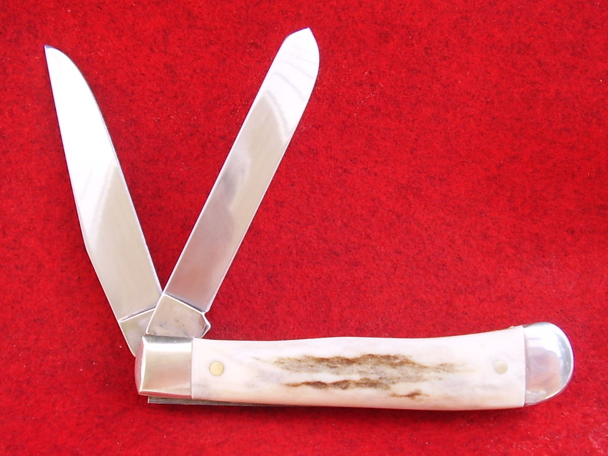

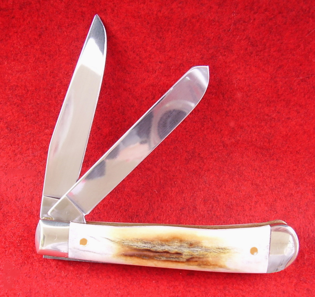

Well....here's the finished product. It's the Case 3254 I showed earlier in this post. I finally got two new buffer pads, polished the stag scales, then toasted them and did the final polish on the whole works. Both sides match pretty well. One of the harder things I've encountered in my limited experience of rehandling, especially with bone or antler....or, I suppose I could call it "Idaho sandbar stag". :lol: :lol:

Looking REALLY good, that's a really nice trapper. When folks ask where you got it, you get to say I made it. ::tu:: ::tu::
Ever run into antler that is gray and has been on the ground a couple years or so. It can still be used. Do your own coloring and have it stabilized at WSSI. I have some at the shop, looks nice.
