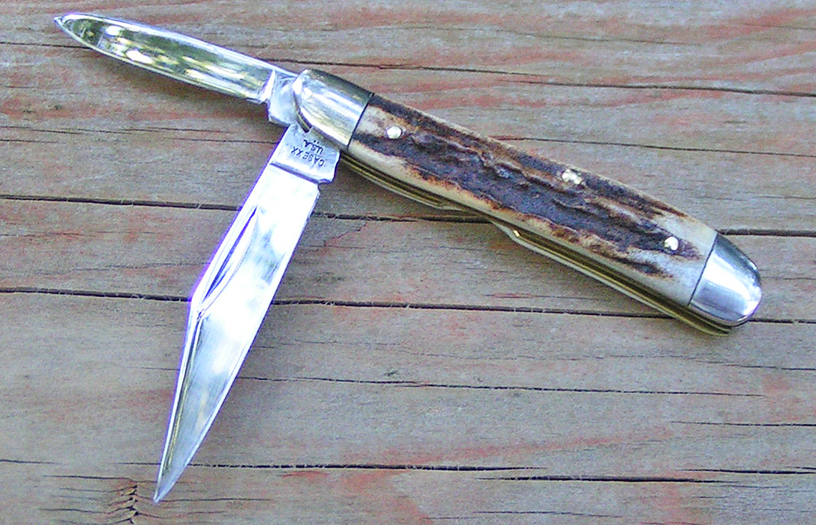

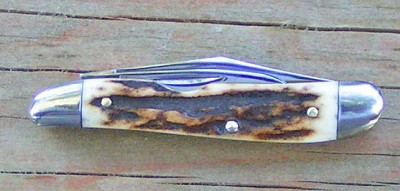

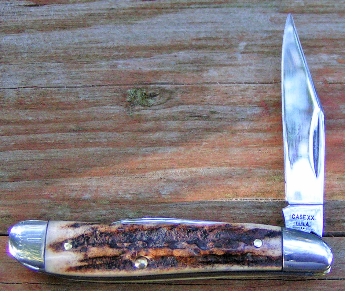

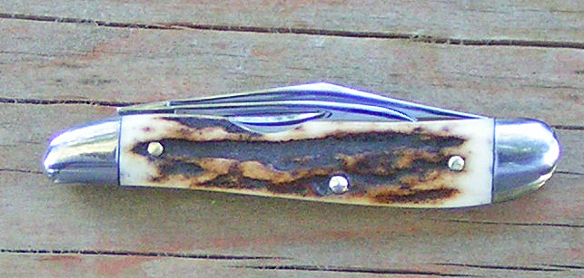

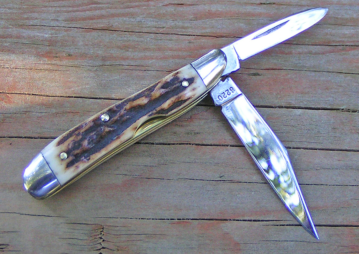

A while back Bob (just bob) sent me a few pieces of stag that were warped and some were twisted. I soaked them for a couple of weeks to soften them up, then clamped them on some steel bars to straighten them out. This is same method I had used before on some stag that came from the Henckel’s factory, however this time my method failed me. I had to flatten the back side of the stag pieces on a belt sander in order to get pieces large enough piece for a knife handle.
This 1978 Case Peanut seemed to me to be the perfect canvas for these two magnificent pieces of stag. The stag pieces were badly warped but I was able to flatten the backside of a couple of them on my belt sander so that I could get two pieces long enough to rehandle this knife.
The blades in this knife are so small I did not etch them with my logo, though I did put my initials and the year on the inside of the mark-side liner. I also didn’t put the shield back on it because of the ridges and valleys in this stag. I would have to take the highest rigid down over 1/8”just to put the stag on top of the valley, then I would need to inlay the shield even deeper so that it would not be knocked off. Sometimes shields are right for handles and sometimes they are not. This was an instance where I felt the depth at which I would’ve had to cut in order to inlay the shield, would have made the whole knife look wrong.
