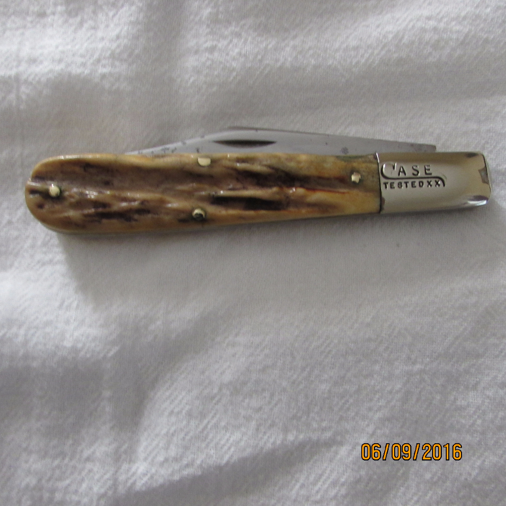

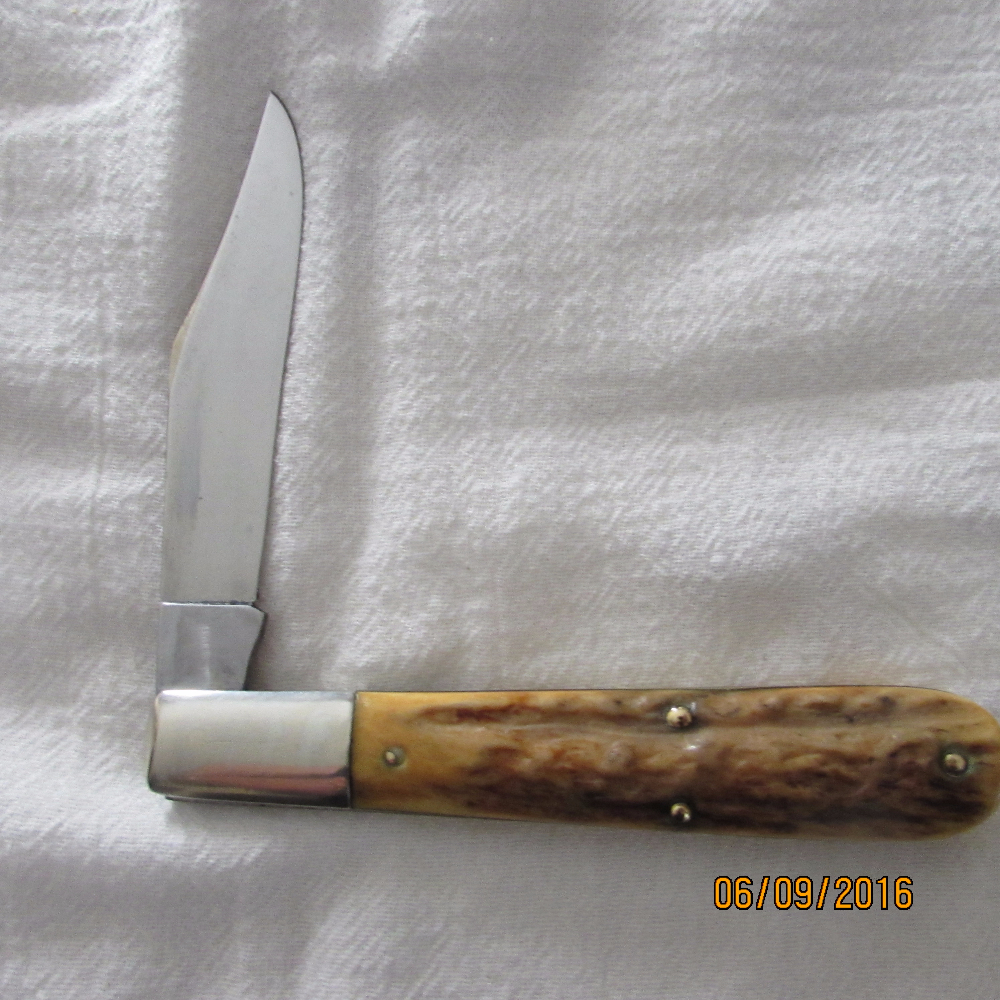

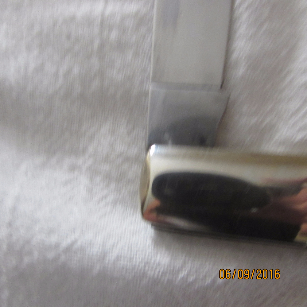

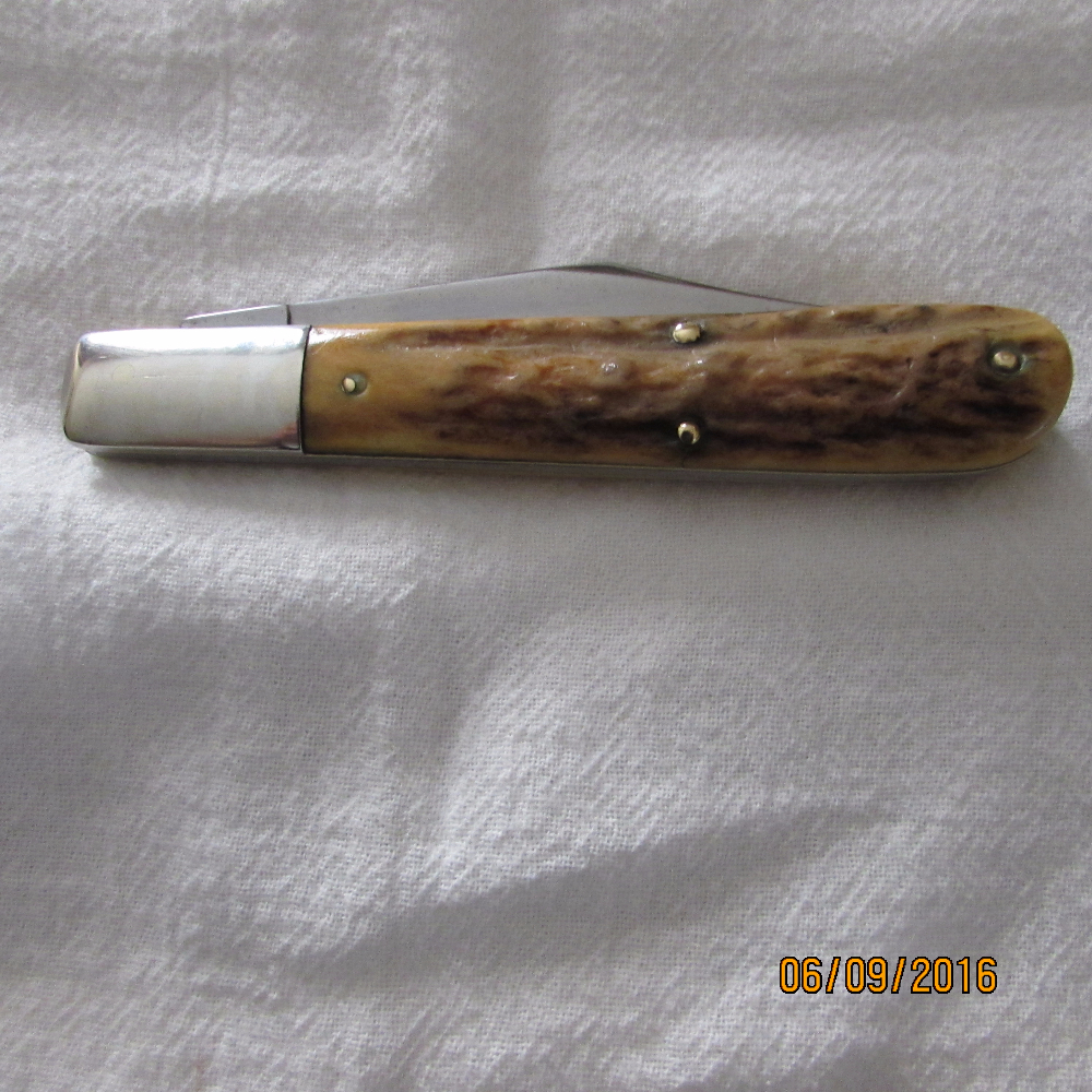

Please give a ball park value for this knife, Thanks!

Sorry to tell you but its a bad fake.

I may be mistaken about the name of this knife. Looking closer it doesn't look like a barlow, The frame isn't straight like a Barlow, this knife has a curvature in the frame. Sorry I miss-lead. I'm supprised that I wasn't corrected by an expert in these matters.

Unfortunately, there is no "reference" to fakes. There are only references to legitimately manufactured knives. When a knife does not exist in the reference of the legitimately manufactured knives, that is what defines it as a fake.Huck Finn wrote:Tell me about the fake part, can you give a refrence? A source of information would be appreciated.
Can you tell us why you think the knife was legitimately manufactured by Case in it's present condition? For example, what pattern number do you think it is?

The "experts" can't correct anything said about this particular knife because Case did not make a knife like this in the Tested era.Huck Finn wrote:I may be mistaken about the name of this knife. Looking closer it doesn't look like a barlow, The frame isn't straight like a Barlow, this knife has a curvature in the frame. Sorry I miss-lead. I'm supprised that I wasn't corrected by an expert in these matters.
I realize this is probably not what you are hoping to hear with regard to the knife for which you are seeking the appraisal. I also realize some of the comments you have received are very short and direct. Please keep in mind: A) People are trying to help and are taking the time to respond; and B) Any negative comments are directed at the knife - not about you.

No offense, but the only reason you see curvature in that frame is because the guy that put it together ground the curvature into it while making those stag handles fit the frame.
It isn't a curved jack.
And almost any regular or curved jack with bolsters that constitute about 1/3 its length is a "barlow" pattern.
The knife you posted is a fantasy, because as Ralph stated, Case never made one, so it cannot be "counterfeit".
Whether it's worthless depends on who is opining. I'm like Roger. I'd destroy it.
Others would carry it because, after all, it is a knife, it opens, it closes and I assume it will go "cut".
It isn't useless, but it is not a collectible knife upon which anyone should spend good money.
No insult, just considered opinion.
Too many good knives out there to buy fantasies, fakes and counterfeits.

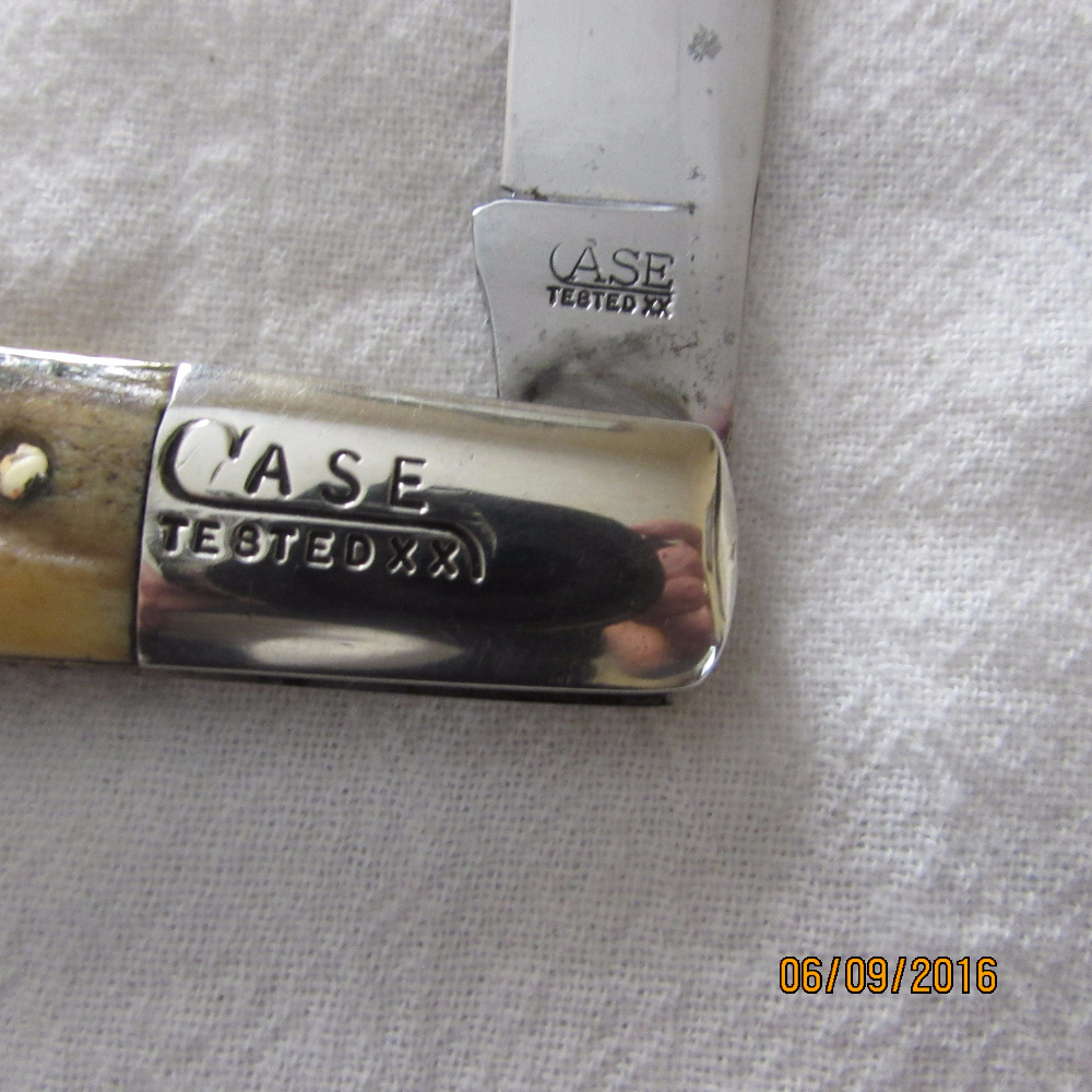

My problem with the knife is the "intent to deceive" which is evident by the branding marks on the knife. Please note that I am correlating "problem and knife" not "problem and person".
If the Case branding were removed and there was no branding or it said something like "custom knife", then I would be fine with the knife either as a using knife or a knife to be sold.

The name on the blade, and on the bolster, surely you know Case didn't ALWAYS stamp a pattern # The knife may be a fake or it may have been altered. I can see that , The stag is different but ,but I haven't heard one word from the responders about that. I think for myself and could be in error. Know one has any real reference to prove that the knife is a fake; Surely you know what a pocket knife looks like. I admit it could have been altered. Could is a BIGGGG word. I'm serious about this . HOW HAS IT BEEN ALTERED???????????????????????????

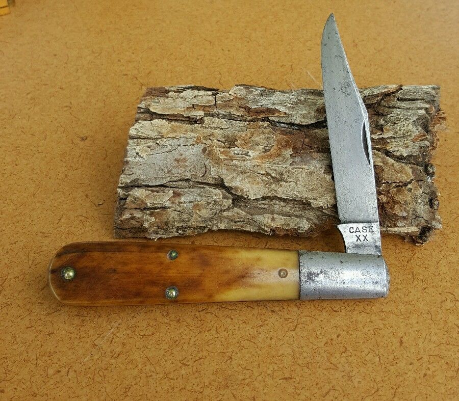

** Not an expert by any means** ___ I think Steve is basing his call on this info from his book hope all can enlarge & read** ____the knife photos are a 1940's XX 6143 with ""Iron Bolster & Liners"" and the OP's knife has what looks like Nickle Silver Bolster & Brass Liners ** __ was in the early 70's when Liners were changed to brass ___ I'm sure Steve will clarify, later ( didn't mean to butt in, just trying to help
) Still a very nice looking Case ,Huck !!!
No mention of a Stag in Parker's Pocketknife Trader book**
