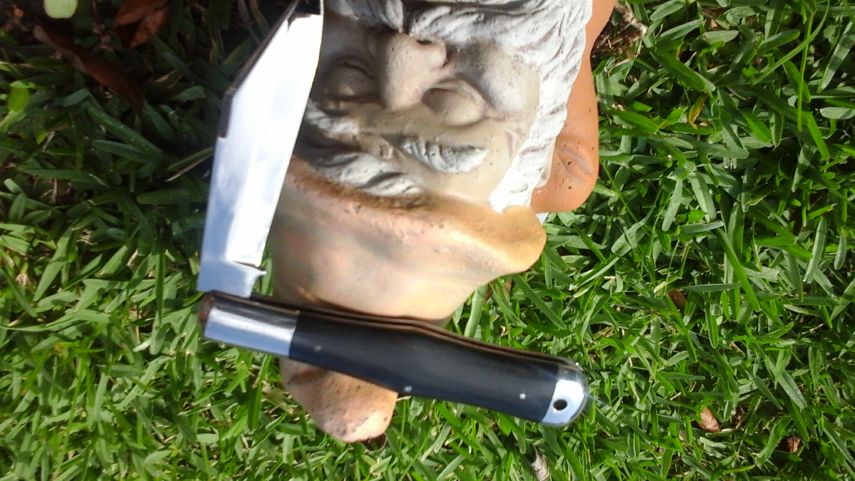

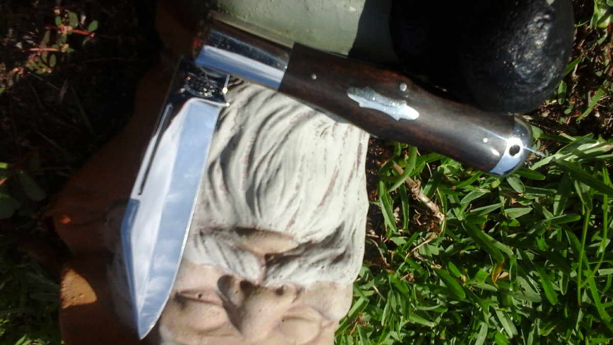

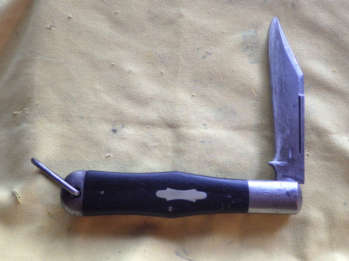

Would really appreciate any information on this Keen Kutter. Acquired on a trade and would like to confirm it's authenticity. Thanks in advance!!

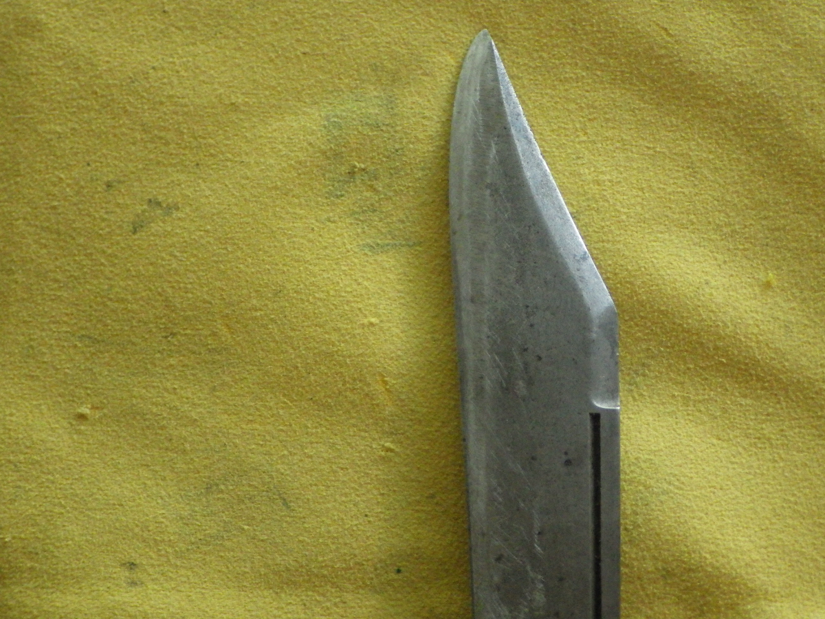

Looks good Gatorfleas, nice knife you have there. It is hard to tell from the photos if it has been buffed or if that is its true full polish, but I would guess that it was originally etched Keen Kutter and that it has been buffed out. It looks like the blade is quite full, possibly with a reshaped tip. If you can get a photo of it flat and in better focus it could be determined. Looks to be 1930s. Nice score. I imagine it is 5 3/8ths closed?

I agree with Beechtree, does look to have blade loss and then reprofiled and buffed. Still looks like a full belly on that blade though.

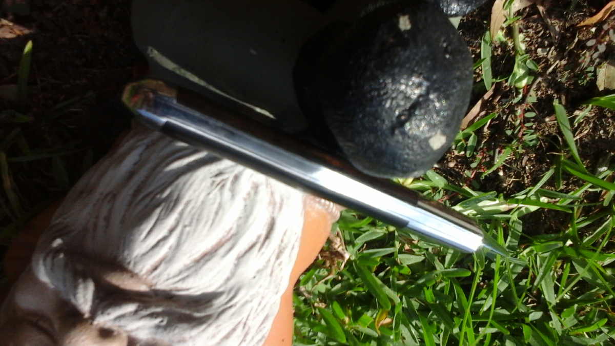

::tu:: Hey Gatorfleas, a couple of tips for your photo's. Try a solid color fabric or leather to lay your knife on and take the photo in the bright shade, not direct sunlight. Your camera must have auto focus like mine, the grass blades are in sharp focus but the knife is a little blurry. Looks like it might have been buffed quite a little? Nice knife however! Knives are a bitch to photograph, to eliminate the reflections. ::handshake:: Terry

From Sellen's book it is a 1196 3/4, manufactured between 1905 and 1920. I have one in much worse condition. The swedge, shield, pin placement, bail hole and kick on yours and mine are exact matches, so I believe yours is a good knife. However, as has been previously stated, heavily cleaned and polished. Originally it would have had a blade etch that said "TICKLER" in block letters. Would be nice to see more photos in focus. In your photos the ends of the long pull appear to be rounded, but, this could be a illusion of the photograph? I believe the ends of the pull should be cut fairly squarely, although one end of the one on mine is slightly rounded as well.

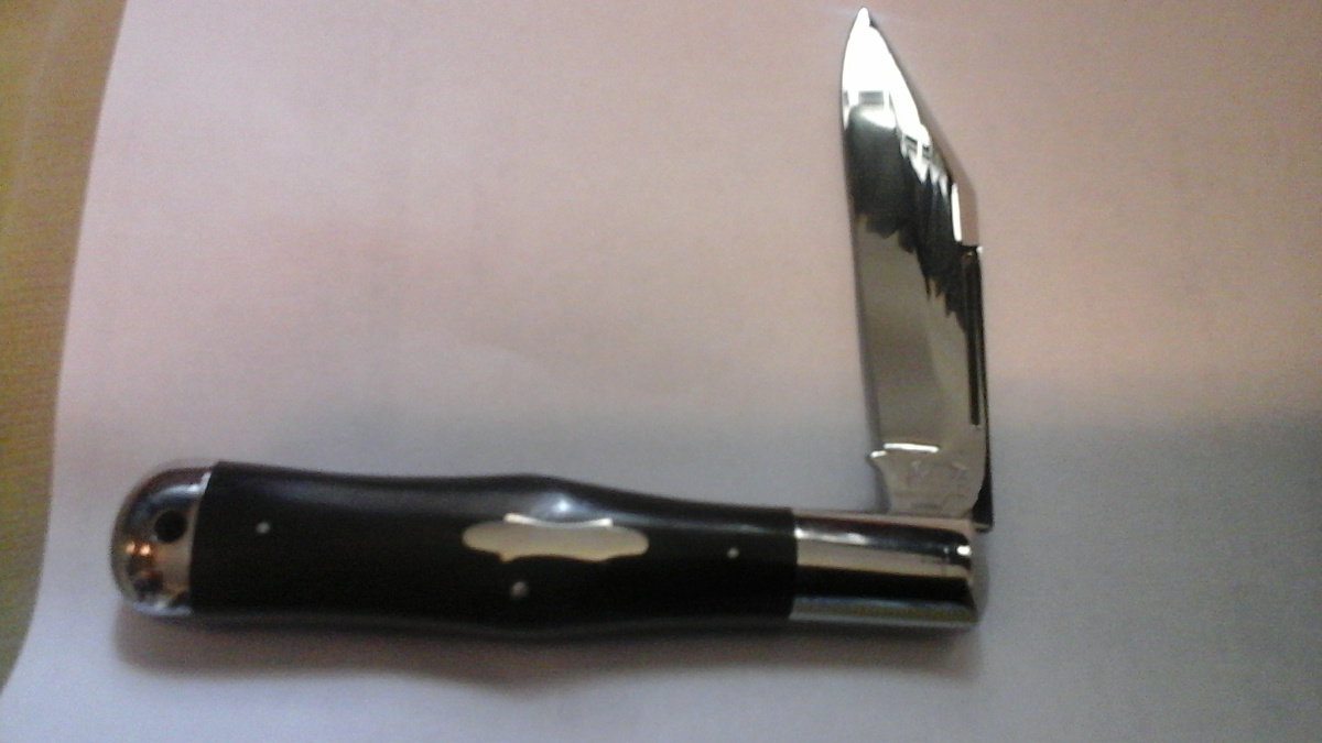

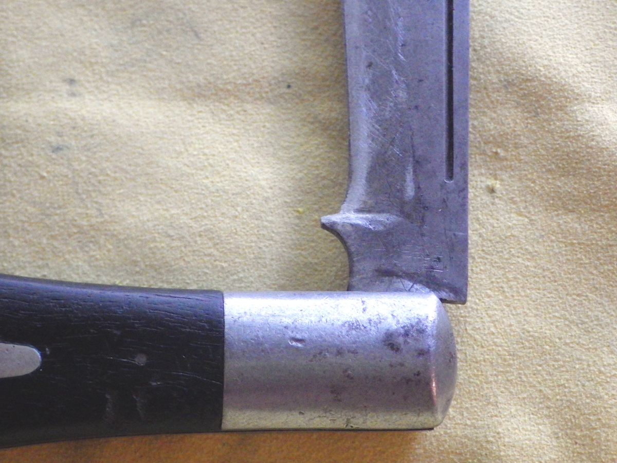

Here are some photos of mine. The second one shows the fairly distinctive kick and the second one shows the swedge. In the second pic it also shows the end of the long pull closest to the bolster is very slightly rounded.

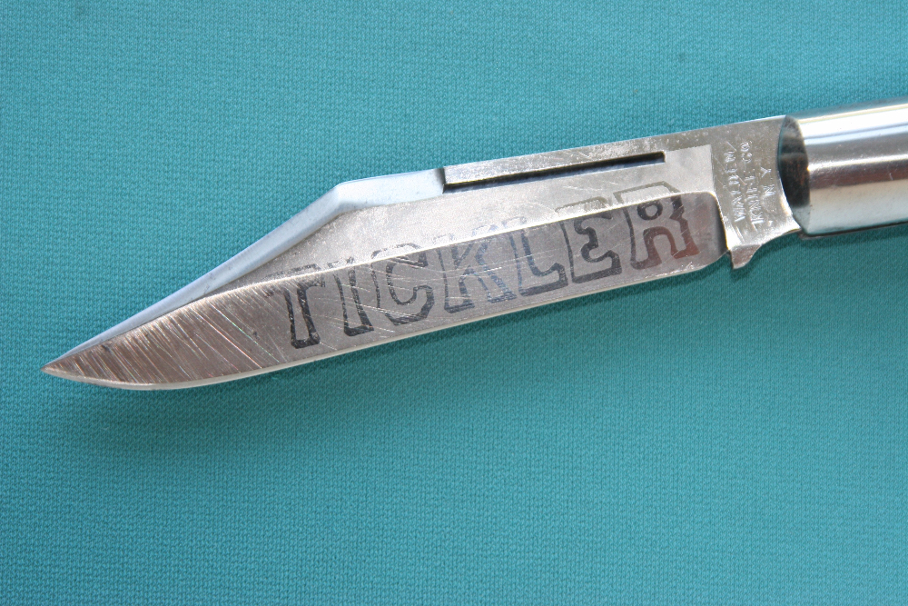

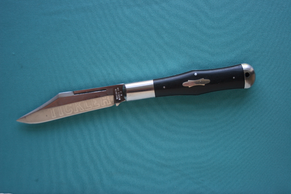

Here is one etched Tickler but is marked Walden Knife Co, I have another one marked KK with a different etch that will take pics of and post tomorrow.

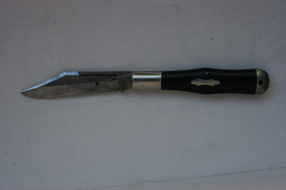

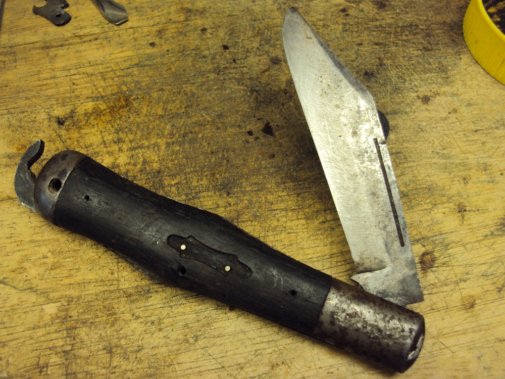

I just remembered I had one of these. Mine is in a state of disrepair, but it's pretty much all there.

galvanic1882 wrote:Here is one etched Tickler but is marked Walden Knife Co, I have another one marked KK with a different etch that will take pics of and post tomorrow.
Beautiful knife, Mike. Quoting from Sellens: "Walden was shown as a Simmons house brand in the 1908 through 1911 Simmons catalogs". Looking forward to seeing pics of your similar KK.
Glen, that blade is fairly full, knife looks like a good candidate for one of your rebuilds.

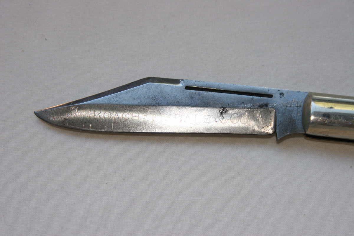

Walden made knives for Simmons till they bought the factory in 1911 and probably kept the same works after that. Here is the other FH, nice ROACH-TISDALE & Co etch.
