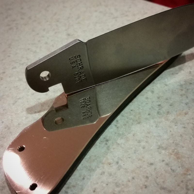

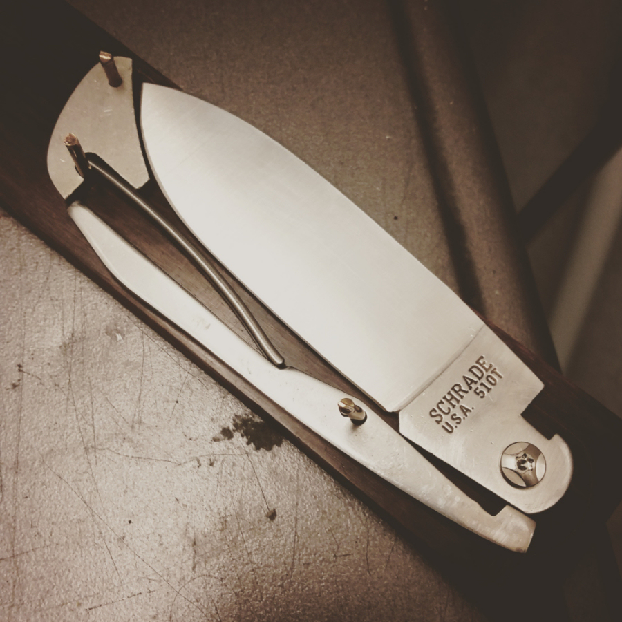

Step one was stripping it down to the bones, cleaning things up and putting it onto a layout jig, and enlarging the pivot hole from 1/8 to 3/16 to accommodate a beefier, modern pivot (temp pivot in the photo)

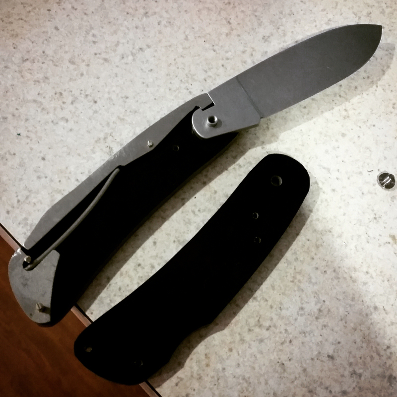

Step two was to get my new G10 slabs roughed out to shape and drilled to match

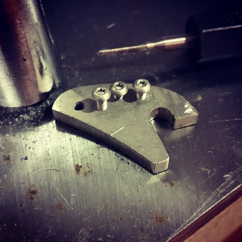

Step 3, I decided to utilize the stock spring holder and tap it for some 2-56 screws. The awesome folks at AKS have their own screws made to SERIOUS precision specifications, so these are made from Beta phase Titanium. They are literally strong enough that you will strip your bit driver before you twist a head off the screw

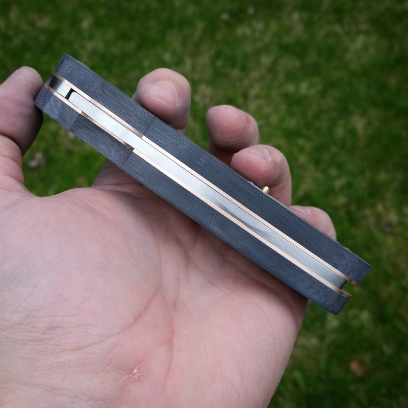

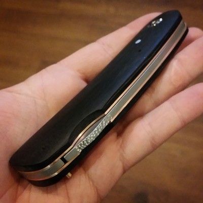

It was a few days while I waited for the rest of my parts to show up, but eventually I was able to glue, pin and shape my Phosphor bronze liners, and get the inside mirror polished (because why not). I'm pretty sure nobodies done PB liners before because it's not exactly what I would call cost effective, but at spring hardness, it's similar to Nickel Silver in toughness, but with better lubricity (which is why we use it for washers on folding knives, right?)
More test fitting:

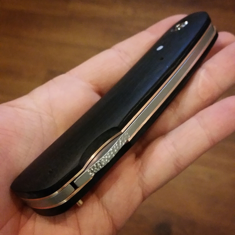

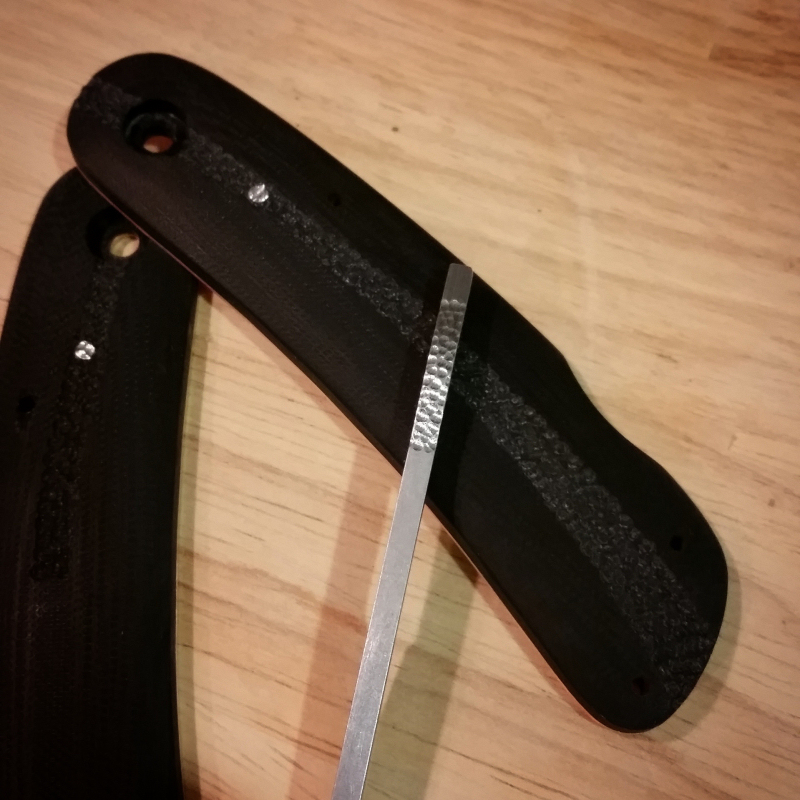

Once that was done, I added some texture to the "active" part of the lockbar, got the scales contoured, and finished up the general fitment of all the parts
Deciding I needed to add some additional grip, I mirrored the lockbar texture down the sides of the knife
Now all that was left was to bead blast everything, pin it all together, spot blast the pins and the AKS pivot hardware and call it a day

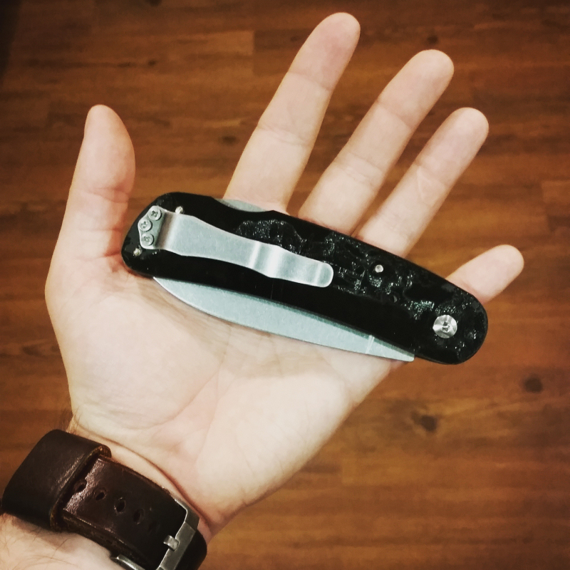

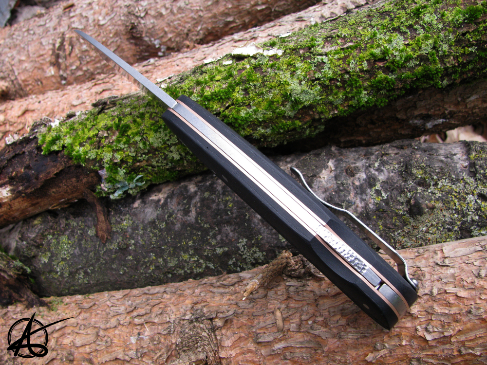

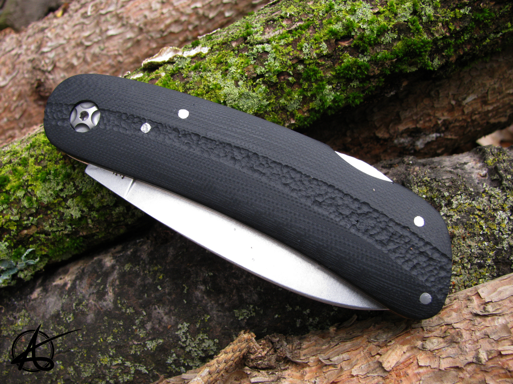

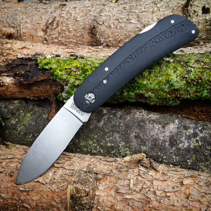

I checked my fit one last time, then peened everything together with some stainless steel pins. I flush finished the pin heads, then masked off and (like the handles) hit them with 80/100 ALOX media, then some glass beads to blend everything everything together. I cleaned everything up, wiped it all down with WD-40, sharpened up the blade (18 degrees per side, 3.5 micron stropped finish) until it will cut you if you look at it wrong, threw a coat of Renwax over it, stuck some Nano-oil into the pivot and attached the clip. Without further ado, here's the finished 51OT-S!
I'd like to think, if Schrade was still around, that this is the kind of "evolution" that would be feasible for some of the "traditional" patterns, to draw in the modern knife crowd and let them experience the benefits of a traditional knife. With this guy, maintenance is a breeze: the blade will drop free of the frame if you remove the pivot, the liners are mirrored and easily wiped down, the clip is removable and aside from the spring itself, the rest of the parts are all captive thanks to the pins. The whole package, clip and all, comes in a dozen or so grams lighter, and better balanced than the original 51, thanks to the omission of the bolsters.

Subbing washers for liners could have easily shaved off another couple ounces, but it was an artistic choice for me honestly more than a practical one. I like the copper and black look. Changing the spring holder to titanium could probably drop another ounce or two (titanium being 45% lighter than steel) The pivot, aside from the barrel itself, is Ti, and if I source a Ti clip, there's another few grams.
