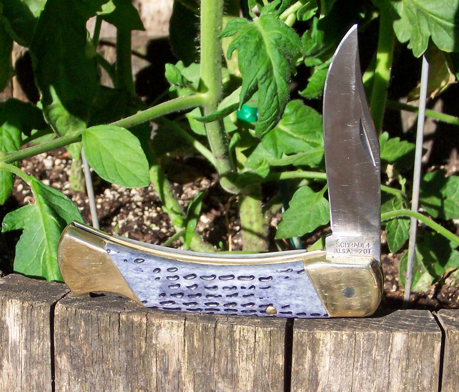

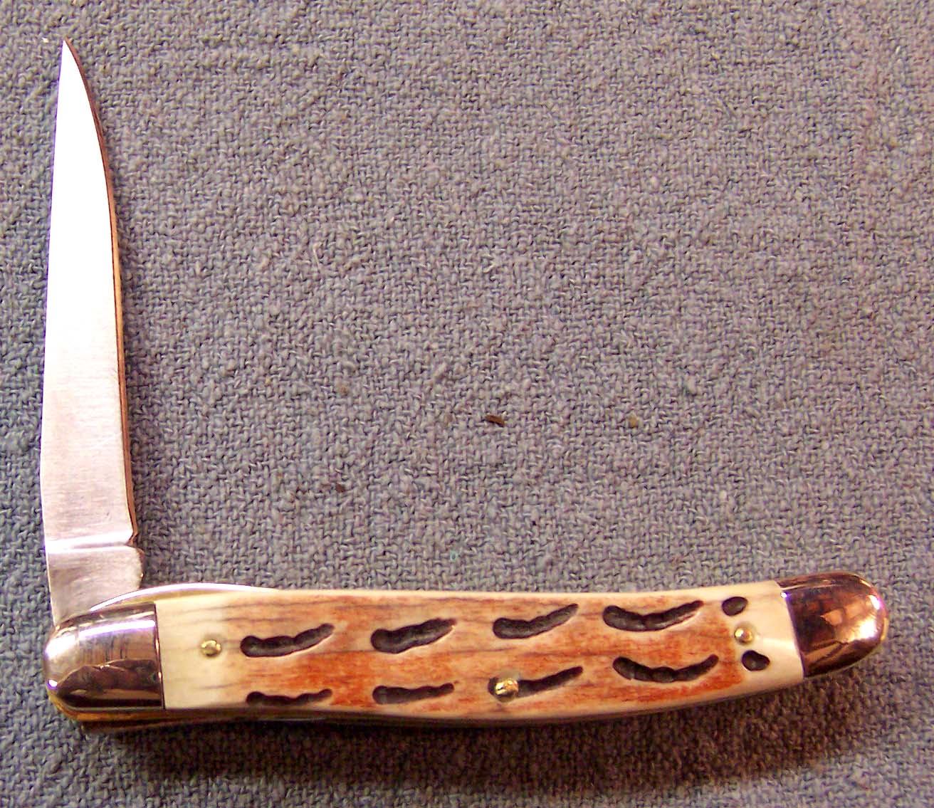

The second pic is a LB-7 my grandson re-handled with some bone I jigged & dyed when I did the other pieces. This was dyed only once with blue Rit dye. The main difference between the way the bone was dyed is that the blue was only dyed once, but it set for several months before my grandson used it. I was surprised at how far the dye had penetrated.
I don't know if it was because the bone set for several months & really dried out, or if the blue dye just penetrated better.
I think my next project will be to dye some bone using a small pressure cooker to see if that will get the dye in deeper.
