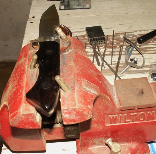

I'm sure most of you guys already have your workbench set up the way you want it, but there might be someone out there, who's struggling to hold an odd-shaped knife blade or handle, while working on it.
What I did was drill 1/4" holes in the tops of the jaws, angled slightly toward the jaw opening. Drill maybe 3/8 - 1/2" deep, whatever feels comfortable. Then, cut some 1/4" brass rod 'about' 1 1/2" long, and drop in the holes. Don't have to braze them or anything - you might want to remove them, occasionally.
This way the work is held on top of the jaws, not in them. If you should need to hold something in the jaws - just pull 'em out.
I've seen some pretty expensive contraptions on the market, specifically made to hold knives - and they probably work well. This one cost me about 15 minutes and 45 cents.

that is a good idea.

Thanks for the "thumbs up", guys. I didn't invent the trick, but seems that not a lotta makers use that setup, so you very seldom see it. It darn sure works, tho'.

Thanks again, fellers - Oh, Bob Engnath is the one that showed me the trick with the vise. (I'm bettin' he didn't invent it, either !)

Great tip JR, thanks!
