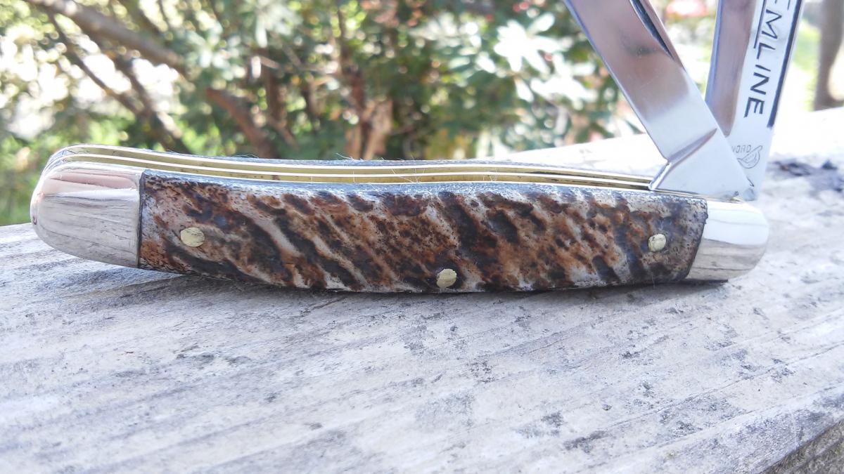

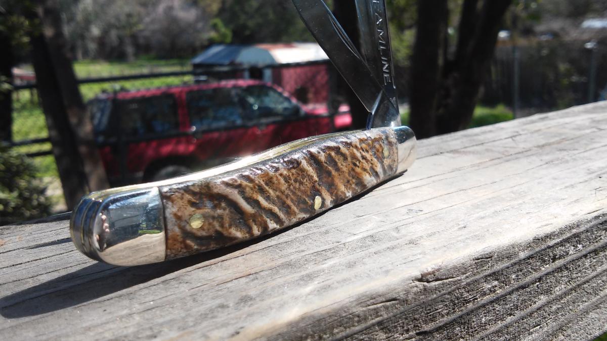

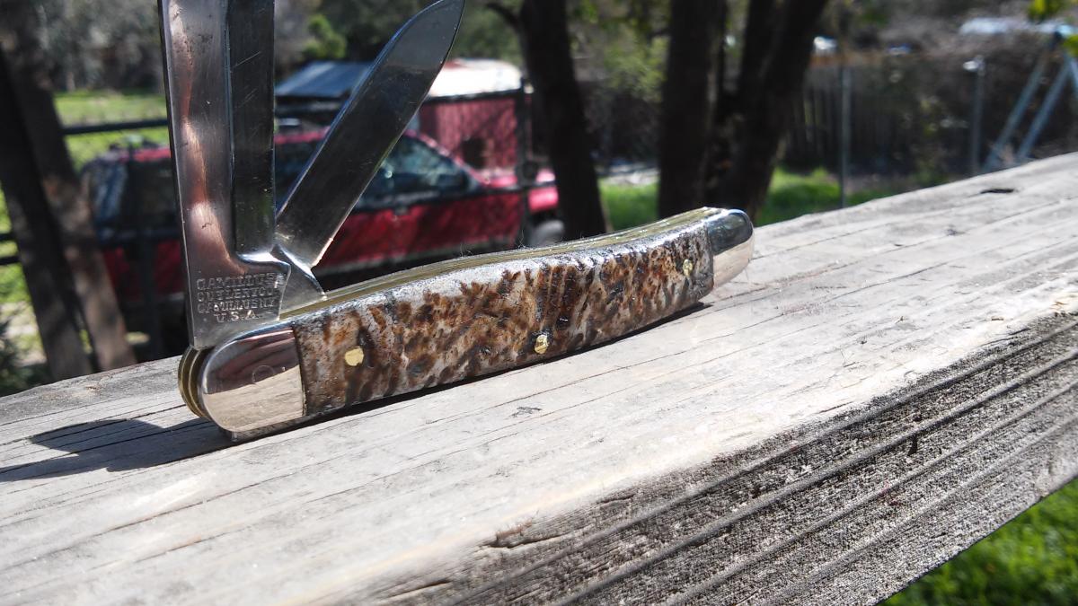

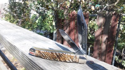

This one isn't quite finished but its far enough along that I have to share. Its a four line Camillus 2 bladed jack.The celluloid scales were just starting to show signs of out gassing. So I popped the scales and replaced them with moose antler. This is the second knife I have done in this material. I really like it!
I have enough moose antler left for about 3 more smallish slip joints. So far I like the ease of working with moose. when cutting it, the antler is fairly thin and sorta flat. I have cut them to shape and then split the piece using both halves. Depending on what a person wants, you could just use one half. The part of the antler facing forward on a moose has a different color and texture than the back. One could cut the antler to match textures. Or, use both sides like I did.

Wow Randy, that's really nice!! At first glance, I thought the handle was exterior Ram's Horn, but the color didn't seem quite right so I knew it was something else. Very nice job. I like it.

Thanks Mike! You know I got the same impression. My first thought was , "Wow its got that rams horn look to it". The lock back that I did in moose also gave me the same impression.

Randy is your nickname Boris and your wife's Natasha??? Poor moose an't pullin' any more rabbits from the hat!
Great handle job, super looking knife!

Hey, that's a dandy!

wow that's nice, almost looks like some killer rams horn at first glance. love that texture

Nice job on one of my favorite knife patterns!
I have a couple waiting on the shelf for me to get to them.
