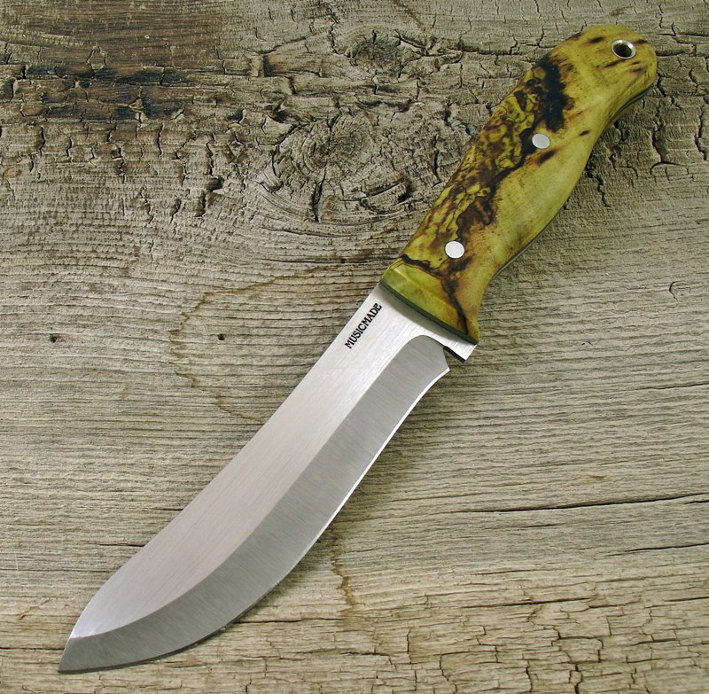

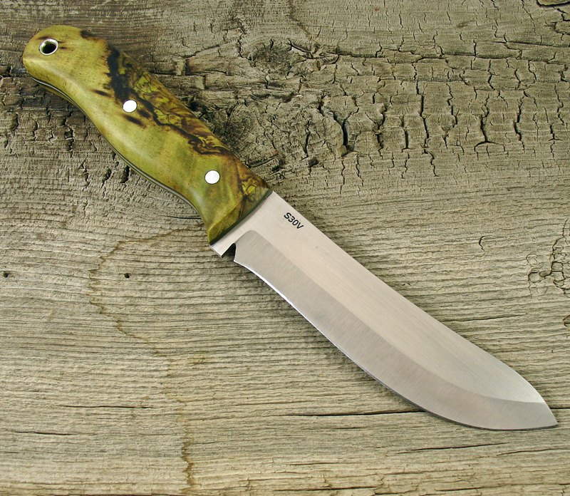

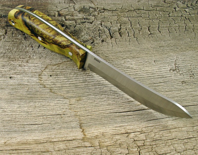

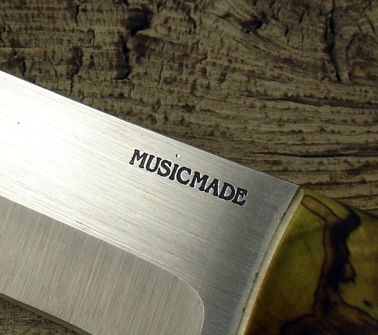

Here's my latest one, it's a spin off of the Green River Camp knife.
Sandi ground S30V stainless steel, stabilized Buckeye burl scales, linseed oil finish, green G-10 spacers, Corby bolts and NS lanyard tube. It's 9 1/2" overall with a 4 1/2" blade.

You sure are making some ""BEAUTIES"" Gary !!_________ you have quite a talent

WOW! That is gorgeous!

Nice skinner, must be an odd perspective, the blade looks longer than the handle, to my eyes....

Oh man that's a sweet looking knife !

Boy Gary...with the last 2, you are taking us guys on a trip back to the 1800's
I really like it, what a skinner and camp knife that will make, Gorgeous !!!
Remember that old Mtn man saying: stick em up to the Green River
meaning where Green River was stamped on the knife

All of the above!!! Very nice Gary!!! John

Thanks you guys, I appreciate the feedback for sure. I never know if I'm going in the right direction so your comments and
really help.
Steel, you made me get the tape measure out again, it's 4 1/2" on each end! And to think I built all of the cabinets for our house!
Will, I looked and looked for that piece on Bowie's........never found it. I'll stumble on it one day.
It came out at 61rc.
