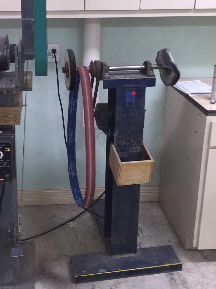

I put this buffer together about 20 years ago using 8" H beam and 8" channel iron. Belt drive with a 1" SS shaft on pillow block Fafnir bearings. I burnt up the first used motor and replaced it with a 1 HP Baldor motor about 10 years ago. It is the most used piece of equipment in my shop. The whole initial project cost me less than $100 with some machining help from a friend. If you have access to a used steel yard, welding and some machining you can do something similar at far less money than a ready made machine would cost.
This buffer 10" is heavy, powerfull and runs very quiet and smooth. I use a 10" loose muslin wheel and a 10" sewn muslin wheel on it. I would put it up against any ready made buffer out there.

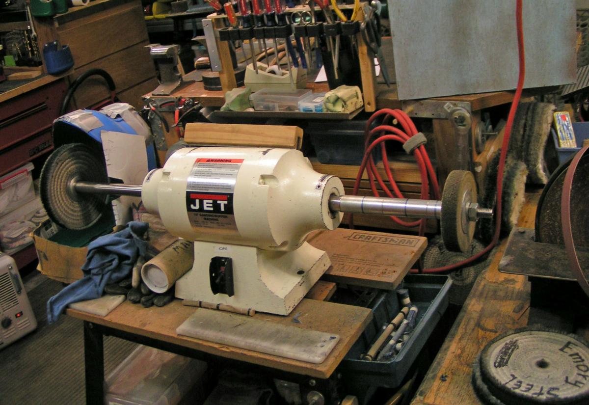

This is my 1 hp Jet buffer. I have a couple home made buffers as well.

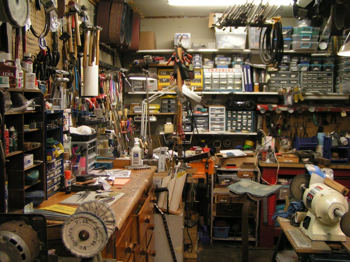

Here is one of my home made buffers in the bottom left of this picture.
It is powered by an old washing machine motor.

The Jet is single speed 1740 RPM. I don't think Jet makes the buffer anymore. It was about $200 if I recall correctly. It is not as smooth as a Baldor but is less than half what a 1 hp Baldor knife buffer costs. They replaced it under warranty several times until I discovered the problem was the switch. I replaced the switch and it works super.Jethro Bodine wrote:Thanks Dale!I value your input. What speeds are your jet?

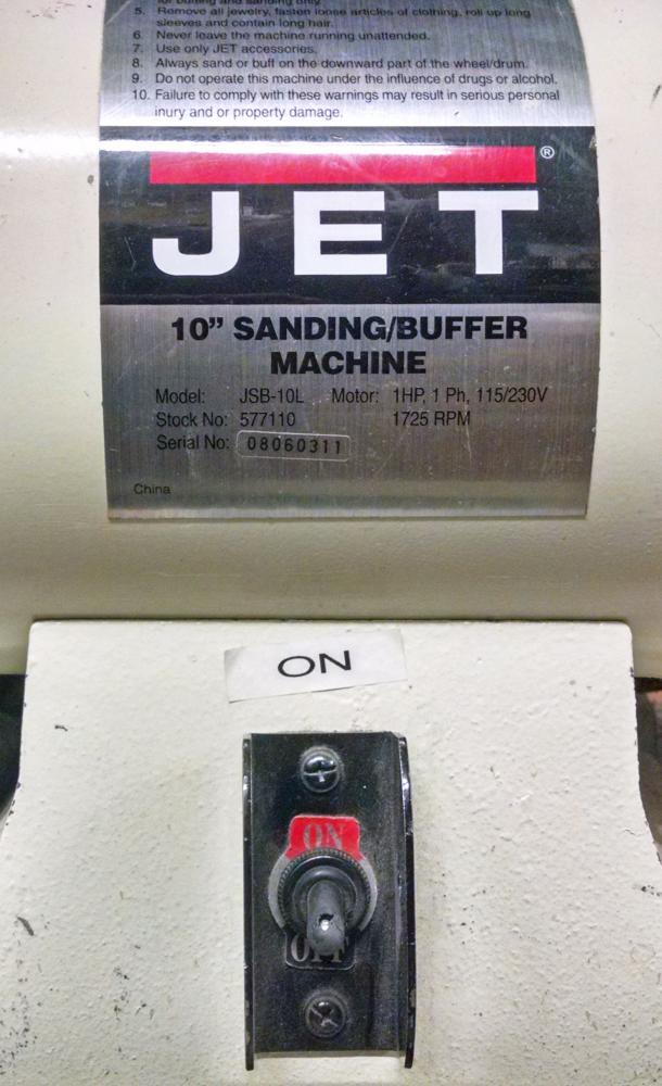

Correction, the speed is 1725 RPM not 1740 RPM.
The tags on most motors will show the serial and model numbers of the motor, HP rating, rotation speed, voltage required and whether the power requirement is single phase or 3 phase.
The motor tags, whether they are metal tags or decals like the one on my Jet buffer gives you most of the essential info on an electric motor. Things like voltage are critical. I am running the buffer on 115 volts rather than 230 volts because of the location, but if I ever get another shop or rewire this one I will convert the buffer to 230 volts. It's cheaper to run that way and I understand it is easier on the motor, though I am no expert on electric motors.
Yes, 1 HP. Mine says 1 HP on the motor tag.garyflorida wrote: JET doesn't list the hp rating. Do you know what it is Dale?
