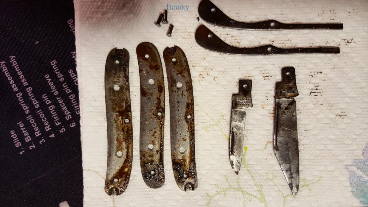

I found this poor Imperial laying in the road a few years ago. I picked it up and put it in my tool shed and forgot about it. Since subscribing to another knife aficionado site I have a new found interest in my knives.
Anyway, this poor guy is in pretty rough shape and I am hoping to hear from others on the best way I can restore it. I am currently soaking the knife in some 3 in 1 oil to help loosen some of the rust and get it as cleaned up as much as possible. I am thinking of taking it completely apart and removing all of the rust. This could turn into a nice first project. I realize this knife is inexpensive so I am not concerned if it becomes a loss. What I would like to know is if my technique is correct. I am providing some pictures of my progress and will accept any constructive criticism.
Full album progress pictures are located here: http://imgur.com/a/zbYkP
Can anyone tell me what the three sets of numbers mean on the small blade? I have found pictures of this knife while researching it but can't find much info on what the numbers mean. I would really like to know if anyone can describe for me how to remove the rivets without destroying them?

The numbers are patent numbers.

That's a shell handle knife and you've done a good job of getting it apart w/o breaking those tabs. They usually snap right off. I doubt you can get it apart any further w/o cutting the pins (rivets) Dale has an excellent tutorial on taking a knife apart in the tutorial section. Keep posting the pics.

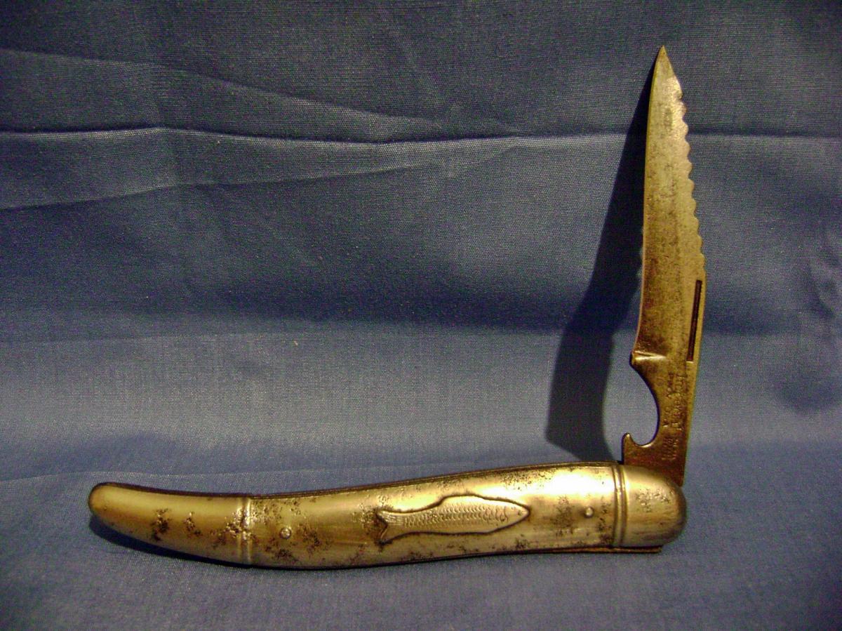

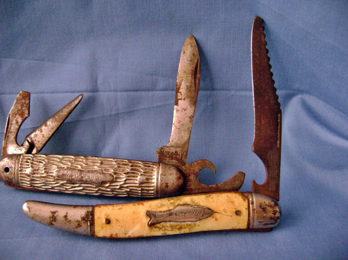

The Kamp King I may or may not still have. Received it and the Imperial Fish knife in a POS roundtable. This is how they looked when I first got them.
Cleaned the Imperial up a little, sharpened it and carried it for a while. It changed my opinion on shell knives from a major negative to positive.

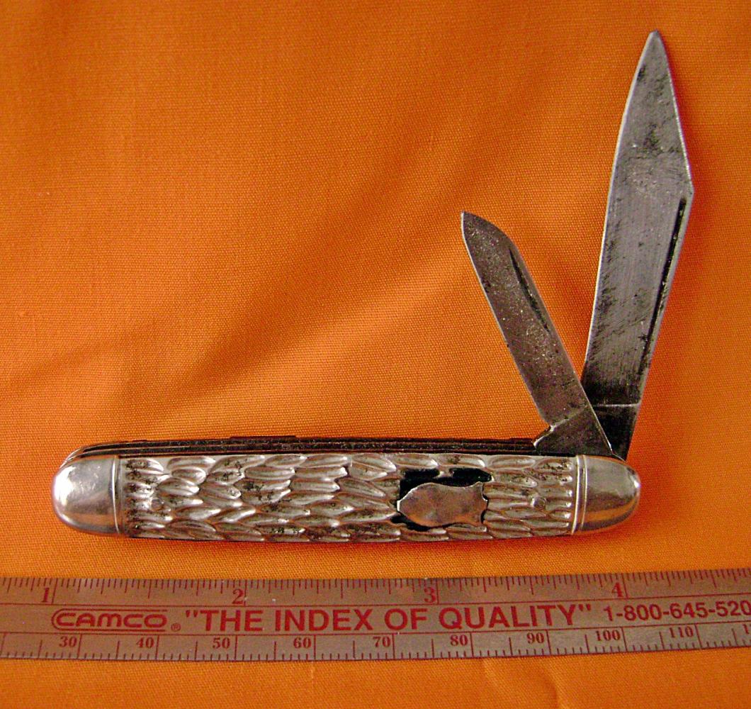

Received this Imperial medium jack in a different POS roundtable. Most of the wrap was already off it so I finished removing the wrap (since this picture was taken), sharpened it and carried it for a while. I look a bit more favorably on it now.

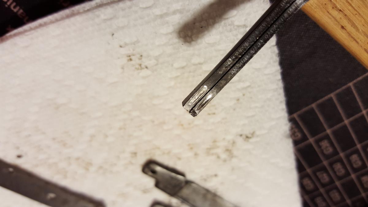

Took it apart last night. I wasn't able to save the pins. Is it normal for the pins to be different sizes? The end pins were .08 and .082 and the center pin was .087.
- orvet
- Posts: 19906
Re: First Restore
That's normal Chief. The .002 difference on the end pins is probably due to the the crimping process. They were probably the same size. The rocker pin (center pin) is often a different size. That rocker pin takes the stress from the springs.
